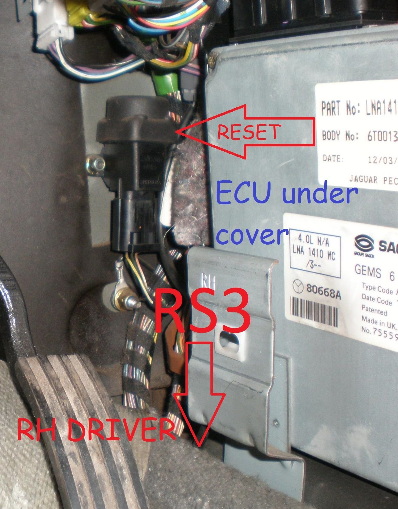

Inertia / Crash Switch Reset ?
Old Jan 8, 2026 | 01:34 PM
Parker 7's Avatar
Joined: Aug 2021
Posts: 4,670
Likes: 1,323
From: Kansas City
This is someone's pic of a right hand drive , the switch will always be on the cars right side
The switch is fickle and trips easily and does not always reset , remove connector and place paper clip between the 2 white wires

Hadn't heard about this, trying now!

Jumped it, replaced switch, attempted, still failed to start. At a loss ;-[
