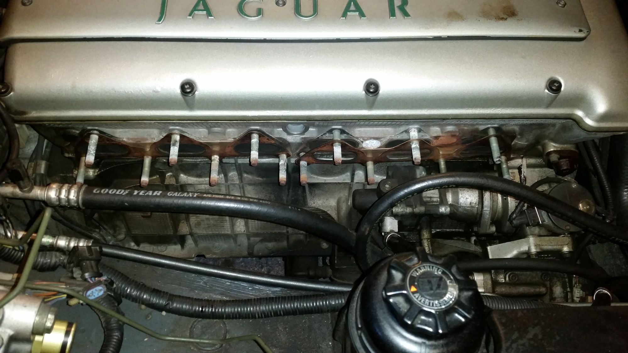

The rattle is making me go crazy. The metal shield surrounding the exhaust before the cat is lose. It's thin and in poor condition. It has been welded tight sometime before it seems but now there is no way to tighten it. Can I cut and remove it? Any real danger in removing this?

It had to come off.. it Was in a horrible condition with lots of rust. The metal was smuldering away .
The question now I guess is if the heat will damage wiring to O2 sensors or other things. I will probably buy a brand new complete exhaust system sometime soon though. . I guess it's time..

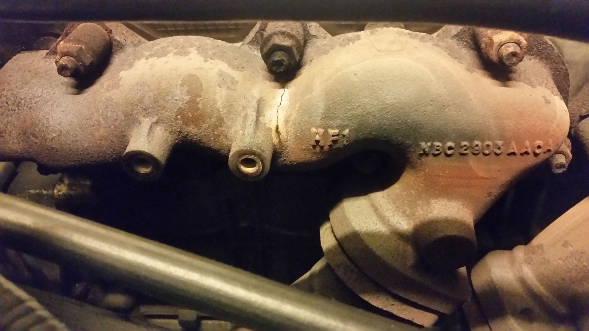

I also discovered I have the notorious crack in the rear manifold 🙁. . I guess I will have to find someone to weld it .

From what I understand inside the Cat is just a ceramic substrate carrier for the platinum alloy unless there is a metal cage on the back to hold it in place . If you can locate something on the outside stuffing the area of interest with some brass ( not steel ) wool may be a temporary fix . On the cracked exhaust manifold unless the unit is in a oven and heated way up then bolted to a flat table before welding it may crack again . With this in mind I mapped out a repair for my cracked one with cut and rethreaded 90 degree bicycle spokes with a patch underneath it before I try welding it . If it doesn't work I can remove it . You don't have to remove the manifold to do the repair . My crack is only 1/3 of the total circumference . My crack is between the 2-3 cylinder . Should fit under the manifold shield . I have not completed the repair but these are pics .

Common problem with the exhaust manifolds. See AL NZ's recent posts, and welcome to the "Club In-Search-Of-Exhaust-Manifolds"!
Your downpipes with the front cats are breaking up and were overdue for replacement. The heat shield is bolted onto the exhaust manifolds so if your exhaust manifolds are cracked or loosened up, the heat shield will become loose as well and lose its primary role of heat deflection. Your rubber hoses nearby will be toasted in no time. Looks like you will need a full exhaust system from exhaust manifolds onwards. David Manners has a good priced set of full system from downpipes to tailbox, but you will need to tackle the exhaust manifolds first. OEMs are nowhere to be found.

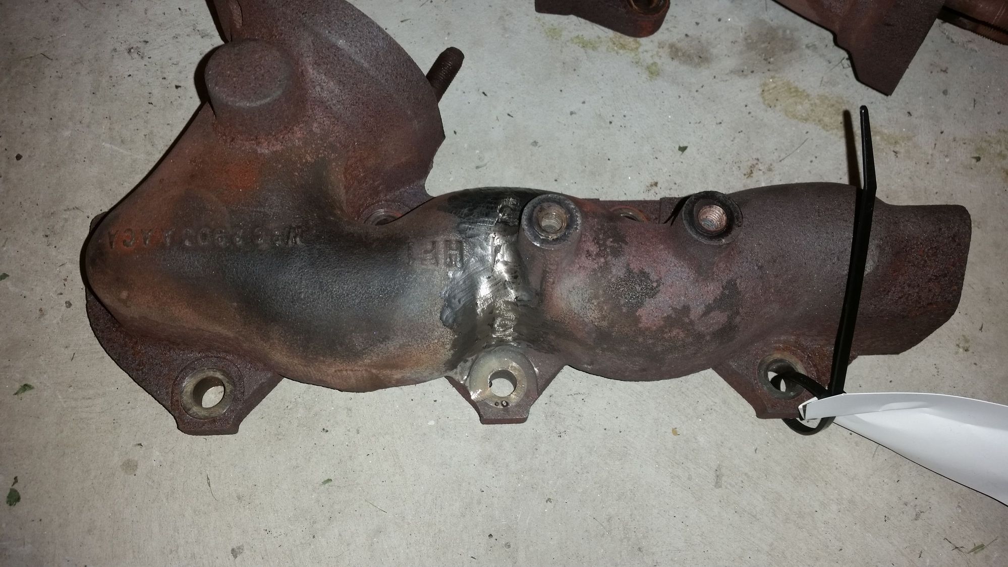

I found a local metal shop that had experience in welding cast iron and they sorted it out today in about 1 hour.
Very pleased and eager to have it installed again.

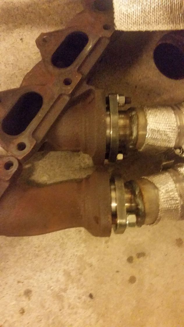

I noticed however when removing the downpipe that there was a gap between the front manifold and the downpipe. No wonder it's been running a bit rich. A new exhaust will do this car good.

Got the downpipe and catalyst from David manners and they look good, but there is a rather big gap between manifold and downpipe. Can't seem to tighten it any further.
Is it supposed to look like this?

Donut gasket atop the downpipe flair ? Common available item . It would cover the shinny area in pic just bellow the manifold bottom . It is 1.965 inches or 50 mm inside diameter . Verified for mine is off . The straight portion of the downpipe goes up into and loose in the manifold if the gasket is missing .
Tcasmarcus Jul 27, 2017 01:03 PM
They're on yes. .. used the old ones though but they looked Ok.
Lady Penelope Jul 27, 2017 01:36 PM
Recommend use new ones for you don't want to remove and replace a second time . A leak throws off fuel mixture to run rich . This will cloud the O2 sensors . Then you will be 2 variables behind the curve on engine regulation . Ensure that you don't deform the flair on the downpipe that the gasket seats into . If the gaskets were already on in the pic and reset into the manifold grove the straight portion of the downpipe as new manufacture may be too long . Not hard to correct yourself before shipping back . Any questions , just ask . I found that I had to cut the web ( yours may not have it ) between the forward and aft downpipes in order to freely float ( pun intended ) into position and not have the studs damage the flair . Can be welded back later but it is my opinion that the web is there to prevent shipping damage that would hamper total car manufacture process on the factory line if it was bent out of shape .
