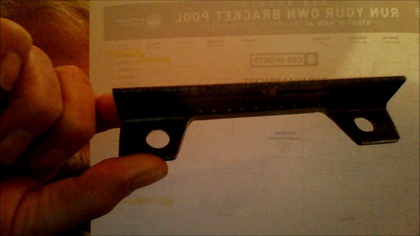

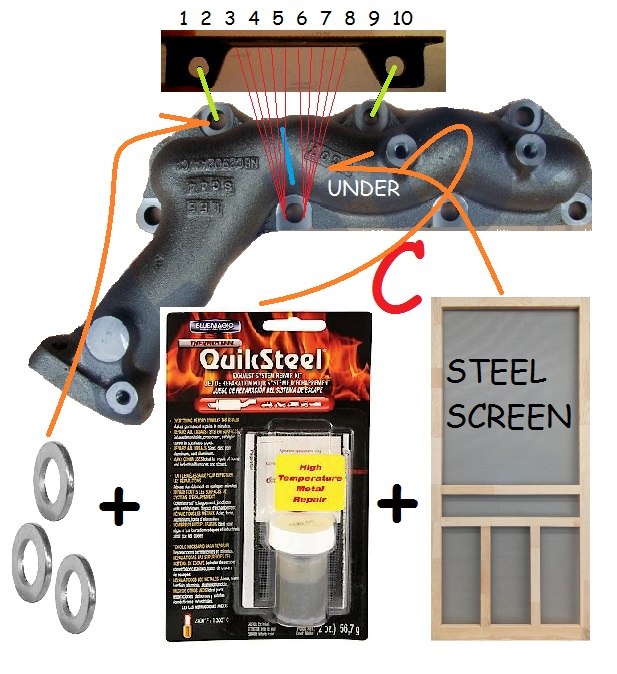

From what I understand inside the Cat is just a ceramic substrate carrier for the platinum alloy unless there is a metal cage on the back to hold it in place . If you can locate something on the outside stuffing the area of interest with some brass ( not steel ) wool may be a temporary fix . On the cracked exhaust manifold unless the unit is in a oven and heated way up then bolted to a flat table before welding it may crack again . With this in mind I mapped out a repair for my cracked one with cut and rethreaded 90 degree bicycle spokes with a patch underneath it before I try welding it . If it doesn't work I can remove it . You don't have to remove the manifold to do the repair . My crack is only 1/3 of the total circumference . My crack is between the 2-3 cylinder . Should fit under the manifold shield . I have not completed the repair but these are pics .
