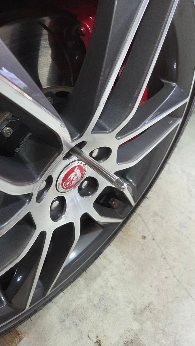

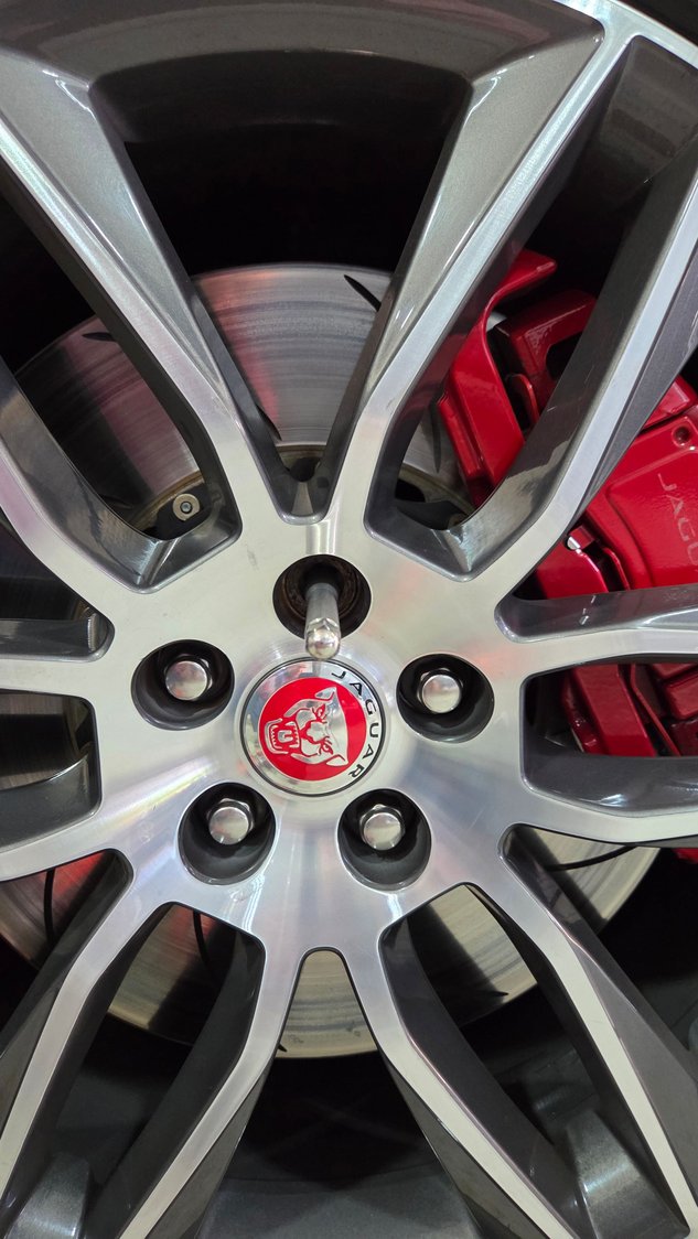

If you are like me and your back doesn't particularly like the effort required to remove and reinstall the wheels on our F-Types, you might want to consider purchasing this -
Amazon Amazon
. This simple piece of stainless steel threads over the wheel stud and allows much easier wheel removal and installation. Simply rotate the wheel so one lugnut is directly at the top, remove that lug nut, and install this extension. Now remove the other four lug nuts, and the wheel can slide off a few inches while supported by the extension, making it easier to remove without interference with brake backing plates, calipers, etc. When reinstalling the wheel, you only need to line the wheel up with the extension, then push it into place. Much easier than trying to line up 5 wheel studs while also supporting the wheel and tire assembly. The M12x1.5F is the correct version for our F-Type wheel studs.

I agree & having been using them for years. In my case I put 2 on the hub to make the wheel slide right off & on.

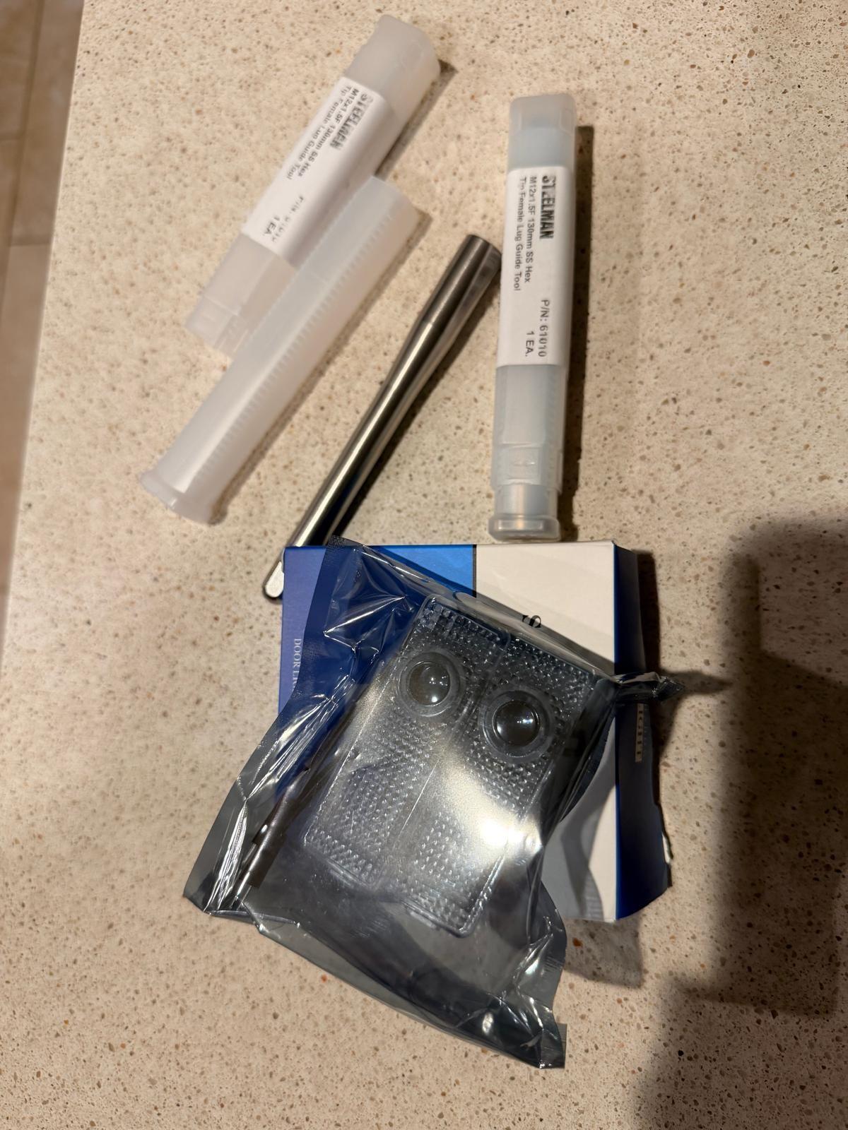

Went looking for one/some here in Oz as the Amazon US price plus postage was a bit steep, turned out to be very hard to find as 99.9% of all listing are for male versions (eg for various German makes with wheel bolts rather than nuts on studs) despite putting "female" in the search.
Eventually found a pair from an Oz auto parts store I had never heard of before (Australian Online Car Parts) for $53.28AU so bought them.

I've just ordered a pair not so much to reduce effort but to reduce chance of damage to the inside of the rims. Missing the hub and setting the rim down onto the caliper can scratch or gouge the rim.

If you want the genuine Jaguar article, it's p/n T2R9918 - I just got two from Britcar.

I got two after getting my car. I have these for other cars and they are amazing at not having to fight the weight of the wheel when removing or installing... Highly recommend getting two instead of just one. Easier to align and mount/remove the wheel than having just one.

Each, you have to buy two. Or go for the one pin suggestion above.

I think this is the best plan. I like how the Jag ones are completely smooth, so less opportunity for grinding of any kind in the heat of the moment ;-)
