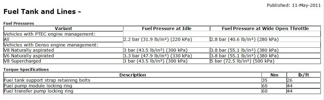

Begin with the basics. Use a voltmeter to determine the available voltage with the ignition in the OFF position for at least thirty minutes. Connect the voltmeter to the battery terminals; there should be a minimum of 12.6 volts indicated on the voltmeter. If not, charge the battery for five hours at 2 to 5 amps and retest. If there is still less than 12.6 volts showing on the voltmeter, the battery is suspect and should be replaced.
If the available voltage is correct, use a smart phone with the Torque app to connect to the ECM/PCM via the OBD port using a Bluetooth interface. Check to see what the fuel pressure is at start up. It should be around 300 kPa. If not, the fuel pump may be failing.

If the fuel pump isn't generating enough pressure during cold start up, it can cause the engine to run rough like in your video.
