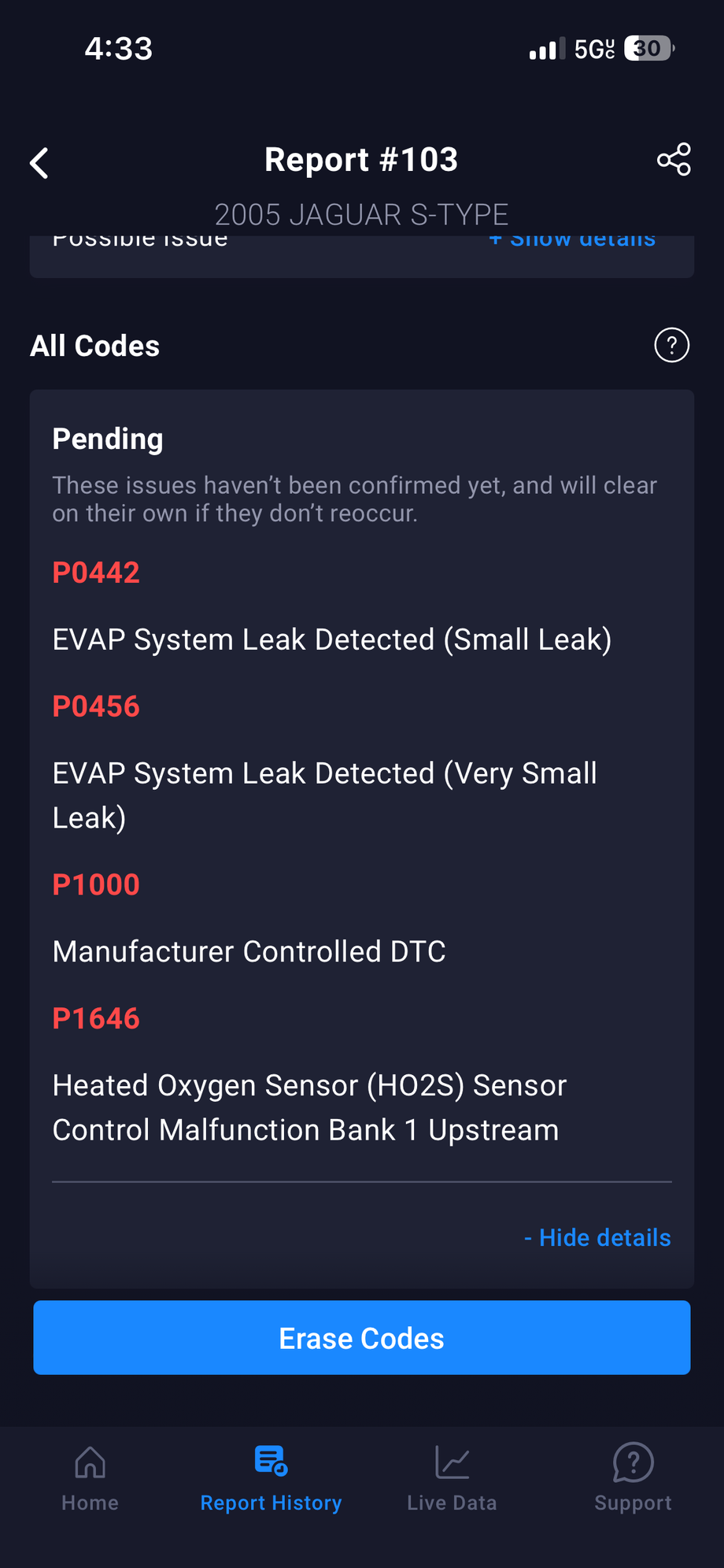

Just got home and reran the scan, got 3 codes. I obviously have a small leak, but is that really enough to make a car not start?
Nope, none of those codes are going to cause starting problems. No need to panic about them just yet.
The only one of interest for right now is P1000. That simply means the various self-test monitors have not been completed. Typically several drive cycles are required since the last time the codes were cleared. Once that happens, the code changes to P1111. You will always have one or the other (but never both) at any given time.
Some fault codes are inhibited until the monitors are complete. So for now, simply record any codes you might find but do NOT clear them. The car is fully driveable, right? Take it out on the freeway and give it a good (insert name of ethnic group) tune up. In other words, work the engine hard and blow out the cobwebs, so to speak. With any luck, this will help complete the monitors and maybe provide some helpful codes. The only caveat is if the check engine light starts flashing. That means the catalytic converters may be getting damaged, so throttle back.

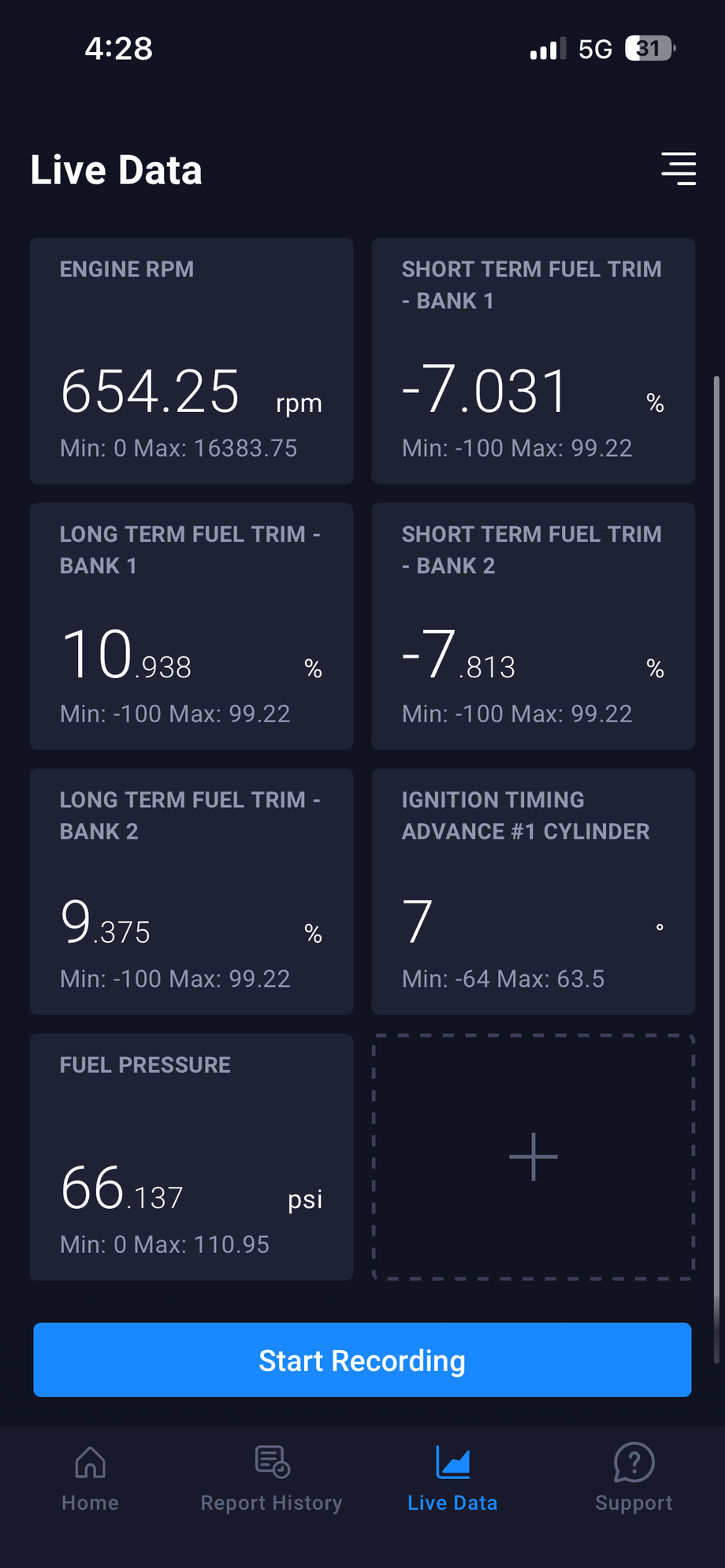

Not sure if this picture helps but this was at idle also this was right after I got it, the fuel pressure is a little higher but idk what the difference is. I have no clue what most of these mean lol.

I have the live fuel data from when I was driving, I just have no clue how to send it to you..
You just did. Don't need graphs and charts. Just a basic number at idle.
Originally Posted by Collin’s Stype
but the idle fuel pressure was about 55-60 psi the whole time. When I had the ignition in the “ON” position, fuel pressure was 46 psi.
​​​​​​​Okay, 55-60 might be high at idle. Look at the chart in post #2 above. It says you should have about 43.5 at idle. I'd have to do a little research tomorrow to confirm this. Anybody else with a N/A V8 that can verify this value on the scanner? IIRC, the value reported to the computer is not raw data, but is compensated for engine vacuum.
