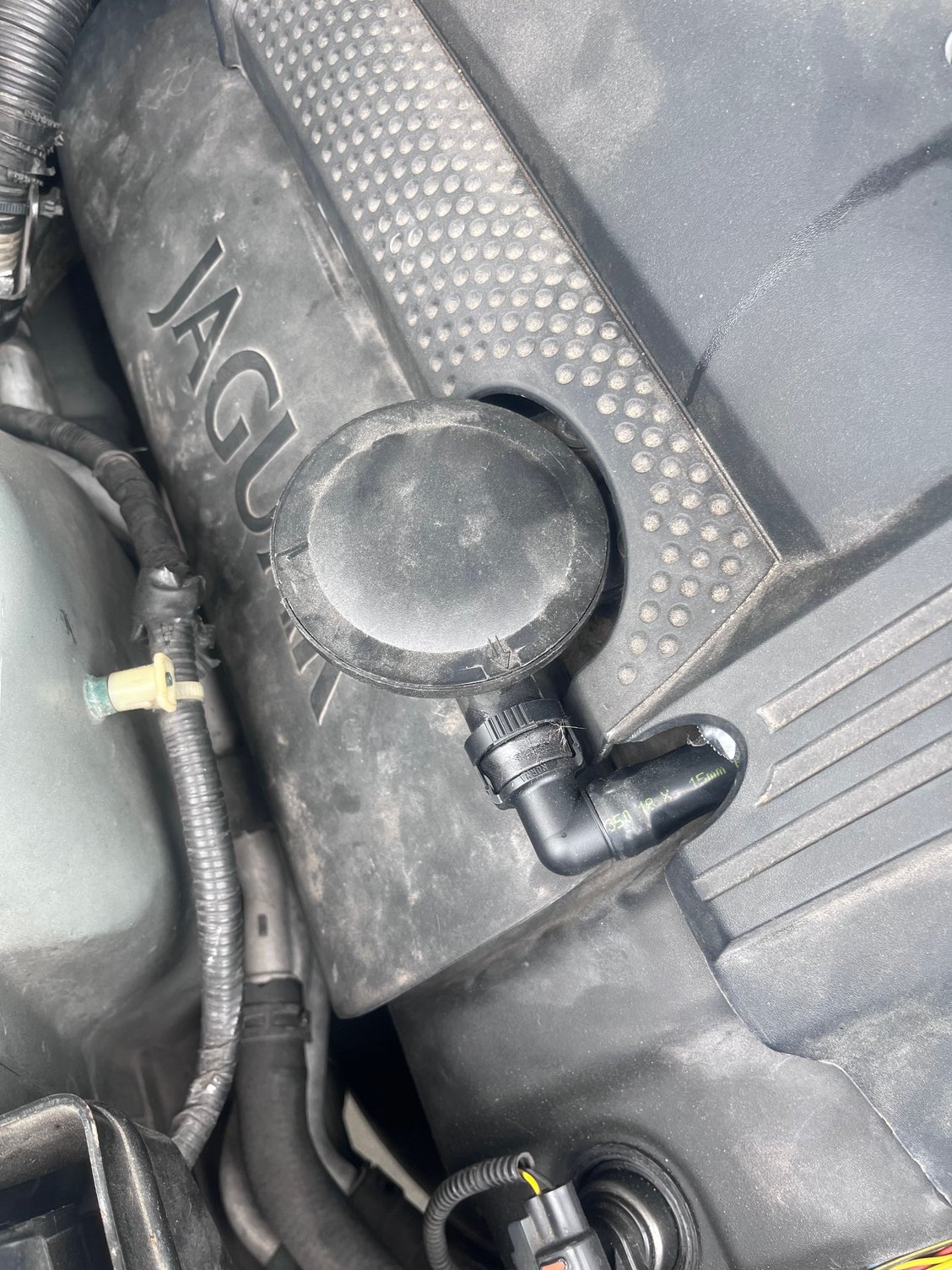

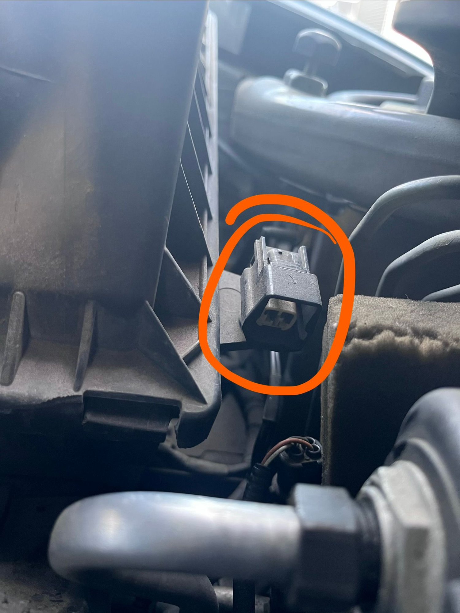

Probably nothing but is something supposed to go here? Side of air intake box.

This thing is making a pretty loud squealing noise too. Sounds like air being sucked in or out
the plug is for a supercharged car going to the extra air flap i believe. The ufo thing is part of the pcv system. It is unusual because it is not a one way valve as most are. It is a diaphram that regulates vacuum flow into the throttle body as it scaveges blowby gases. It is sealed to the cover with two o rings. The hose is sealed to the valve with an o ring. It is very possible the valve was removed to change the coil. If it is original those o rings would be hard. Now possibly broken. Check that out because if bad it would cause your new codes. They can whistle. I replaced mine on my 06 str and it quieted down a lot. Search the forum for 4.2 liter pcv valve. A smoke test would reveal a lot. There are a few plastic lines related to vacuum and all are brittle by now and even just a hard nudge can crack them. Check all connections to the main air intake from air cleaner and the connecting hose from cleaner to throttle body removed from engine for any damage
