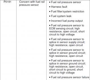

Thanks Avos but the JTIS lists the following for code 0191:
No mention of idle at all?
Do you have any additional information for code 0191?
As I posted filter was changed several days ago.

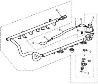

Looks like I found the problem. Followed the JTIS electrical checks and the sensor or transducer (It's listed by different names) has low resistance on one set of pins.
Just to let everyone know how to check the Fuel Rail Pressure Transducer. It's on the back drivers side on top of the engine. Bolts onto the fuel rail with a vacuum connection and a electrical connection attached. It's a 3 pin electrical sensor. The pin closest to the firewall is pin 1. They are all in straight line.
1. Between pin 1 and pin 2 it should read 10,000-12,000 ohms
2. Between pin 1 and pin 3 it should read 22,000-32,000 ohms
3. Between pin 2 and pin 3 it should read 22,000-32,000 ohms
Mine reads 1295 ohms on 1 and 2. Reads 45,000 ohms on 2 and 3.
It is item 4 below on the Supercharged/NA 4.2L engine. It looks like the 6 cylinder and 4.0 L engines use a similar but different part number. You can see the Schrader valve over by item 6 but it's not labeled.
I still was not sure it was the sensor but finally came up with an idea. I unhooked the sensor and let the plug hang. Then drove around again with the fuel pressure tester on the windshield. Much different! The pressure stayed around 45-65 psi with some variance as the RPM's changed. Never went to 90-100 psi and never dropped below about 45 psi.Car drove with pretty much full power again. Of course a constant check engine light but I expected that.
Called an ordered the part from what I thought was Nalley Jaguar. #AJ87977 List $190. I got it for $103 with shipping. Nalley has been sold (Don't remember what they are called now?) and the new owners do honor our parts deal of 15% discount and free shipping if the total is over $25. Call 1-800-328-4833 and talk to the parts manager Jeff Durham.
Maybe a moderator can update our vendor information? With the cost of Jaguar parts and the fact you can't get anything aftermarket it's a real savings to use them!
