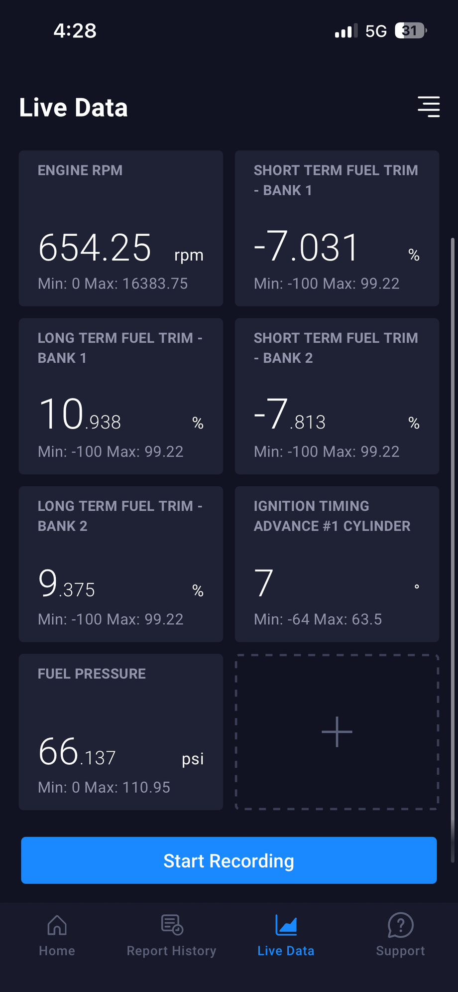

There’s a lot to respond to so I’ll start with what I remember, my scanner doesn’t show open and closed loop, I know for a fact the previous owner put 87 in it (😭😭&#128557 but I have only ever put 93 in it. Also about the injector test, I maybe will be able to try it tommorow but I’ll let you guys know. Also the fuel pressure doesn’t drop below 45 when driving at 70 mph. (Around 1900 rpm) so it might be getting too much fuel? It does also smell like fuel from outside the car but I’m not sure what that means. It is also burning oil whenever I “really drive it.” Not sure if that helps on figuring out the root cause but thought I would throw that out there.

I don’t think my obd tool shows ol or cl, atleast not any live data that says that, but I sent a picture of the fuel trims earlier. I also thought it would be worth noting that this thing in the engine bay was making a pretty loud clicking noise? First time I have noticed it but it was pretty distinctive enough to were I could feel the whole thing vibrating. (Look at picture, no idea what this is, ChatGPT says Evap purge valve)

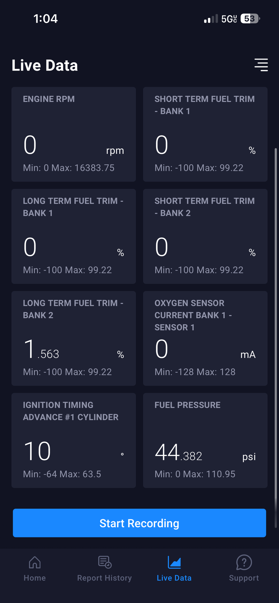

Okay, 55-60 might be high at idle. Look at the chart in post #2 above. It says you should have about 43.5 at idle. I'd have to do a little research tomorrow to confirm this. Anybody else with a N/A V8 that can verify this value on the scanner? IIRC, the value reported to the computer is not raw data, but is compensated for engine vacuum.
alright, I was wrong about when the ignition was in “ON” position. It said 58 psi, which I understand is probably a significant amount more than it should be? Also the key had been in on position for about a minute because the scanner takes a hot minute to connect and then identify vehicle and then load live data…

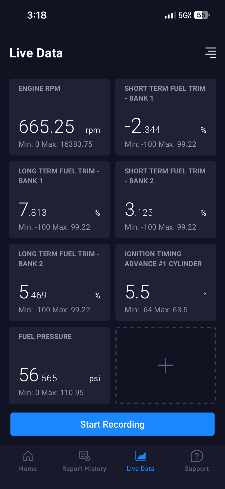

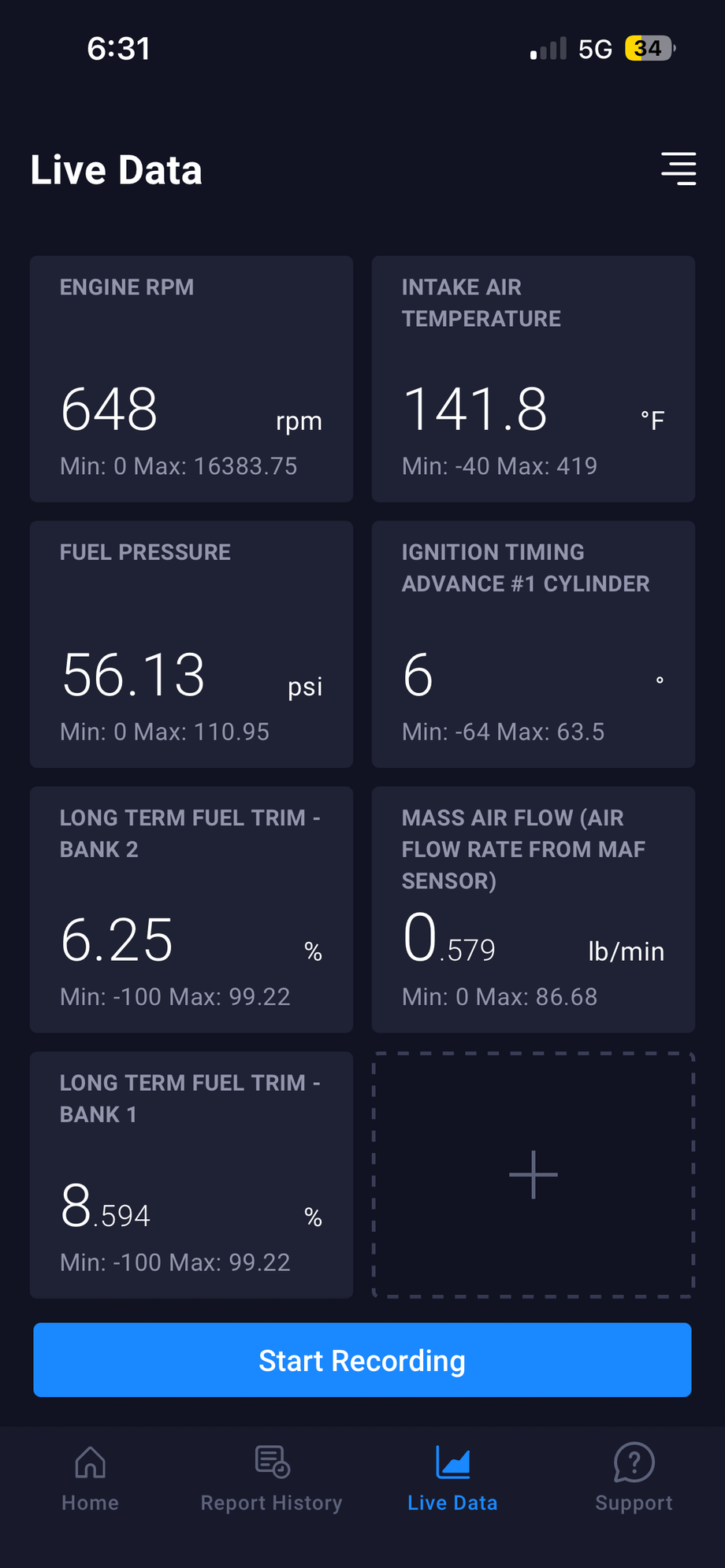

I’ll look again later. Also yes those trims were when fully warmed up (attached are 3 other days whe the car was fully warmed up.)

I'm puzzled at the variation in fuel pressure.

Me too. Did a little more digging. The expected value isn't always going to be crystal clear. That chart in post #2 above? I believe that is the value you should see with a mechanical pressure gauge. The value reported back to the computer? That doesn't always match the actual pressure, as it is offset by manifold pressure. However, if I understand the control logic, the computer always sees around 55PSI with the engine running. At idle, with high manifold vacuum, you'll actually have around 40PSI at the injectors but this is reported as 55 to the computer. More long-winded details in this thread:
https://www.jaguarforums.com/forum/s...estion-261975/
Normally I'd suggest hooking up a mechanical test gauge to verify the accuracy of the sensor, but IIRC the test port has been deleted on 2003+ models.
So from what I gather, under low power settings, the actual pressure at the injectors will be less than what is reported to the computer. This is all fine and dandy, by design. The computer is happily regulating the pump output to the 55PSI feedback, even if that isn't entirely accurate. Now if you had a tired pump or a clogged filter, you might actually see feedback LESS than that, as the pump would be commanded to run full bore to keep up pressure but can't do it.
However, for the life of me, I can't picture a scenario where the feedback is substantially MORE than 55PSI. If the feedback is too high, the computer will command the pump to slow down to get back in range. Yet you had 66PSI in one screenshot, which is 20% too high. No idea how you got that, unless it was a brief excursion that you just happened to catch. Call me confused.
The only thing I can think of for this situation is a faulty fuel pressure sensor. Maybe it has a bad spot a little bit above or below 55PSI. Most of the time it can happily report 55PSI, but when it hits that bad spot it sends 66PSI. Heck if I know, just thinking out loud.
