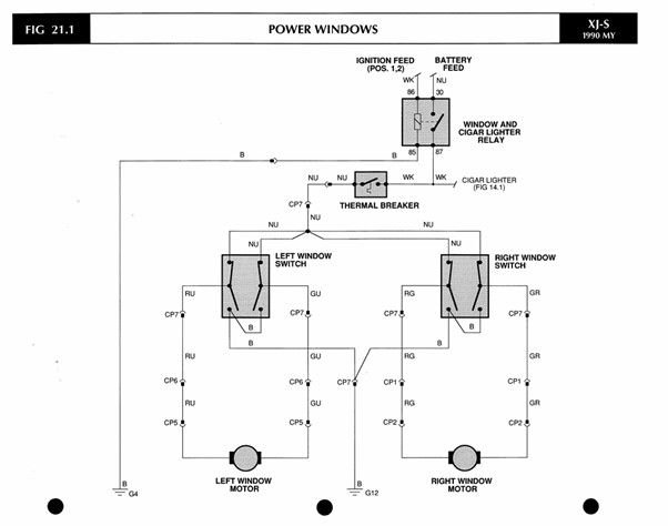

If the exact same switch you used successfully in the driver's side produces the fault in the passenger side, then it is a wiring fault. Nothing for it but to get the wiring diagram and do some continuity testing. I can post a diagram if you need it.
Thanks Greg - a diagram would be helpful. Mine is a pre-facelift model.
Attached.

Thanks for the electrical diagram - they suggest a few checks. It does seem to be a wiring issue because switching the right side switch to the left side causes the thermal cut out to switch on and when the right side switch is moved back to it's proper position on the right and the left side is just empty (no switch fitted) the thermal cut out noise vanishes and the right side windows work.
I think the thermal breaker is working because under certain conditions ( right switch fitted, left not) there is a working window but when I invert that configuration the noise starts which I think means the thermal breaker is doing its job - i.e. the circuit is overloaded. The pdf you attached suggests checking the the voltage at terminal C1 on the window relay when the ignition is switched off , then when the ignition is check the W1 and C2 terminals. I have a multimeter so I think I could do this but wouldn't both windows fail if the relay was at fault?
The pdf also says check the fuse and all connections ensuring the earth connections are clean and tight. I am not sure where the earth connections are but that seems worth doing. They also say check the thermal breaker by joining the two leads together. I think the breaker is OK because it only starts breaking the circuit (signified by the 4 second clicking noise interval) - however I am not sure so will give it a try.
The circuit seems to overload when the left window switch is plugged into its socket - it's not the switch itself so I will have to check elsewhere.
Thanks for your help on this - appreciated - I might buy the book too - do you think it's still valid for my 91 car as it covers 82-85?

As we know that your car is a 1991 but pre-facelift, then I suggest that the diagram below is the one for your car.
As you've verified that the RH circuit works, then I'd suggest that not only are the thermal breaker and relay intact, but also teh integrity of the actual earth points (because this diagram indicates that they are common for LH & RH circuits).
I wonder if you've got a break or arcing of a wire to earth through part of the car metalwork on the LH side causing the thermal breaker to trip / pulse? The most likely place would be somewhere where the wires move such as where they pass from the A-post into the door. I would start by physicall checking the wiring loom at that point. Then I'd check contiunuity from the LH switch to the motor, which will annoyingly necessitate you carefully removing the door card.
