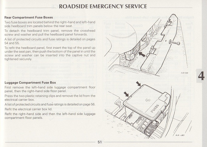

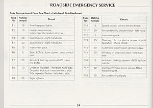

Try looking at the blue relays in the heelboard fuse boxes. They are both IGN power relays and if they don't "click" when you turn the key to ON then you'll have a dead car electrically.
Take the heelboard covers off and while sitting in the drivers seat turn the IGN on and off, you should hear the relays click. If they don't then pull them out and re-seat them. Sometimes it is just a poor contact in the relay socket.

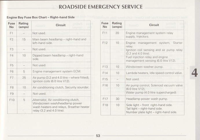

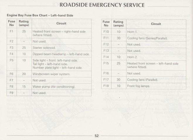

Hi Gaz, there are 3 master fuses on the car that are worth checking if the is NO power Originally Posted by Gaz1
