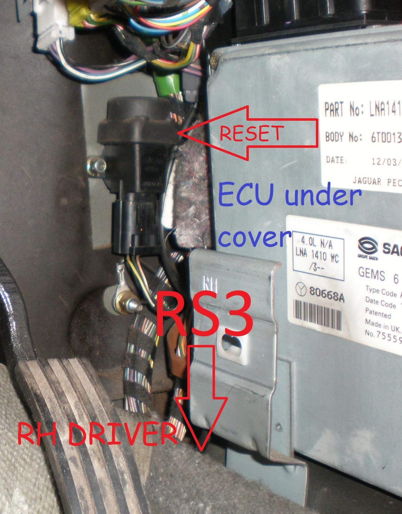

Check inertia / crash switch firsts as can be fickle even if you press reset , you can jumper it between the 2 white wires , pic soon , this circuit as a tripped switch will drop out your fuel pump ( s ) . With a good ear you can hear pump from cabin so I was lucky

This is a pic of a righthand steering as the switch will always be on the car's right , notice the gas pedal as a righthand steering
