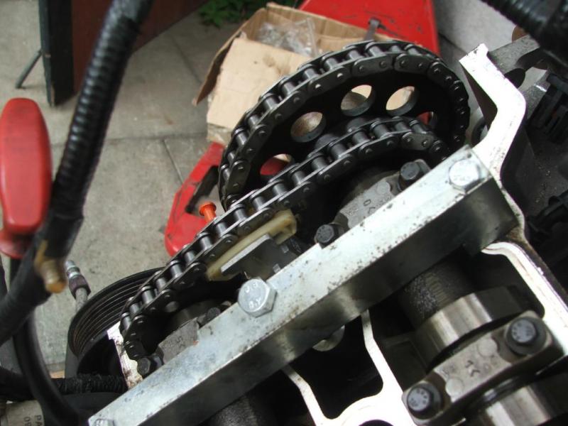

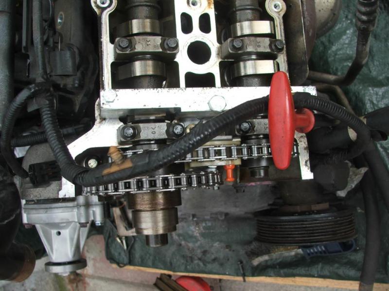

A picture paints a thousand words, I've one to hand so I'll grab the dimensions...
3 angle shots of it in situe, once the locate and fit the crank dowl the cams will be aligned, it's possible to do all timing with S/C engines, but better to lock both sides with VVT units.
(Plums suggestion of the zip tie method is ok for secondaries, but if the timing cover is off and you're doing both sets locking the cams is the way)
I hope this helps, done it a few times, if you need advice just drop me a pm.
If I could pop these round I would
