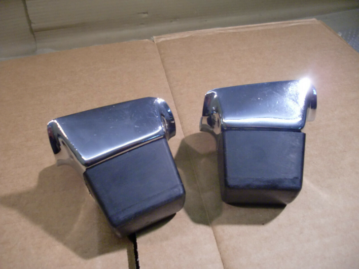

No harm done, though, either to the car or–most importantly–myself. Except that, as an extra preventative measure, besides the four wheel chocks I had also 'wedged' the front bumper pretty good against a thick set of old tires/tyres that were leaning against the garage wall at the front of the car, so that the car could not move forward–unless it tore the wall down, that is. (I never even imagined a sideways movement of the rear of the car like that!) The thing is that as I gradually raised the rear of the car, the front bumper became ever more firmly wedged between the car and the tires, and as the rear of the car yawed toward its right, the right-hand-side front bumper overrider moved still further into the tires, which–compressed already to their maximum as they were– allowed no further movement in the direction of the wall. (All the flexibility of their rubber had been 'maxed out,' so to speak.)
Not only that, but with the overrider now pressing real hard against the tires, the pressure now allowed for no movement of the overrider whatsoever, and so as the rear of the car fell down and the front went up (with the overrider wedged firmly in place by the aforementioned intense pressure), the right-hand side of the bumper buckled in and down a bit, enough to leave the entire overrider pointing down! The slight buckling of the right side of the bumper is not really noticeable (unless one looks as carefully and intently as a concourse d'elegance judge!), but it tears me apart to see the two front overrriders pointing in different directions now. I tried to straighten the offending overrider up by pulling it upwards using my own bare hands, obviously to no avail.
I was wondering: since it took brute force (the entire inertia or momentum of the car as it yawed and fell) to get to this situation, how about using brute force to straighten things back to where they were at the beginning? If I put a jack stand under the overrider with the car raised on a jack and then carefully lower the car (putting some of the car's weight on the overrider itself for a while, with the jack stand under the overrider supporting that weight), will this do any good or will I end up destroying the bumper and/or the overrrider altogether? Will the cure be worse than the disease?
XJ sII front bumper overrider, Euro spec
XJ sII front bumper overriders, Euro spec

I suppose there are 50 ways to straighten the bent bumper but I think what got bent is the Bracket.
Remove the bracket and compare it to the opposite side.

Yago, I'd highly recommend getting a good floor jack, they're very reasonably priced these days. Hard to tell in those pics but it sounds like you need to jack "up" under the over rider with a jack and a block of wood to tweak it back? Like Jose said, it could be the bumper bracket that's bent. In any case a hydraulic floor jack would make it so much easier and safer. We have Harbor Freight here in the states, you probably have something similar. This one has replaced my 2 ton snap on floor jack as my daily go to for anything that's not very heavy.

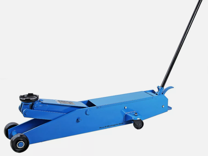

By "factory jack" (José) and "floor jack" (slofut) do you mean this?
My Volvo is a 2012 XC90, José–by no means lighter than the XJ!!

the factory jack is the jack that came with the car.
A floor jack is a hydraulic jack like in the picture.

It's money very well spent Yago, although the blue one in the pic looks a bit large (and crude) for the amount of jack. I don't know anything about them, but this company is in spain,
https://www.rsf-maquinaria.com/en/ot...r-jacks/gt-20a
and this jack would be much more useable and easier on the back.
Maybe even look into aliexpress, they have the same jacks harbor freight has and at the same prices.
