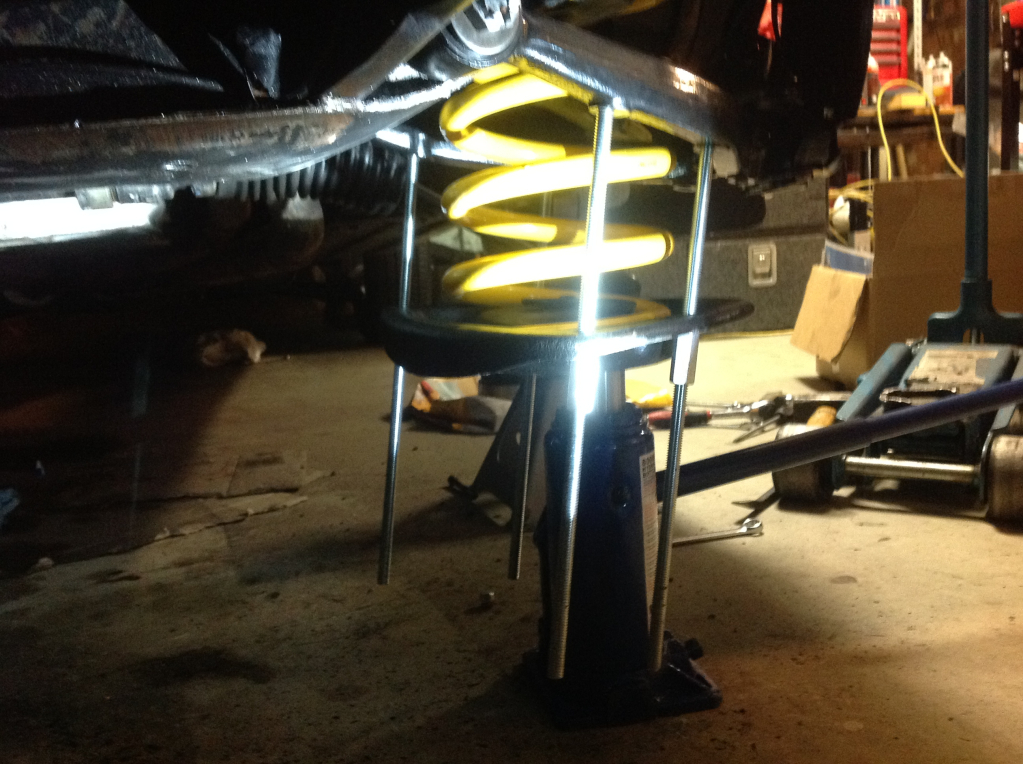

Had the front of the Daimler up in the air this weekend. I was hoping to be able to add a packer to the front springs to add a bit of clearance but the factory springs are so short I cant get my spring compressors in to get them! Looks like the ride height will be staying as it is so I mapped out plans for a nice big bash plate.

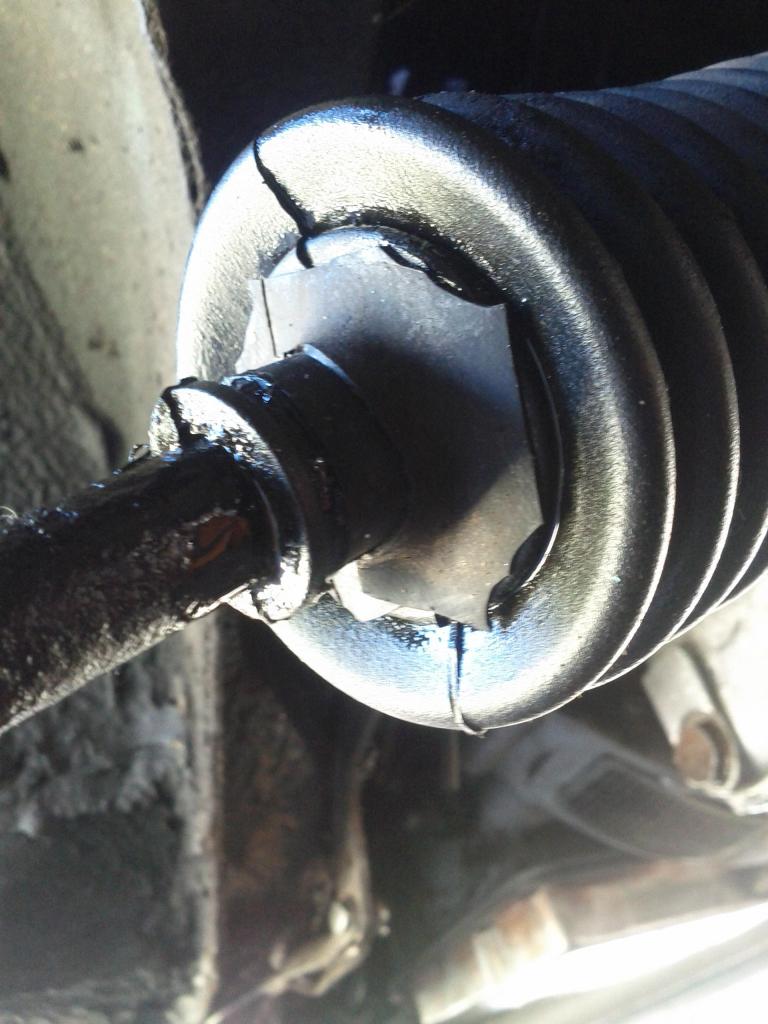

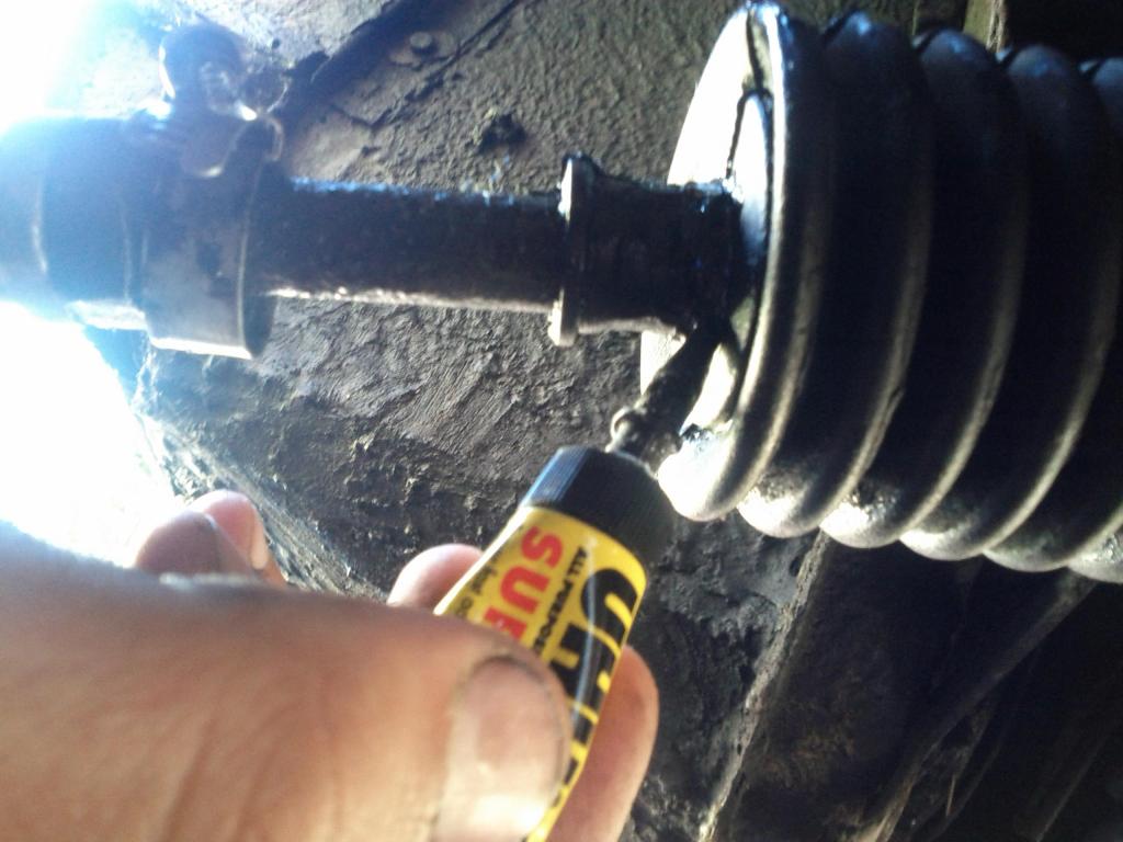

While it was up in the air I spotted a tear in one of the steering rack boots (I spotted the tear by seeing power steering fluid leaking out of it, but thankfully it is not leaking when stationary and not losing a lot, so I am hoping a power steering stop-leak bottle will deal with it for now). I was going to replace it then I remembered this was the Shitbox, so cleaned up the tear, superglued the edges together, then added 2 layers of bicycle tube over the top and lots more superglue. Only needs to last 4000km or so
IIRC, to remove the springs, they are supported by a spring pan, held in with three bolts. Get three pieces of threaded rod and nuts, place jack under spring pan, remove the bolts one at a time, and replace with the rods. Lower the jack until the springs are free. The rods are there only as a guide. Be careful, the springs are very powerful.
Thanks for that idea, I will see how scary the clearance looks once the bash plate is on!

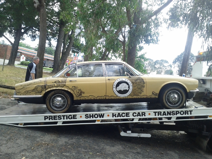

As you can see this did not go so well. After a couple of hours at the side of the road I had it towed in to work. Touch wood it should appear that a LOT of water made it into the fueltanks during our 1 day of rain recently (it had not been driven since), we had about a 50/50 mix of water and fuel coming out of the fuel line! An extended lunch break saw me draining the fueltanks, cleaning out the lines and wiping out the carbs and float bowls and she was up and running again! 30min in bumper to bumper traffic in 30+ degree heat challenged her on the way to bowls as she bordered on vapourlock, but she kept all of her fluids and touch wood seems to be back to normal

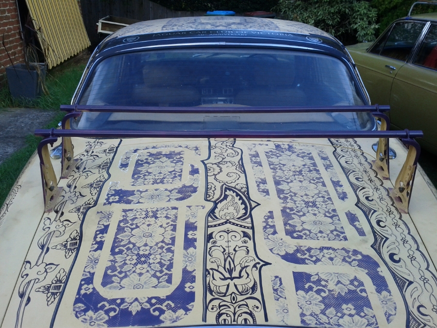

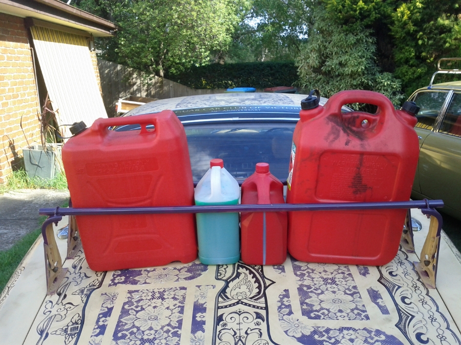

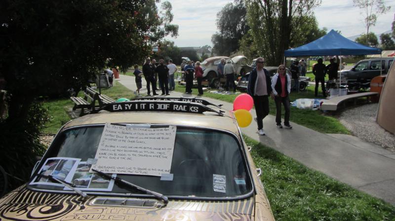

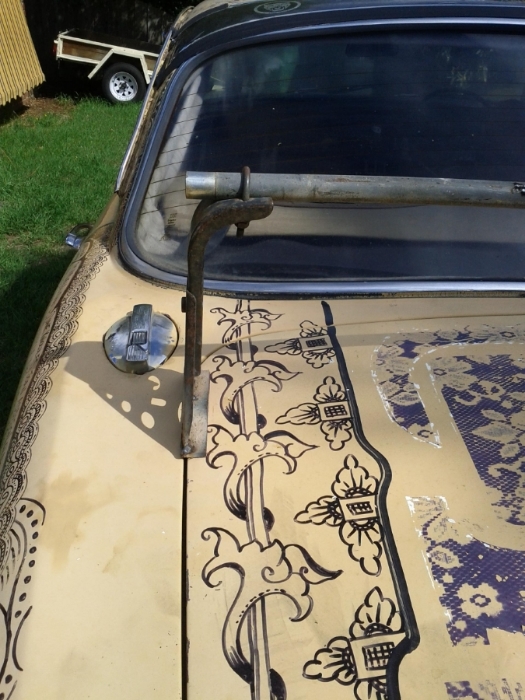

After a day off I battled the heat on Monday to create some roofracks. First up was trimming a $2 pair of swapmeet racks down to bootlid width. With additional feet welded on for stability these will hopefully provide us with a way to carry jerrycans outside the car without as much wind resistance as they would cause on the roof. In addition a second pair of swapmeet racks were cut to the exact width of the roof. Why? Because at this width they fit perfectly in the boot, and will allow us to bolt them on and use them should we need extra back seat space for additional passengers.

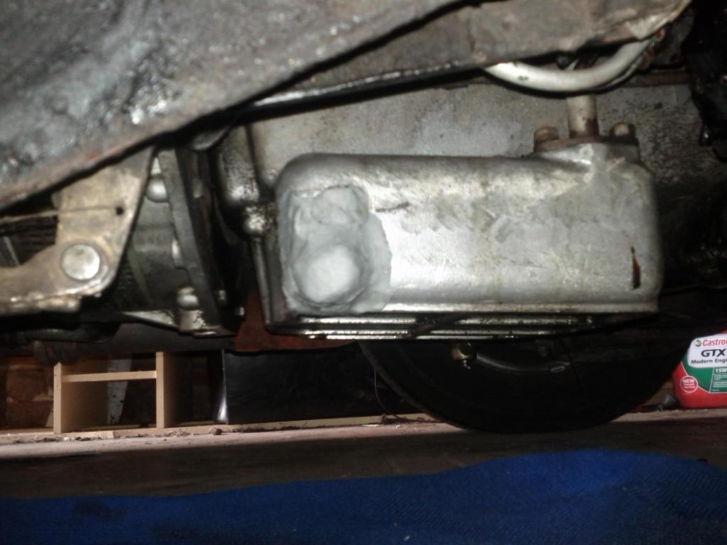

On the downside I decided to replace the oil one last time before the rally. When I removed the sump plug a helicoil came with it! the inside of the plug hole was polished smooth, so no chance of the helicoil biting in if refitted. After lots of hunting around I bought a large drillbit and 18mm tap to attempt to fit an 18mm sump plug. Unfortunately maybe due to my tapping ability or the softness of the alloy the new plug still doesn't appear to be holding in with any real strength. Stacks of red loktite on the thread and radiator repair patch will hopefully hold everything together until I have a better idea of how to repair without removing the sump! I have taken it for a quick drive after the bodge and it seems to have correct oil pressure and no leak, although the engine does seem a touch noisier which is hopefully just my imagination, no smoke or power loss...

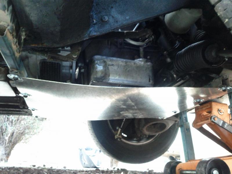

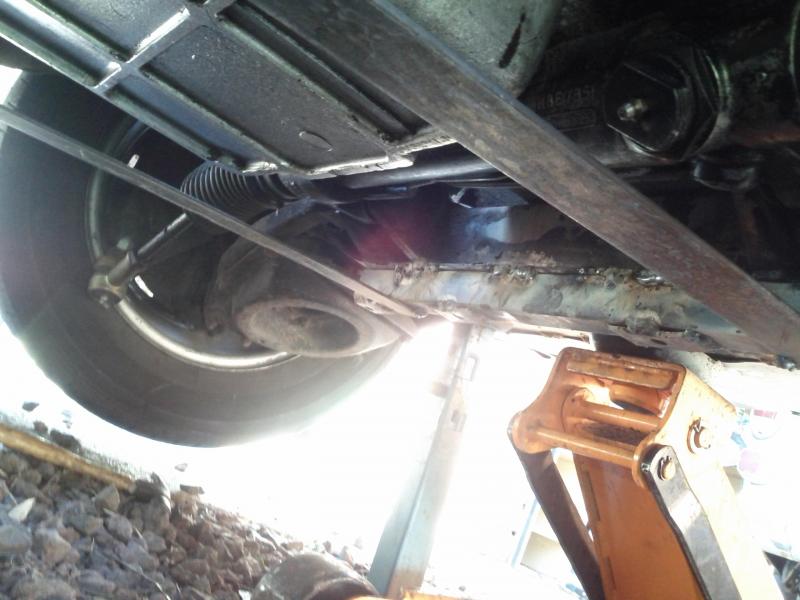

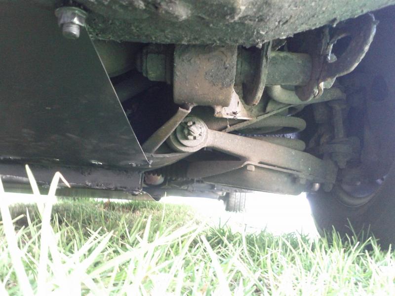

Sumpguard fitted!
RHS at either end to allow clearance, 5mm thick flat bar down each edge for support and 1.2mm zinc anneal bolted over the top. Far from pretty but it should be solid and can be unbolted to get access to critical items under the motor.
Need to add a little more support through the middle as it drums like all hell, but otherwise happy with the result. Also gave the electrical side of the engine a bit of a freshen up and I recon I can feel the difference driving it!

Bending the edges of the sumpguard has reduced flexibility substantially and reduced noise.

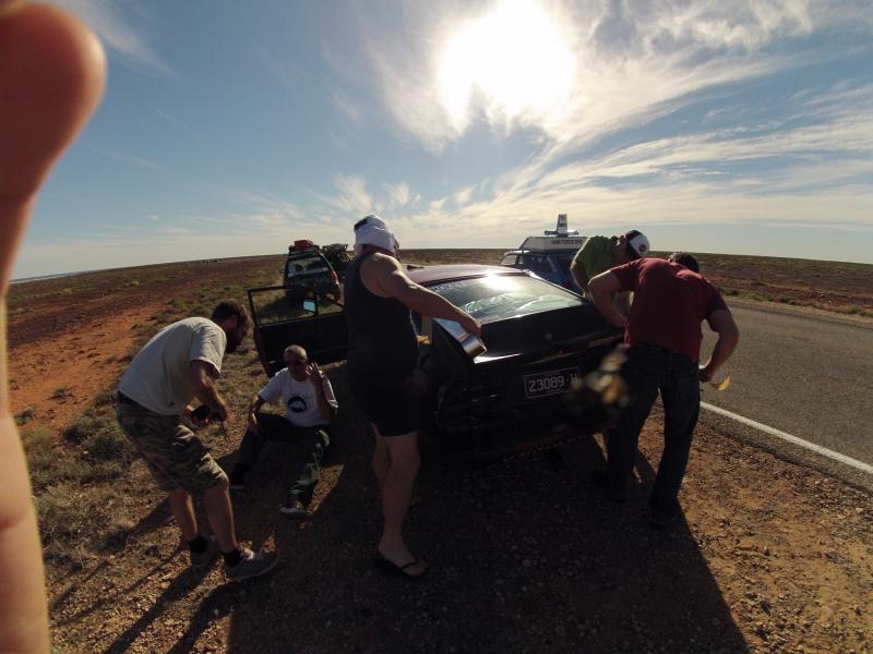

the 850km of day 1 was not without event, with our poor friends Smokey and the Bandit being rear ended in their Alfa GTV, which received a trailer light as a left taillight later that night in order to continue on.

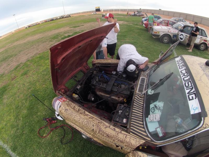

Although after telling everyone how well the Daimler was going that night the starter relay decided to die the next morning, resulting in an in-enginebay starter wire being rigged up:

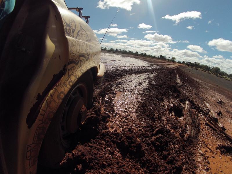

A quick fuel leak repair took place to the fuel filter in the evening of day 5 before 30-40mm of rain hit us and the road we were to leave on.
Thankfully the rain did not deter us and we plowed on through the mud in undoubtedly the most fun day of driving I have experienced
