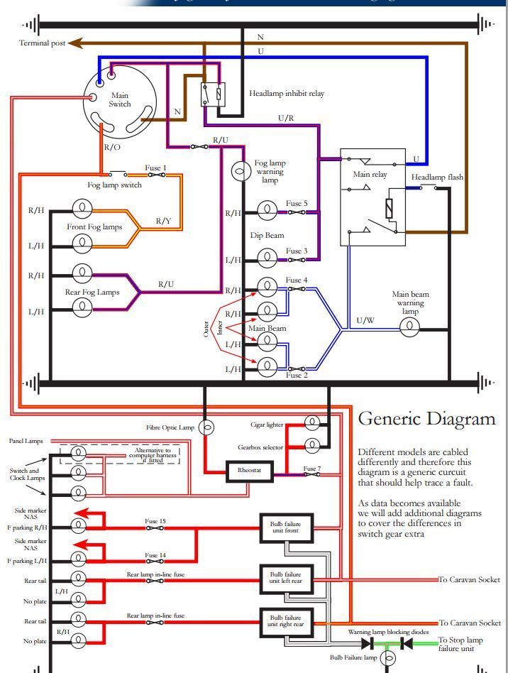

So i grabbed my self a multi-meter, checked the connection from inside the housing unit bulb holder no power, unplugged the housing and tested the main line the goes back into the hull no power,. interestingly enough the left hand plate light has gone as well "i didn't notice" and has exactly the same symptoms....is so now its Left hand tail and left hand plate illumination is out
Looking at the diagram i stumbled across it would appear that the inline fuse could be a safe bet..but didnt see it when i was poking around , i traced it as far back as i could into the boot, bit it looks like its running through to the cabin.....where is the inline fuse for that little circuit :(

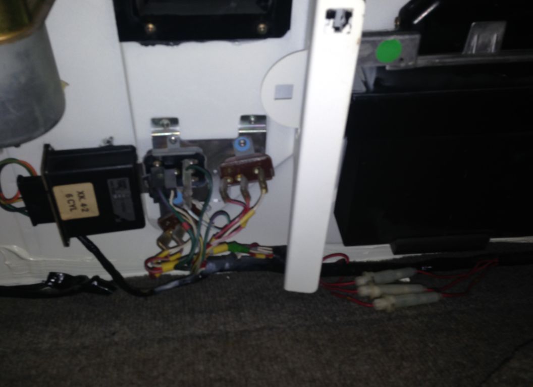

When this happened to me it was a fuse in the trunk. Cant remember exactly where, but it was near the bulb failure board

https://cimg5.ibsrv.net/gimg/www.jag...1049d69583.jpg
ah finally found it managed to locate it with a little help from this page it was the three little buggers below the ECU
