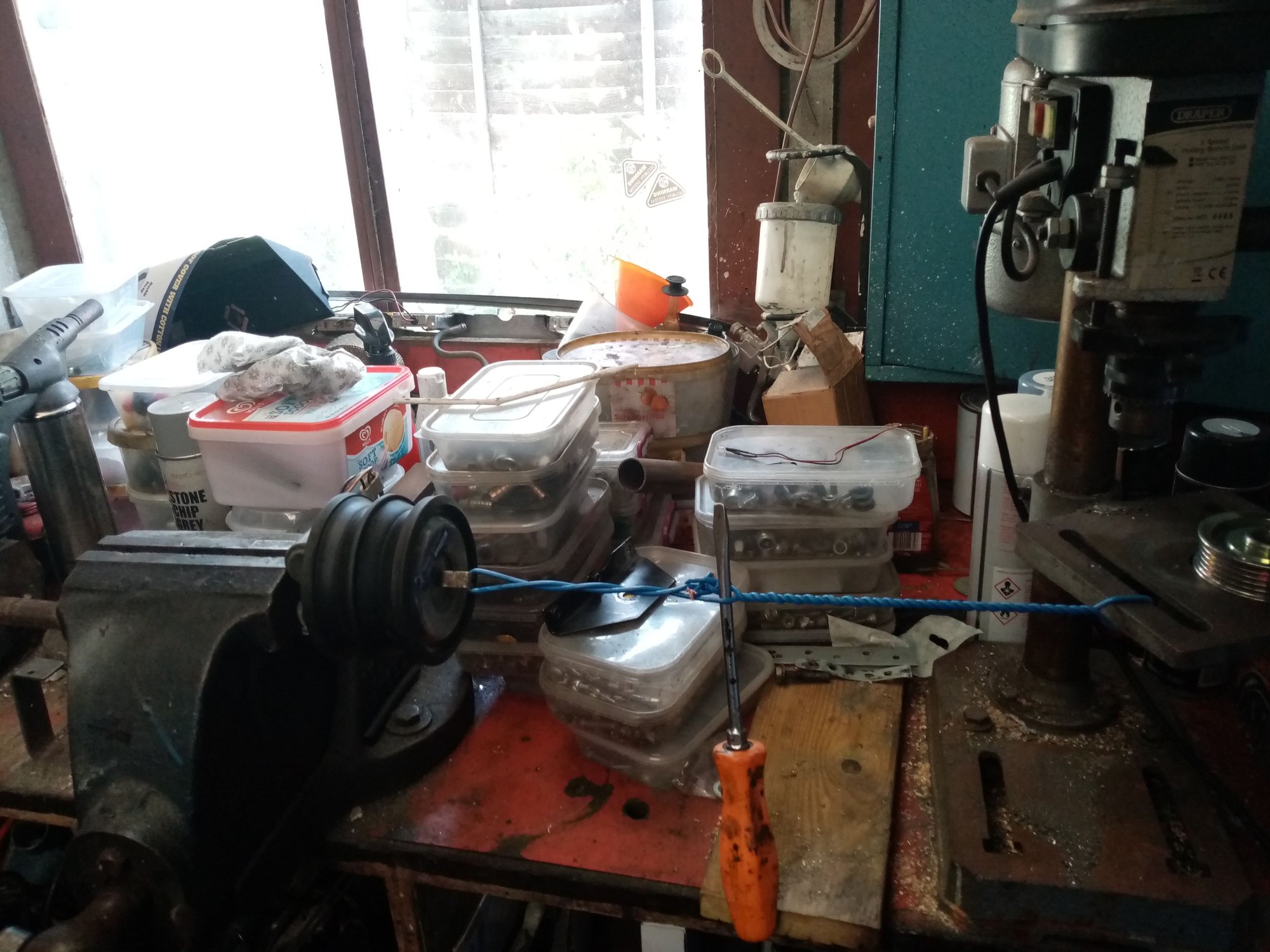

Stretched to within 3/16" less than original with the help of hot air gun
