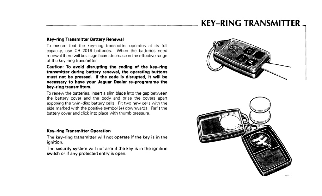

Here's the page from the US Security System Handbook for your MY:
You need 2 x CR2016 batteries.

Thank you!!!
Jax
