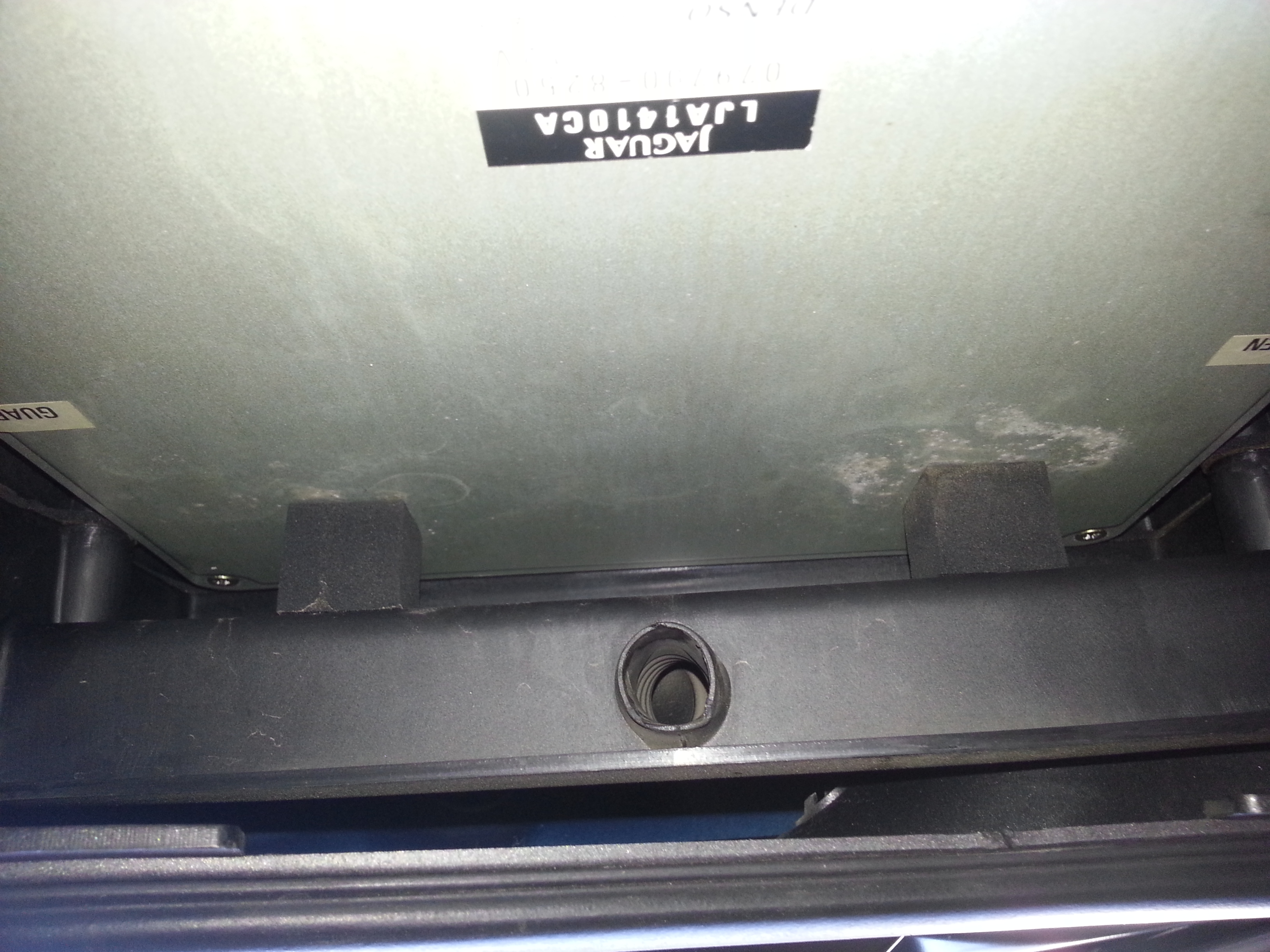

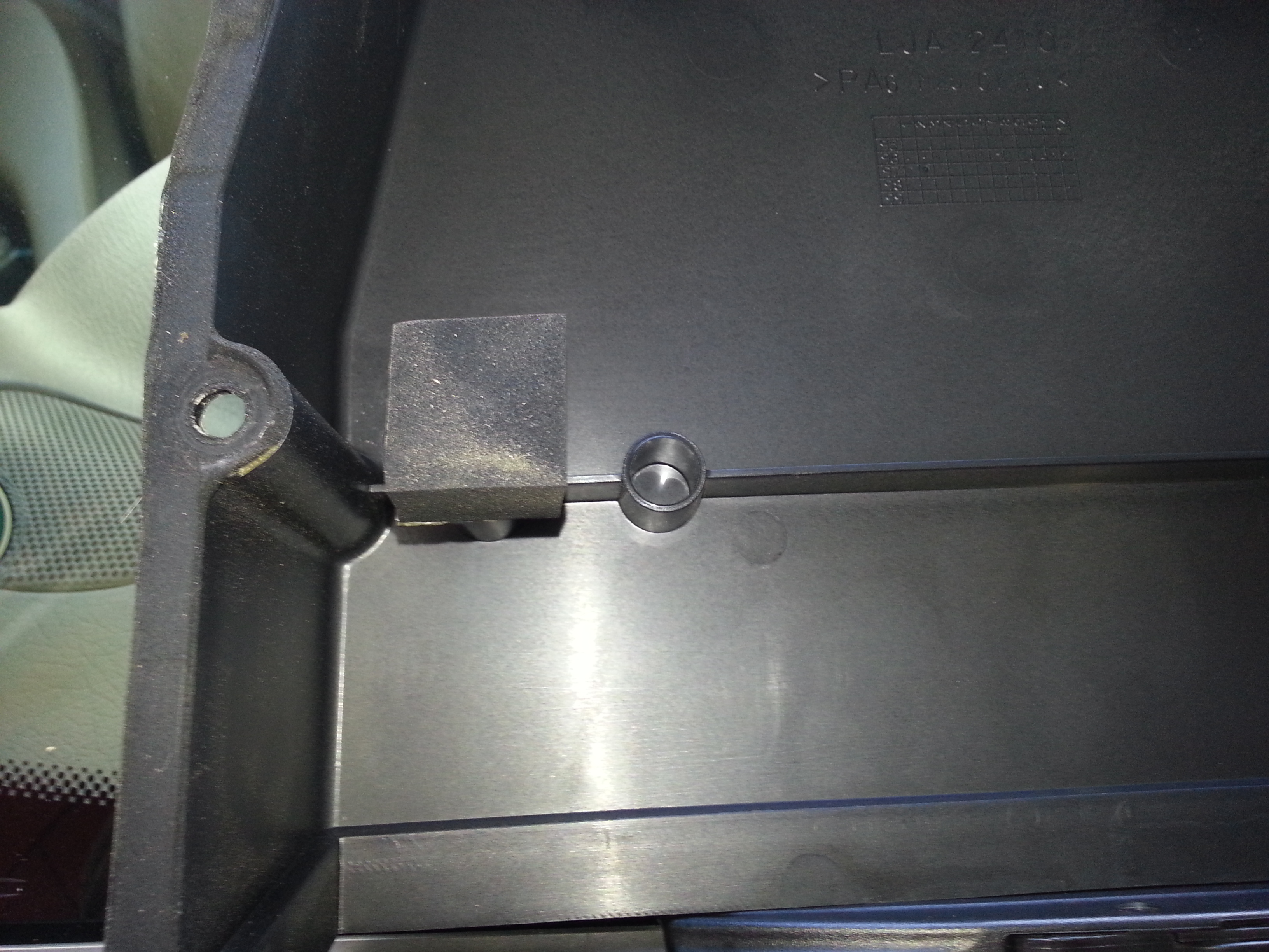

Hi again.
I remembered wrong about the foam blocks.
It is six all together all on top of the ECM.
Two are glued to the top of the compartement all th way in the back.
The other four are glued to the lid of the compartement.
See attached pictures. (I think some of them are upside down.)
correct TPS for 1997 -  fix DTC  P1224-20171026_145454.jpg   correct TPS for 1997 -  fix DTC  P1224-20171026_145524.jpg   correct TPS for 1997 -  fix DTC  P1224-20171026_145529.jpg   correct TPS for 1997 -  fix DTC  P1224-20171026_150600.jpg
Reply 3

Oyster -
Thanks for the photo. I immediately went out and looked at my car. The cover had only two blocks and the box had none. However, looking around the box I saw three foam blocks lying loose at the bottom. So, I am short one but that is an easy fix.
I didn't think the ECM should be lying loose inside the box like I found it.
Thanks
Reply 0

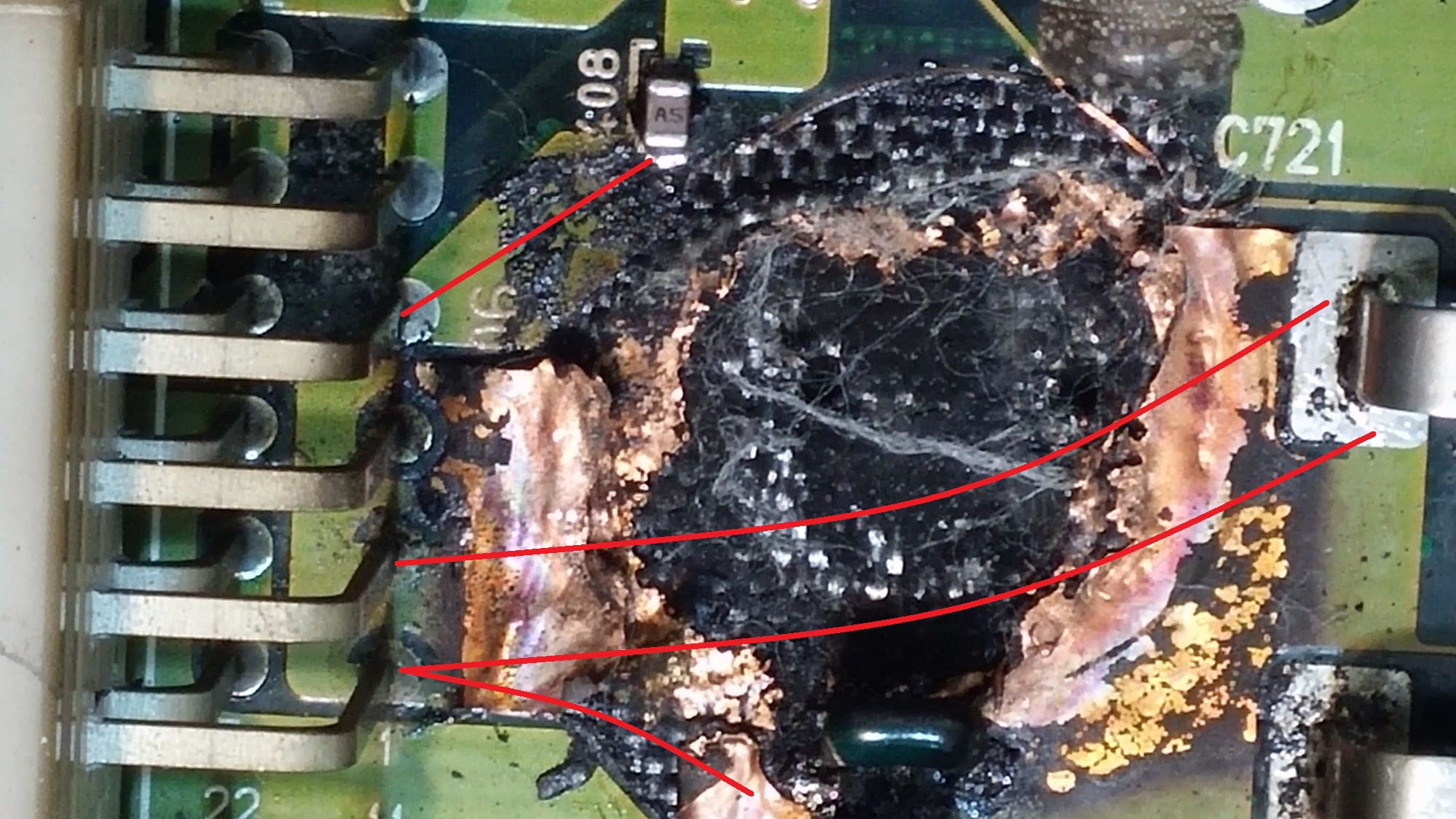

  #52
Well, ECM came out - eventually. Jaguar doesn't want you to get inside there. 12 'tamperproof' bolts later and I got the lids off.
I had a feeling that the later module internals would be laid out very similarly in that area, and that proved to be the case. I've taken a few shots, although I'm afraid my phone camera skills leave a lot to be desired:
You should be able to see from the second picture where pin 4 connects to the timy surface-mount component C408. It may be that the track is good on your board and just needs a bit more of a scrub-up.
?721 is C721 which is the burnt cap.
The blue cap upper leg does connect to the copper surrounding it.
I will make some multimeter checks as I need to determine where the logic 12V from pin 3 routes as it's an internal track. Fortunately there won't be many in that area. Again, it may well be good on your board.
I'm the first one in since the car was assembled, and it all looks like new, no sign of leaky caps. They are all Nichicon and look identical to the one remaining original that you have.
There's nothing I can see in my 98-on version that would indicate improved reliability. TBH, I suspect it's virtually identical to yours. Perhaps climate has a bearing?
They are well-engineered items IMO and I can see some of the manufacturing cost, but electrolytics are what they are and they do age and die - some more spectacularly than others, as you've discovered. I'll be changing them while I'm in there.
Take care to observe polarity when replacing them.
Mike
Reply 2

I cleaned up the areas you noted. At this point I think further cleaning may be harmful. Most of the carbon is actually the top surface of the board and you risk damage trying to remove it.
I looked at it with a magnifying glass and the connection running by C721 appears to good but tenuous. The connection to 408 I am unsure of.
Also, there is a small blue/green capacitor?? at the bottom of the burn circle that I am sure is fried. If you can identify it so I could know what to buy I'd appreciate it.

Hi Charlie,
I'd be tempted to strip that connection back and jumper. If not, then drop a spot of nail varnish so that it has some support.
The track to C408 may be OK - it looks like residue stuck to the top of it. You can confirm with a mutimeter between it and pin 4 which should indicate a short circuit. If not, then add a jumper across.
The blue capacitor is C720, and bears the marking '104M' which translates to 0.1µF:
Mouser Electronics 0.1uF 100V multilayer ceramic capacitor
810-FG26C0G2A104JRT6
UK URL but there are some pictures & spec:
https://www.mouser.co.uk/ProductDeta...eeUr1jxIgKo%3d
I've added some jumpering points to your pic (attached). With the exception of the possible link to C408, you need some fairly substantial wire as the missing copper is the feed to the throttle motor which is fused at 30A. Suggest 2mm minimum diameter.
I phoned Mouser UK today as they do look like a good source. Apparently no stock is held in the UK and they order from the US
I've messaged them.
correct TPS for 1997 -  fix DTC  P1224-ecm_10_0dce0765d343698841a88f9a68f318d1c4de8a91.jpg
