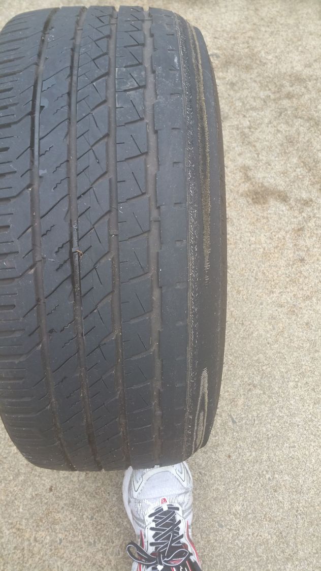

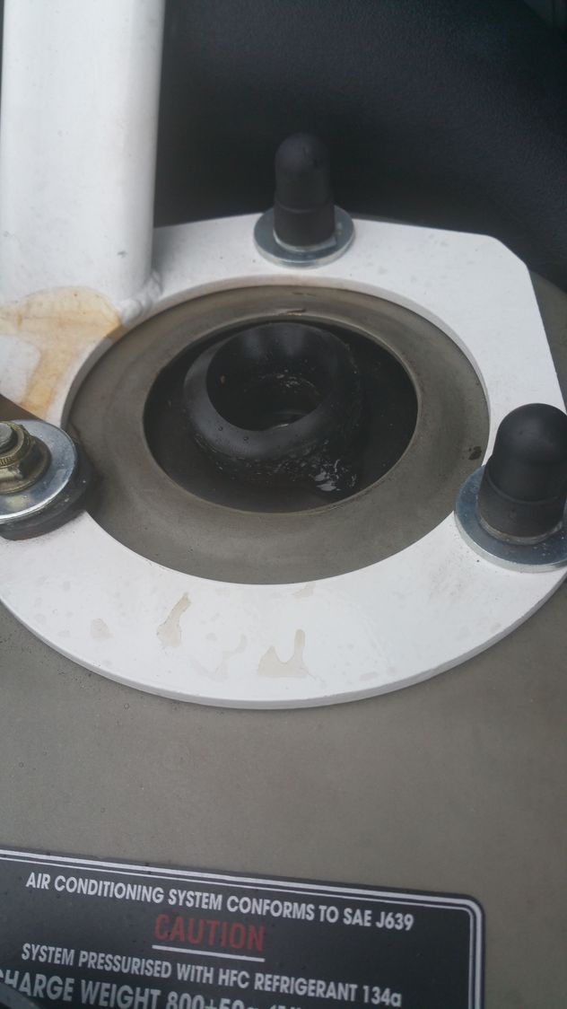

jobagadonuts May 15, 2017 01:18 PM
Watch out for the poly bushings. Mine lasted only a few months before complete meltdown. Ruined two new tires because I didn't think to check the mounts so soon after installing them.
https://cimg6.ibsrv.net/gimg/www.jag...150091e639.jpg
https://cimg8.ibsrv.net/gimg/www.jag...be5a40cd6a.jpg
https://cimg6.ibsrv.net/gimg/www.jag...429c489afe.jpg
