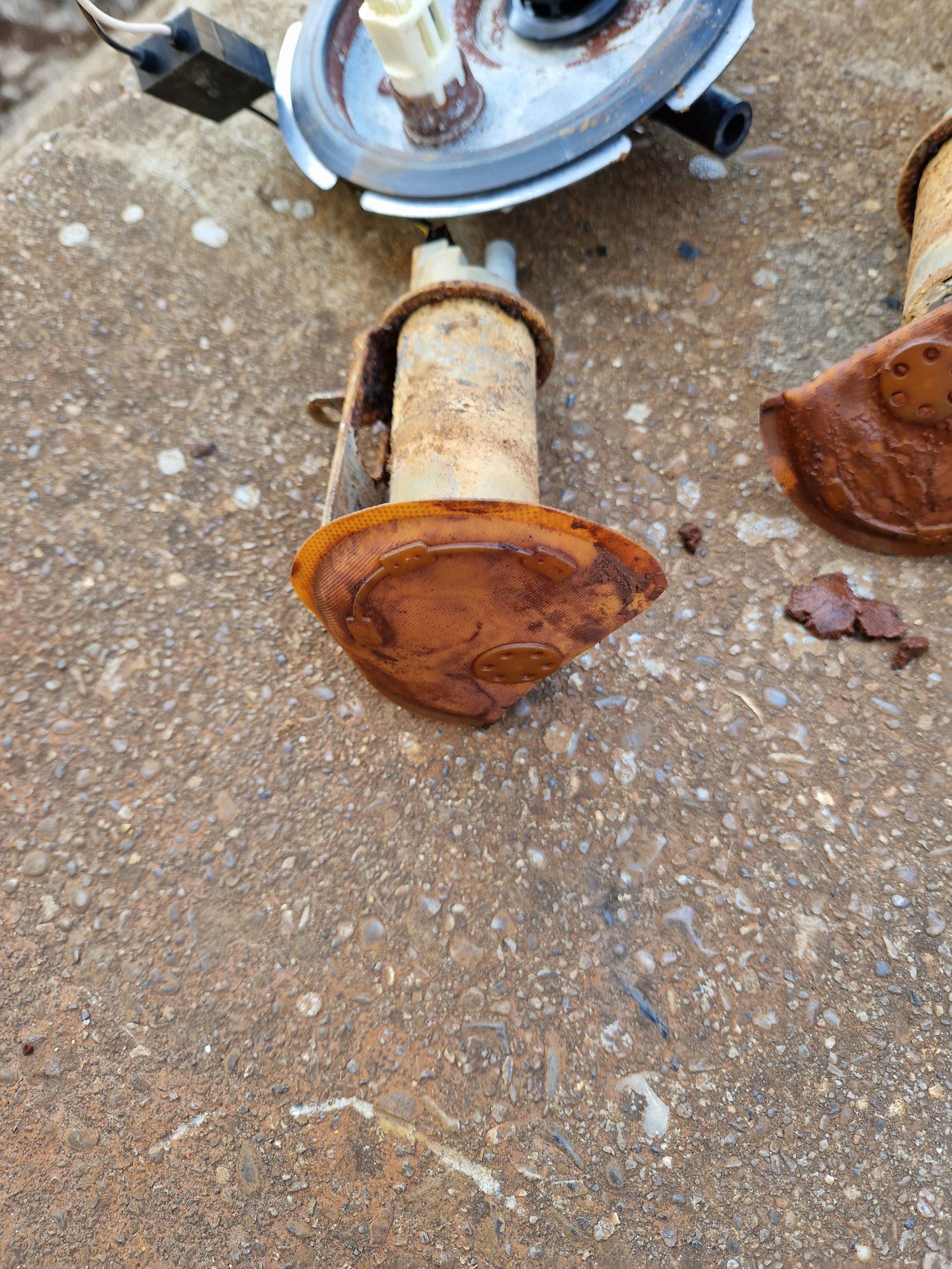

https://cimg5.ibsrv.net/gimg/www.jag...7024b03e9e.jpg
one filter was completely covered in sludge. One partially. No wonder fuel pressure was down!!
