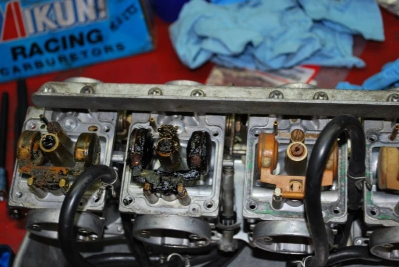

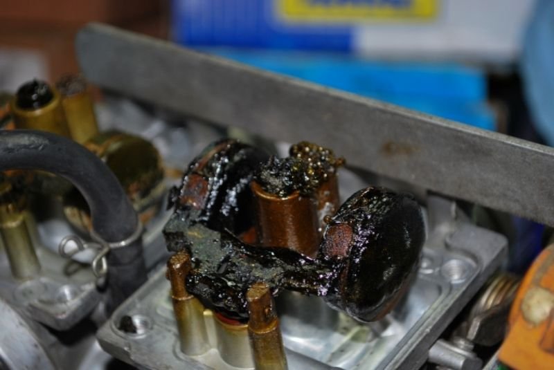

No codes are being recorded ?
a supercharger not putting out boost is usually just poor performance, without any other signature issues.
a car that’s been sitting for a very long time often has a variety of problems all linked to gasoline age. Even a new fuel filter can become contaminated rather quickly.
On the fuel delivery side, I’m suspecting some problem(s) with the gas flow or pressure.
Ignition wise, I’d suspect wiring damage from age, elements, or carnitas.
Anything more you can post about condition of car, performance anomalies, and parts replaced would help.
photo(s) are pure gas, not ethanol blend, that merely sat too long, the inside of the gas tank was even worse.
