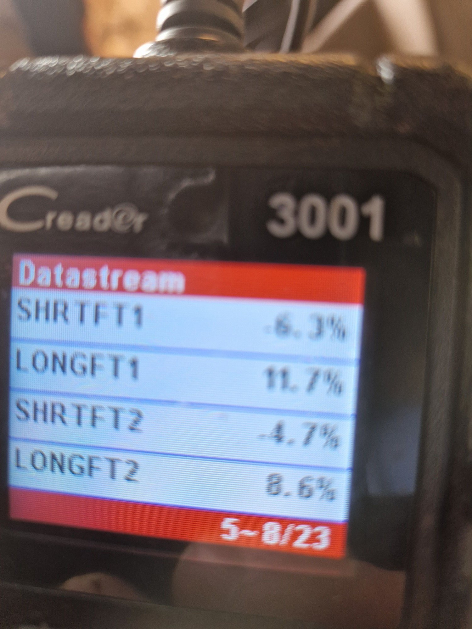

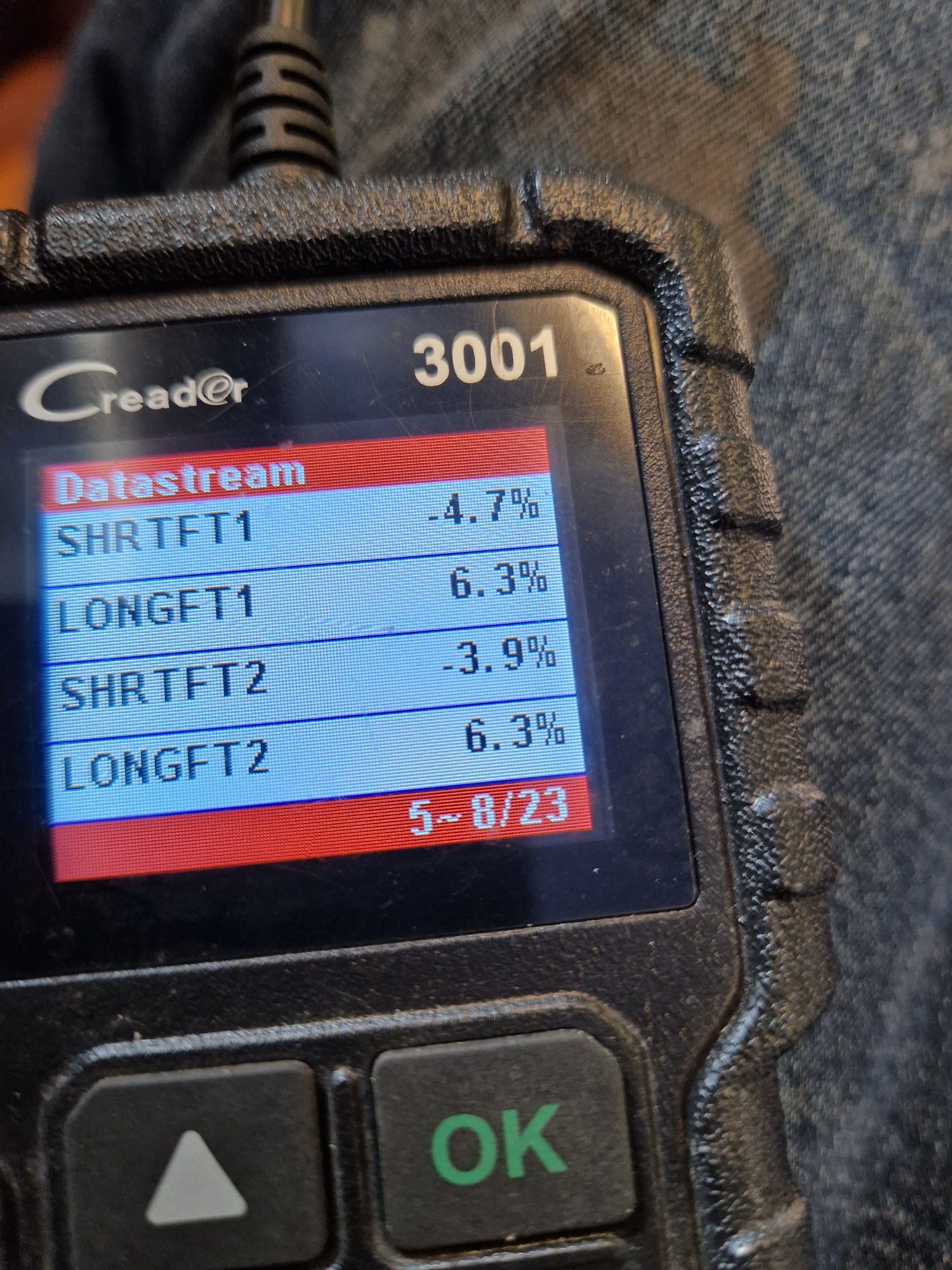

Hi all, quick update. Took the car out this morning and it quickly played up. Within a few minutes of driving it would accelerate and crept along at 15mph. When you put your foot down it just wanted to die. I have bought a fuel pressure gauge but I'm now waiting for some fittings. I've got a new fuel filter to try too.
Those trims show you may have an air leak. Do they drop near zero if you rev to (say) 2500 when parked?
When stationary i held the revs at 2500rpm. These are the fuel trims I got. No2 slowly increased but the reading shown is the max it went too. At tickover they were both equal.

Can you explain a bit more about those two photos? Were they both taken at 2500 rpm, or is one at idle and the other at 2500?
Have a look at this thread which is a good introduction to fuel trims if you haven't already seen it. JagV8's post #12 explains why you are looking for the difference between idle and 2500rpm:-
https://www.jaguarforums.com/forum/g...ed-quiz-49317/

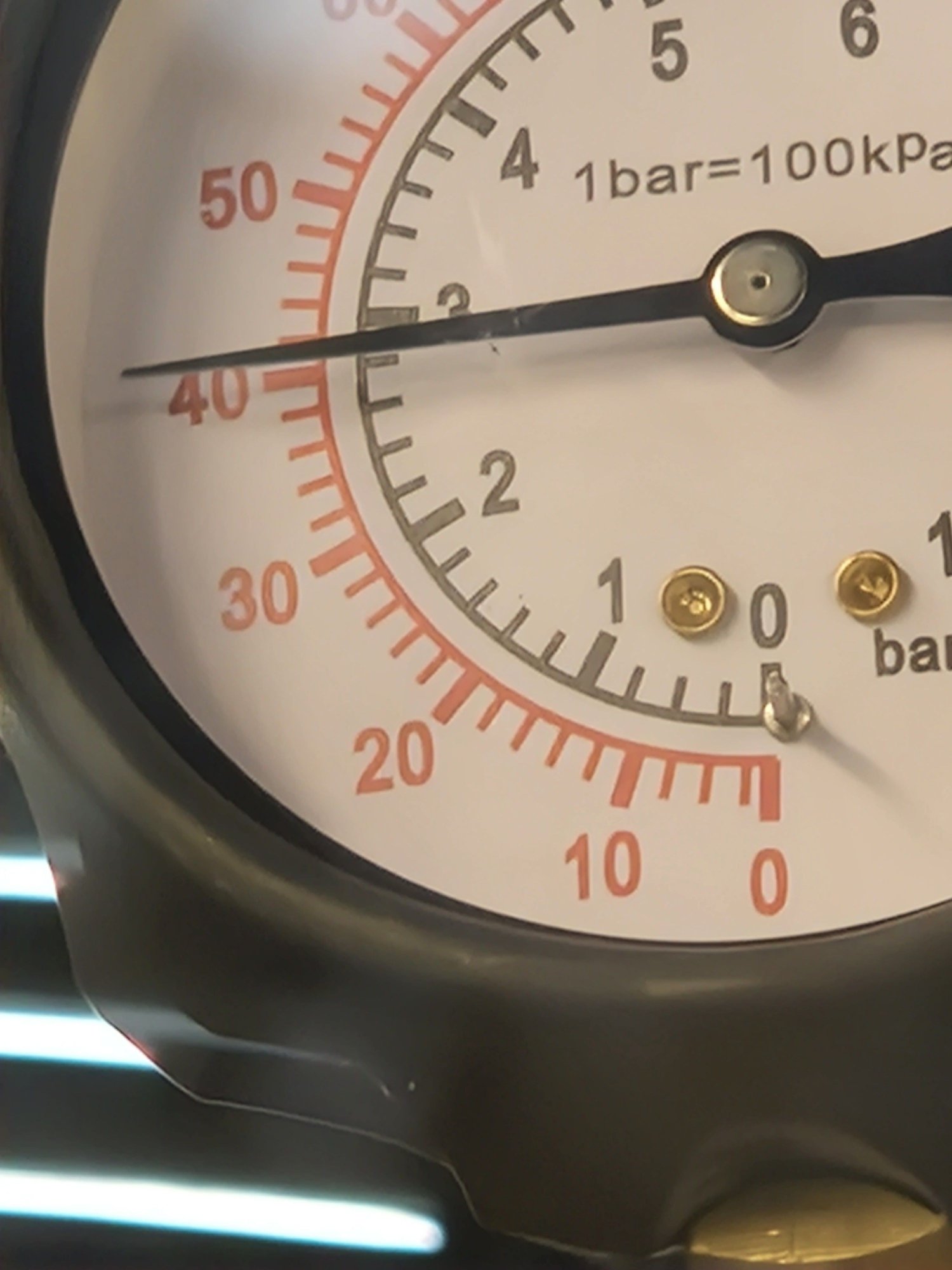

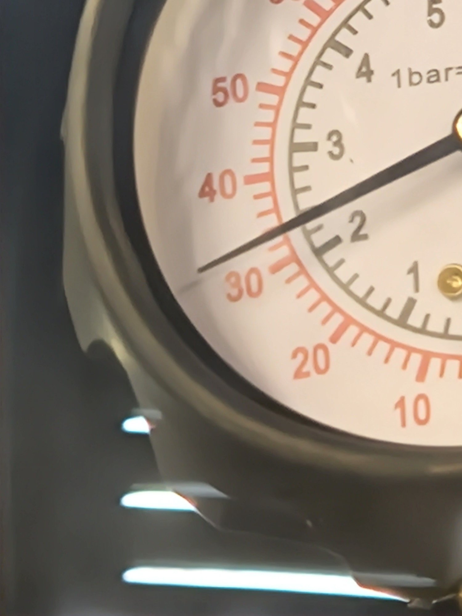

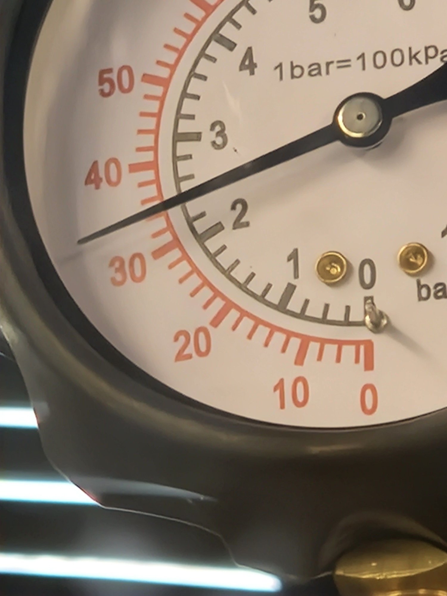

Hi all, I've been trying to connect to the schrader valve and after a couple of wrong fittings and late deliveries I decided to go the hillbilly route as they say. I removed the schrader and connected a fuel line in direct. I secured it with a clamp but still wasn't comfortable with it but needs must. Anyway it didn't leak and here's what happened!
At tickover after coming off cold start the pressure was steady at around 35 psi.
I had quite a long length of hose so i could reach the windscreen and dont know if this had any bearing on the reading.
I strapped the guage to the screen and went for a short drive. I didn't go far because I wasn't comfortable with the set up. However as previously noted the car was dying out under acceleration, and also deceleration approaching junctions or roundabouts. In the shortish journey it played up three times, each time the fuel guage fell away from 30/35 psi to 10/15psi. On one occasion it nearly stalled which is also what it has been doing.
Upon my return I left the guage connected and it was holding pressure but dropping very slowly.
would you learned people think the pumps are the culprits? Is the fuel pressure regulator ok as it was maintaining pressure after being turned off?
As always many thanks for your assistance.
It only hit 40 psi once while out. 35psi on tickover and dropped to around 32psi when revved to the limiter at standstill. So more revs meant bit less pressure.

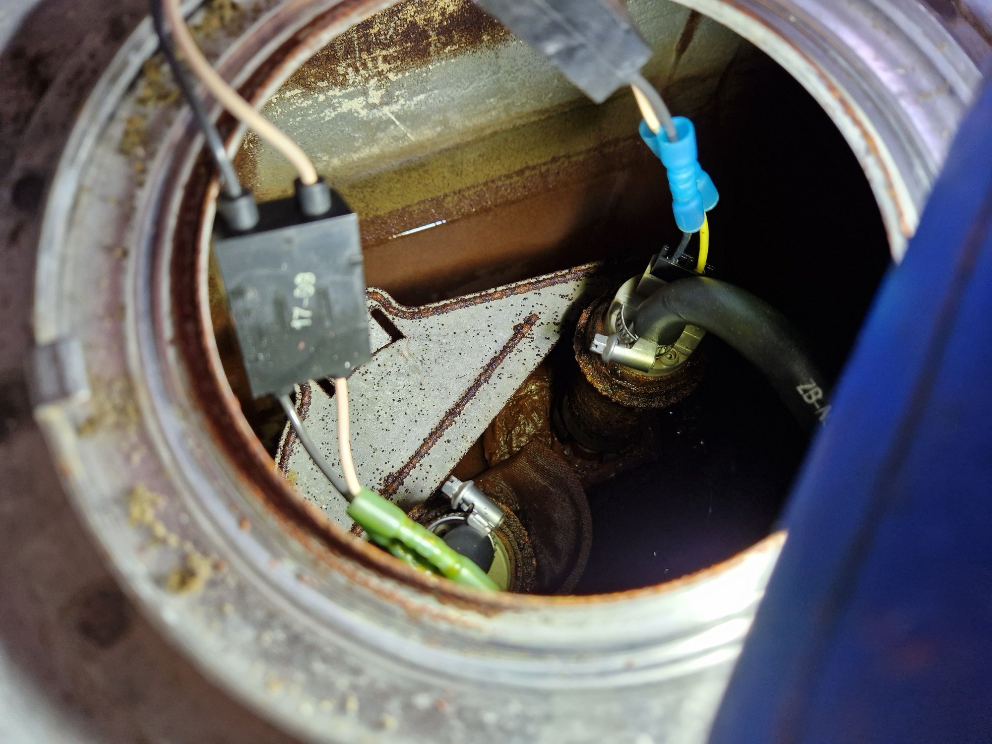

Made a start this morning. Decided to drain the tank by jumping the relays. I noticed that I could hear each pump working as I have said before, however fuel was coming out of pump 1 inconsistently ie surging. When I switched to pump 2 nothing came out at all. That typifies how the car has been running. I'm thinking maybe the filters are clogged on the pumps? There fun the fuel lines. See me being a while!
Old Jul 9, 2025 | 06:52 AM
  #40
brinny's Avatar
Joined: Sep 2015
Posts: 1,565
Likes: 477
From: Yorkshire U.K.
Update, i think I've found the problem.
any suggestions on tank cleaning and sealing? I had my xjs tank done with a company in Newcastle and very happy with it i was. Might try them again. Just pleased I can cross this off.
