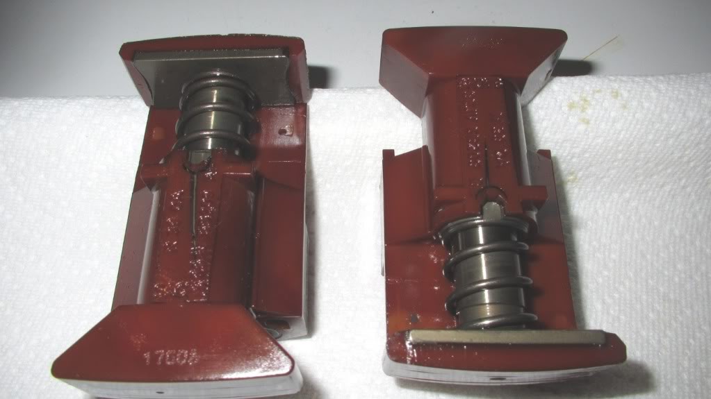

So over the course of the last 4 days, I've come home from work and spent an hour each night performing the Secondary Tensioner replacement and now I'm happy to report the car running just fine with the 3rd generation tensioners installed. Thanks to the superb FAQ created by SimonAllen and the two-part description by EZDriver I felt confident in going ahead and planning the task, and sure enough it went forward without a hitch. Thanks too to WhiteXKR for posting the Ford part numbers for the parts, which saved me a couple of bucks more. I read over every thread I could find on the subject, and appreciate all the other reports, so I thought I would add my own to the library.
The removed tensioners are shown below, showing the typical cracks. Just like others have reported, these can't be seen when they are installed in the car. If you remove your cam covers and think you don't have any problems because you can't see anything, you're just fooling yourself. My car only has about 49k miles on it now, 3k more than when I bought it. The engine looks clean, as if it enjoyed regular oil changes and no overheating, yet the plastic tensioners still are cracked. As for other common notes about the task:
  • I used the ty-wrap method. Found it was very easy to get everything unbolted and lift the cam up out of the bearing surfaces and then hold it with one hand while removing and replacing the tensioner.
  • I cut short the stud holding the dipstick tube in place, but then found the tube moved quite freely anyway. Such is life. I cleaned up the cut end of the stud, and re-installed everything.
  • I didn't fool about with turning over the engine with no fuel pump to prime the tensioners before starting. However, the engine was reluctant to start and took a couple of cranks before it fired up. So by accident, I guess I did follow that advice... No codes were thrown, and if anything I swear the sound is now smoother than before, although I admit it might all be psychological.
  • I drove the car slowly for a couple of miles before revving it above 1500 or so, and then gently for a couple more miles with frequent stops while I tried to locate a rattle in the rear window or top mechanism – but that's another story.
  • As mentioned above I used the Ford parts identified by WhiteXKR, and the Felpro gasket set. No issues whatsoever with either, and to say I'm impressed in general in the design of the gasket and how it fits in the cover. Not at all like the old days with the 1963 Corvair (another story).
  • Found a standard Sears small universal socket driver and long extension suitable for all cover bolts, even those in the rear bottom corner. The long extension was nice, letting me stand a little straighter when just “spinning” the bolts into place before exchanging the ratchet and applying the final torque.
To anyone else contemplating this task, it's not that difficult. Just a matter of reading the copious information available on this forum, being patient, turning the right screws at the right times, and keeping your hands clean. Oh, and did I mention you have to be patient, and think through any issues and problems before charging ahead?

Thanks Steve8 for the feed back. Glad you like the forum and that it was helpful. Surprised you would have been able to remove the dip stick without cutting the stud down. On mine there was no way in h..l I could do that and cutting the stud down was the only way. Your info is a great input to the job.
Here us the link to my post when I did my tensioners. This includes eleven pictures.
https://www.jaguarforums.com/forum/x...ics-faq-52653/

I didn't use any special tools, opting to follow the zip-tie (I call them ty-wraps) method instead. There doesn't seem to be any drawbacks, unless perhaps your cam doesn't want to lift out of the bearing surfaces. But mine popped right out, it's just the suction from the oil and close tolerances that holds it in after the caps are removed.
Once the cam covers are removed, one can clearly see which model of tensioner is installed. What can't be seen is the condition of the plastic tensioner (assuming it hasn't broken to pieces already). For mine, the cracks so visible in the photos were completely hidden before removal from the engine.
