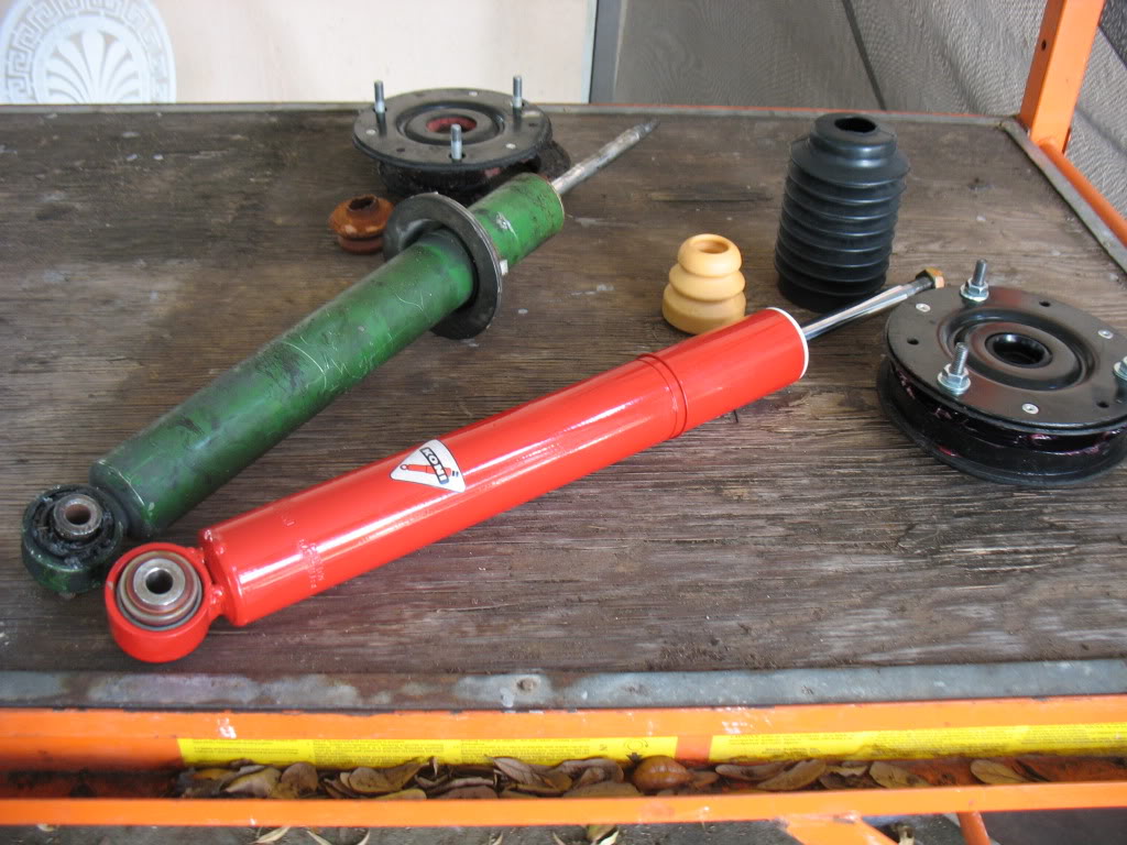

Attachment 176016Attachment 176017Here is the only picture that I had taken.This is of the old passenger side original green shock with a very bad lower shock mount and top plate parts.They "upper mounts" crumbled like broken up wax. This made my 2000 XK8 soft top feel like a death trap at 65mph up.Steering wheel shook violently.
Then next to the old is the new red KONI adjustable shock and top plate mount,put together.

hemitwist Nov 2, 2010 08:46 AM
The Koni shock package from Ebay came as follows.
2 red self adjustable Koni shocks.
Lower bushings came installed on both shocks.
2 new self locking nylon threaded nuts for the top shock post.
What you are calling the yellow spring assister bushing,must had been included.
A small white plastic hand dial that you use to adjust the shocks once installed is included.
The hand dial that they supply has a arrow on it saying firmer
clockwise,i think it was.
NO,the black rubber boot is my original cleaned up.NOT INCLUDED WITH SHOCKS
I used my original coil spring and lower spring plate that the coil spring sits on.
Spring plate is on the original green shock still,in the other picture posted.
And I rebuilt the top shock plates.
