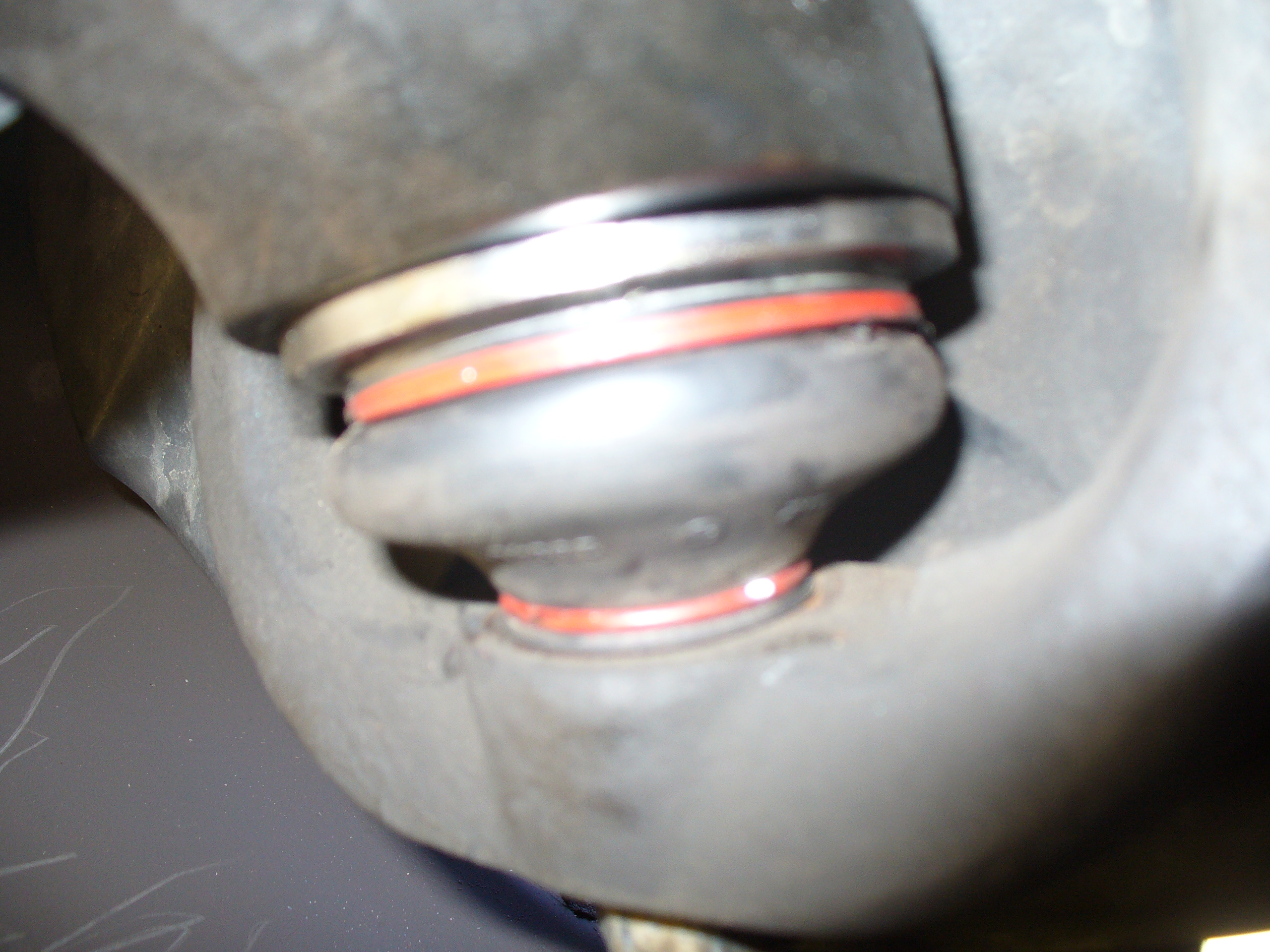

After a long time planning, I've finally completely replaced the front suspension on my 1998 XK8 w/ 140,000 +miles. It was well past time as my tires were rubbing on the fender wells when I went over a bump or bottomed out at a bridge. Picture before rebuild
Attachment 145315

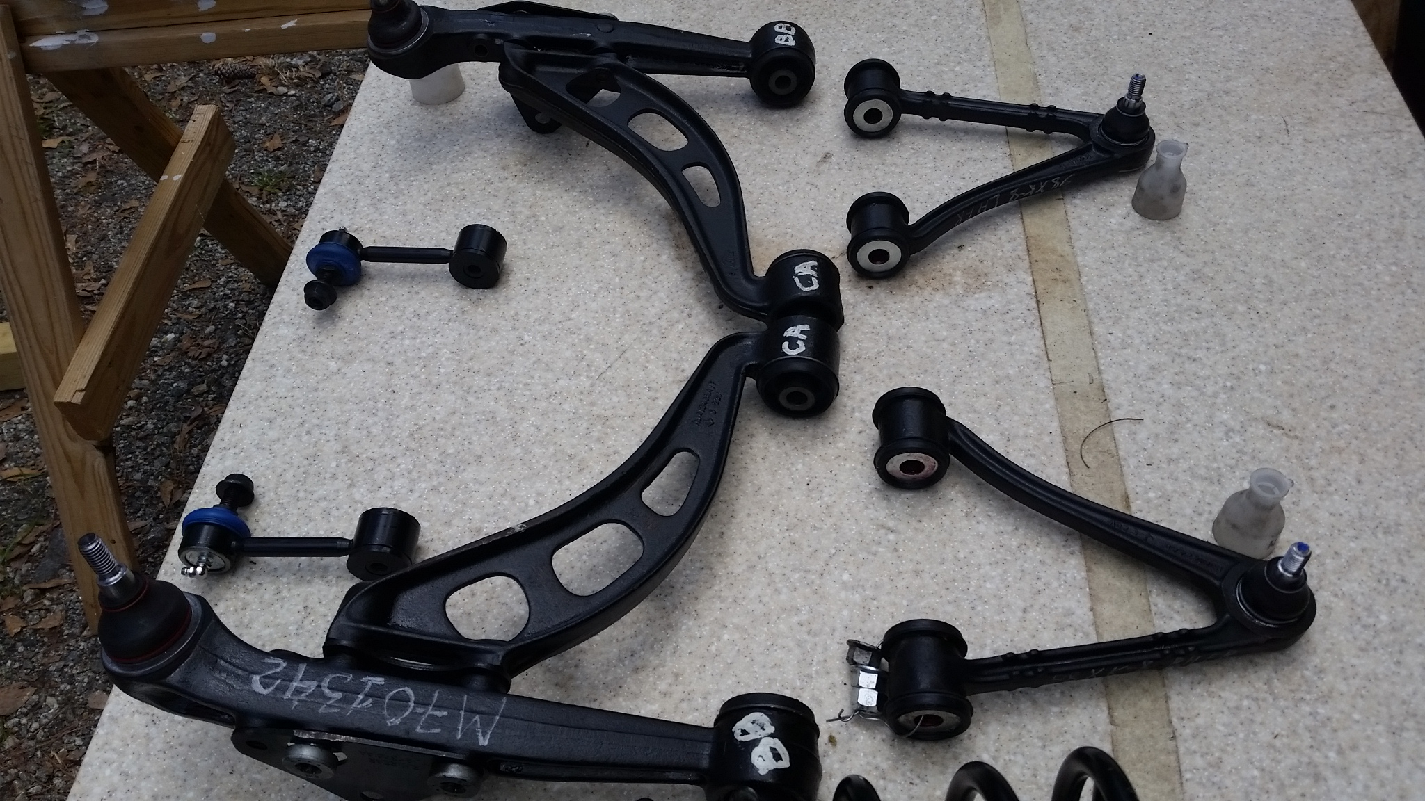

I began by watching Ebay for a while for used wishbones and complete control arm assemblies. I purchased these for a total of $277 delivered.
I took these to a local machine shop in N. Atlanta that does work for a highly reputable Jag repair shop. They pressed out the old Bushes and Ball joints, and installed the new ones supplied by me for $180.00. I had purchased the Lemfoerder upper and lower ball joints and Eurospare Bushings from Parts Geek for $372 delivered. Notice the CA & BB markings in the control arms. I also marked the corresponding bushes, as they were installed incorrectly on the ones from Ebay and I wanted to be sure this did not happen to mine. I had also purchased Mevotech Supreme sway links with poly bushes from Carid for installation later.
Attachment 145316Attachment 145318

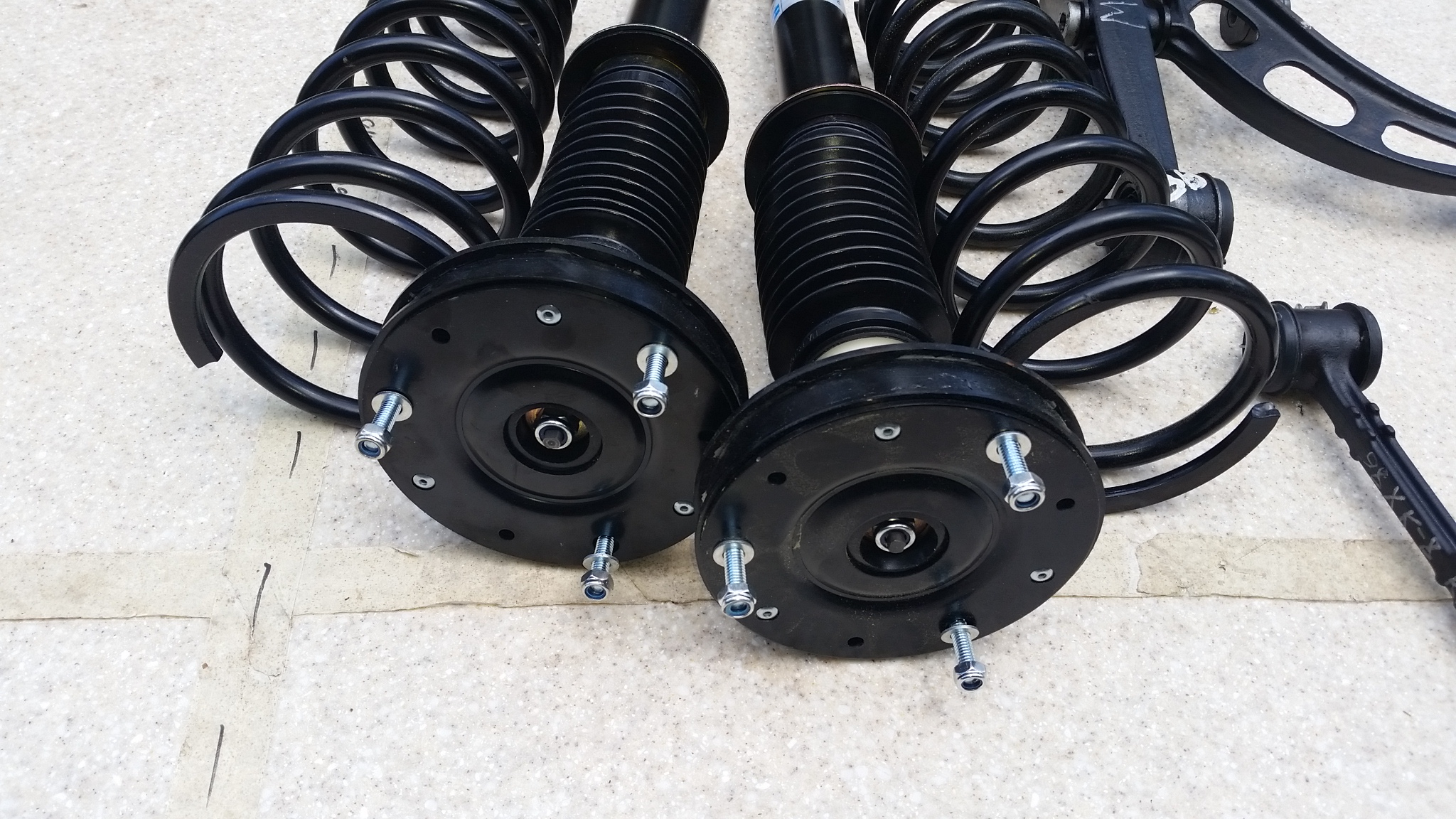

I purchsed new Lesjofors Coils from Geek as well for $255. (this may have been a mistake, read to end) Shocks, Bellows and Bump stops from Carid for $243, & Spring packer & pans from SNG Barrett for $31, and Shock mounts from Welsh for $155. Thats complete shock assemblies for $685.
Attachment 145317Attachment 145319
