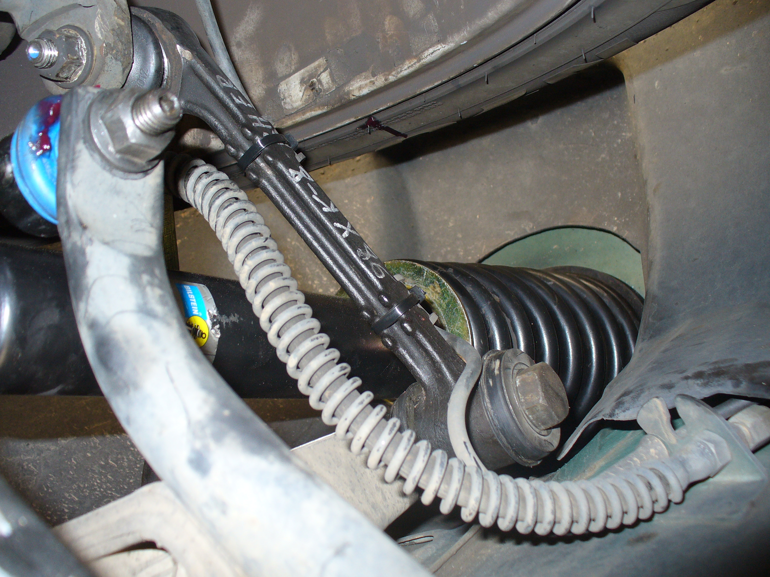

After a long time planning, I've finally completely replaced the front suspension on my 1998 XK8 w/ 140,000 +miles. It was well past time as my tires were rubbing on the fender wells when I went over a bump or bottomed out at a bridge. Picture before rebuild

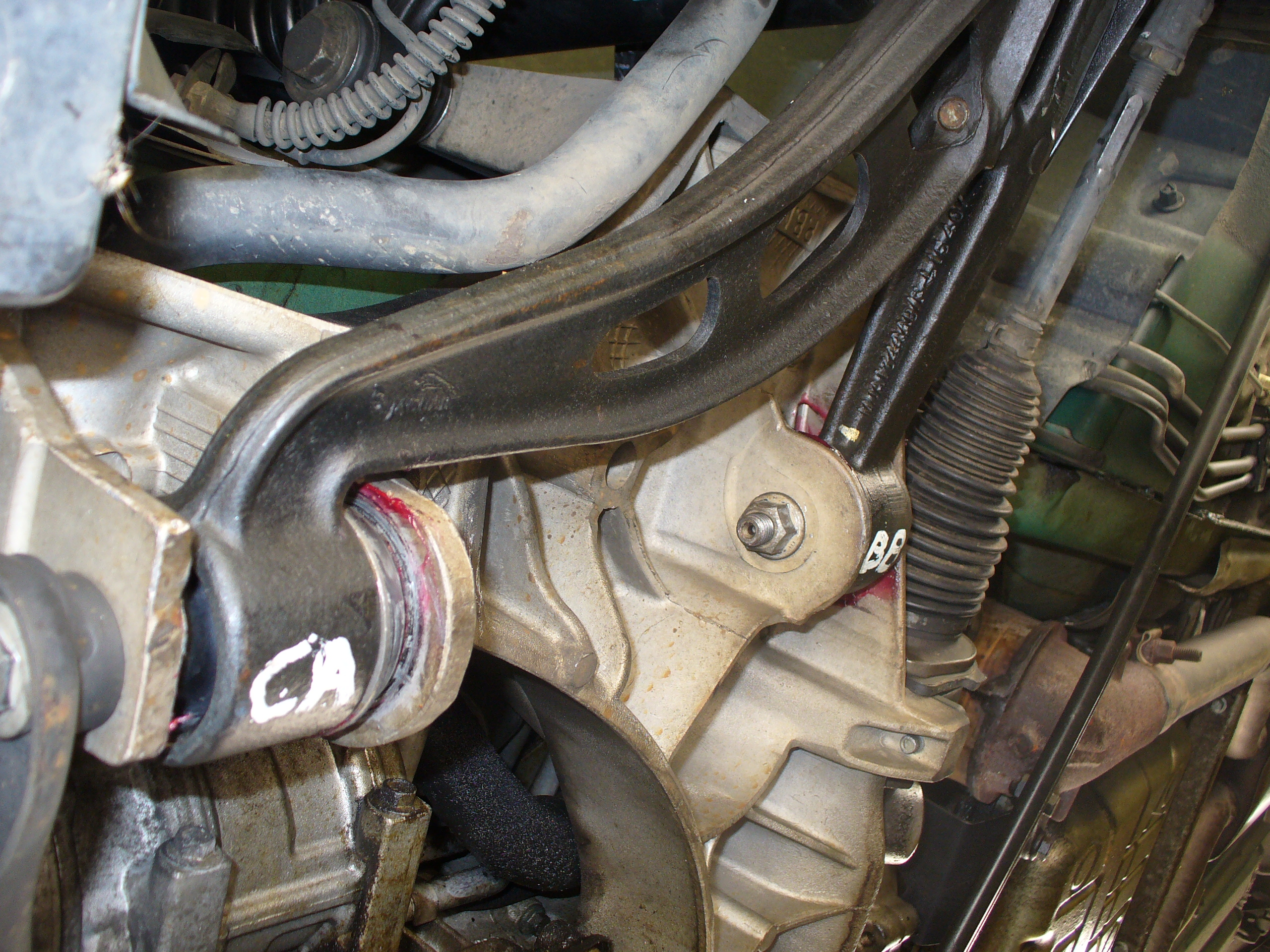

I took these to a local machine shop in N. Atlanta that does work for a highly reputable Jag repair shop. They pressed out the old Bushes and Ball joints, and installed the new ones supplied by me for $180.00. I had purchased the Lemfoerder upper and lower ball joints and Eurospare Bushings from Parts Geek for $372 delivered. Notice the CA & BB markings in the control arms. I also marked the corresponding bushes, as they were installed incorrectly on the ones from Ebay and I wanted to be sure this did not happen to mine. I had also purchased Mevotech Supreme sway links with poly bushes from Carid for installation later.

After completed, the ride is tight and responsive, a huge improvement. NOt bottoming out at all! The install has gone about as I had expected. I am all in at $2265, which I am very happy with as it could have easily been over $5000 had I not done my homework and some legwork
But there is one hickup. Before the rebuild, the front end was sitting at about 14.25". Spec is 15.75", so it was 1.5" low. After rebuild, it is sitting at 17", or 1.25" too high. I have read that it may take some time to settle in the coils, but after driving 300 miles, there is no change. No, we did not torque lower control arms until after tires sitting on ground. I am monitoring this to determine how or if additional actions are required. Don't think drive is compromised, but NOT happy with the look.
Also, you will note in photos, the sway link required slight modification. The attachment to the control arm required longer bolts and large flat washers, but otherwise was an exact fitment. I will also monitor this as well.
