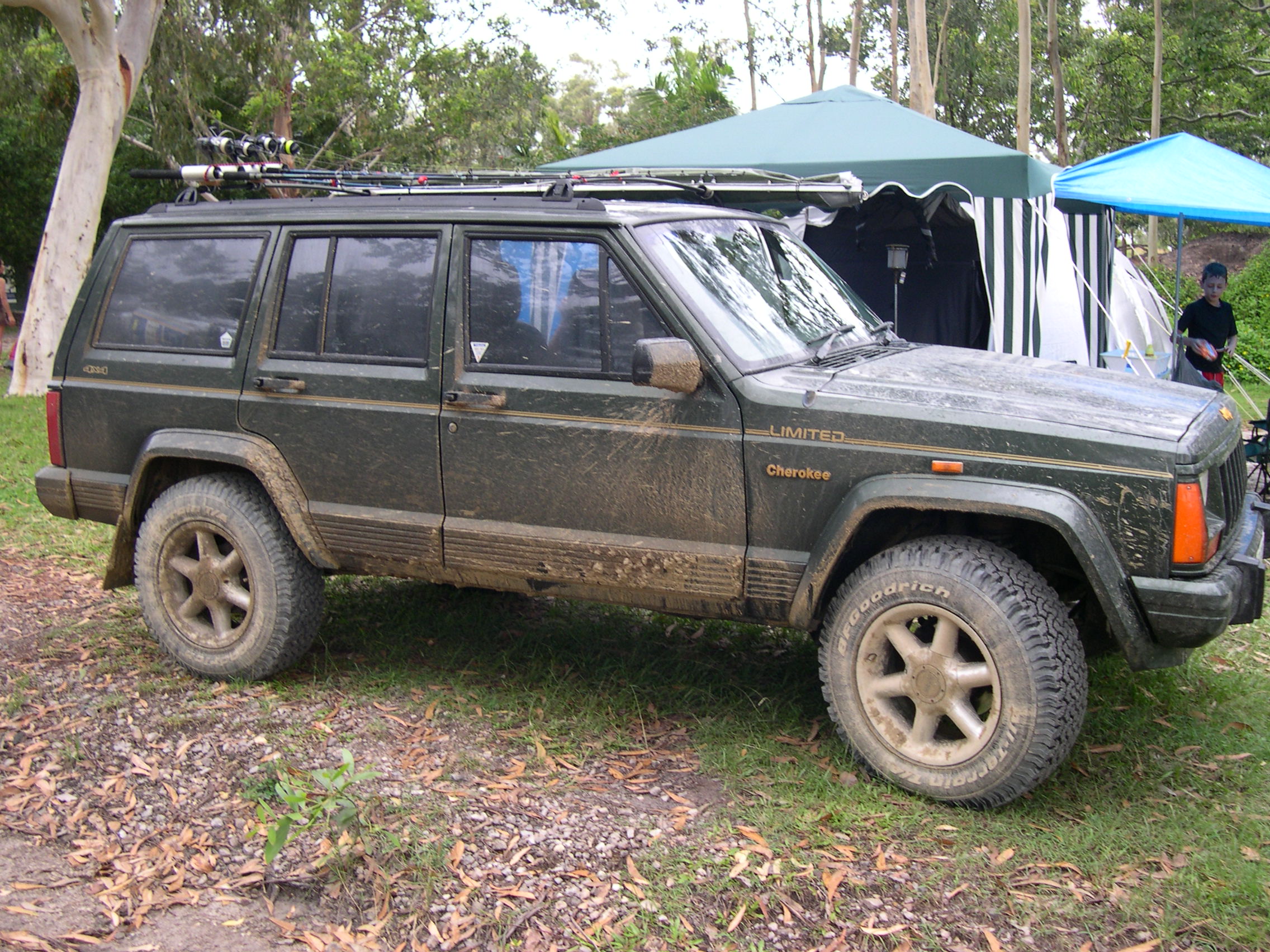

Default 1995 XJ Cherokee LTD
I have looked at 5 Jeep forums in the last week and been fairly disappointed with all of them.
So here we go.....
I'm going to bore you with a thread on my Jeep,If it is not your thing that is why it is in the "non-Jaguar Vehicles" section.
I bought it in 1997 for $17000 with 20,000 km on the clock(has 225,000 now), it was $49000 new.
The first owner was moving back to India and had to offload it quick, when I looked at it he had $33,000 on it. I sat back and watched.
When he had one week until departure I offered him $25,000. Obviously I got a knock back.
2 days to go I offered him $22,000. Knocked back again!
I rang him the day before he was leaving, the Jeep dealer he bought it from offered him $15,000 cash.
I said I'll give you $17,000 and drive you to the airport(he was staying one street away and I needed 24 hours to get folding).
Deal done. The rest is history.
Since that day in 1997 it has never had a paid mechanic lay a spanner on it except for air-con.
This is the first pic(s) I have of it, the day after we got it . A barge trip to Stradbroke Island to have my first off road drive. Only got it stuck once,lol. Let down the tyres and away we go again.

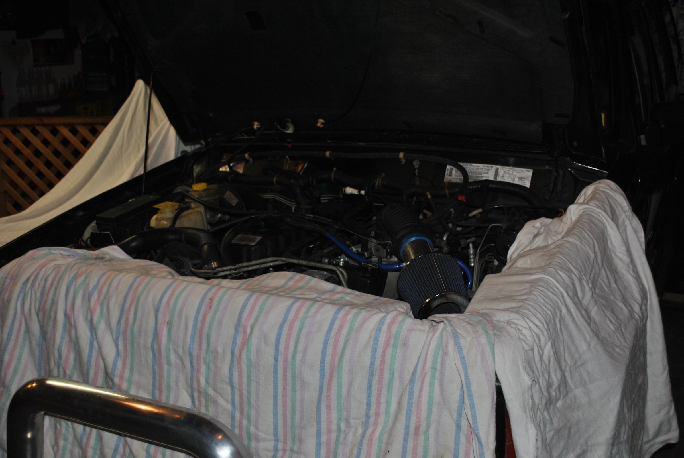

Hey Elinor,, nothin'g wrong with it. Just leaking coolant on the floor and because I know where its coming from all will be removed and replaced accordingly to fix it! Jacked it up today,..strip down tomorrow,then friday morning taking XJ6 to my mates exhaust shop to manipulate knocking muff and weld XJC (cherokee..not coupe) extractors then heading off on the 1200km road trip.(in xj6)
At least I know one person is following my boring Jeep thing.Thanx..
(Jeep is shoe-horned into usual workspace)lol
If you don't like Jeeps or really long story's, I suggest it is time for you to tune out.

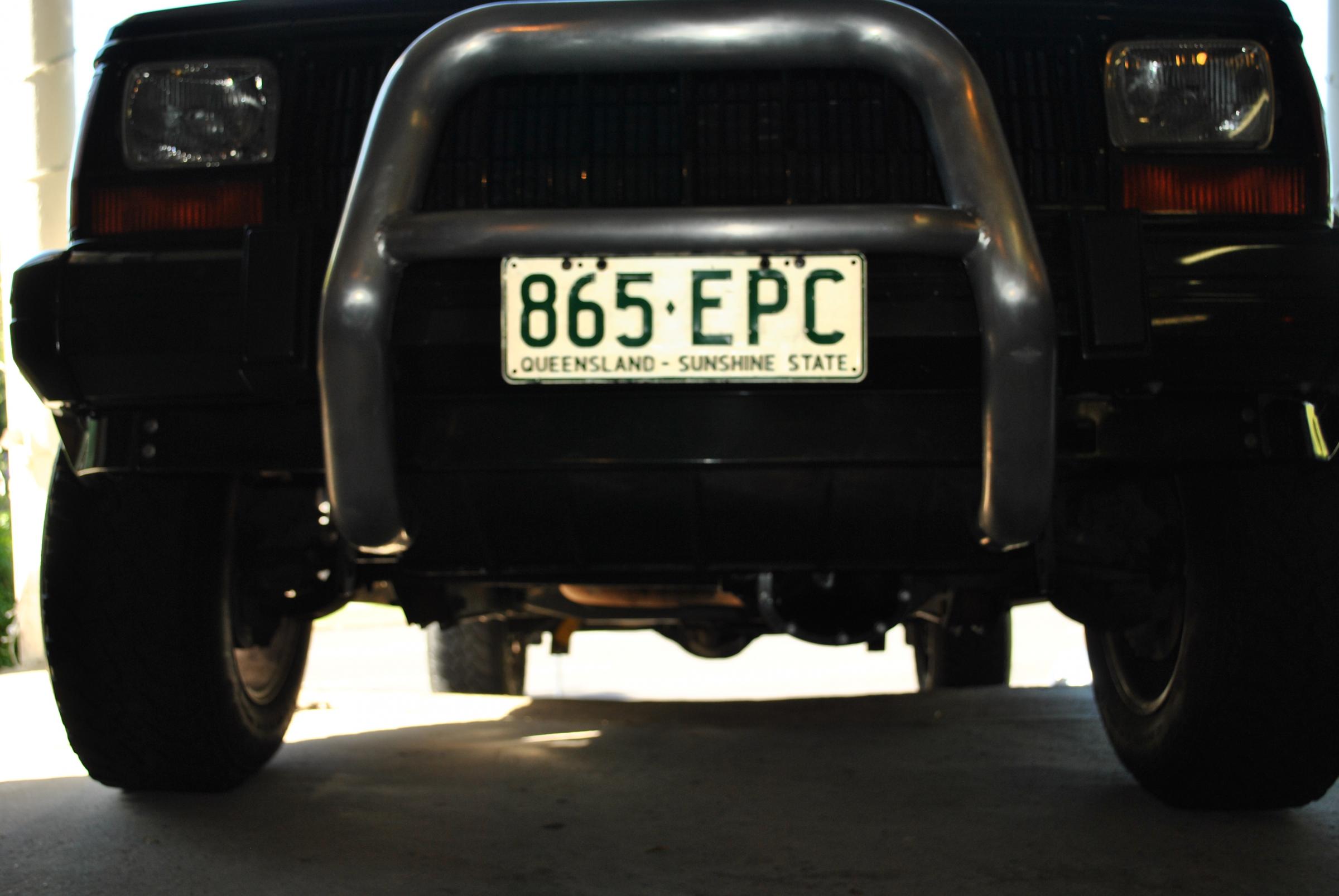

1995 XJ Cherokee LTD-dsc_9442.jpg1995 XJ Cherokee LTD-dsc_9443.jpg1995 XJ Cherokee LTD-dsc_9444.jpg1995 XJ Cherokee LTD-dsc_9463.jpg1995 XJ Cherokee LTD-dsc_9464.jpg

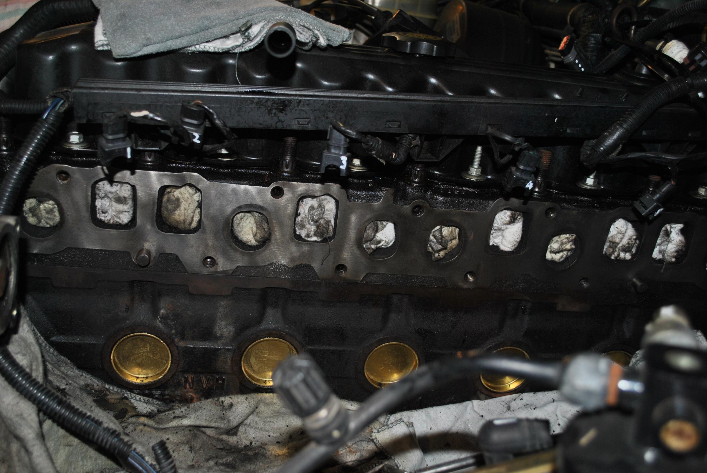

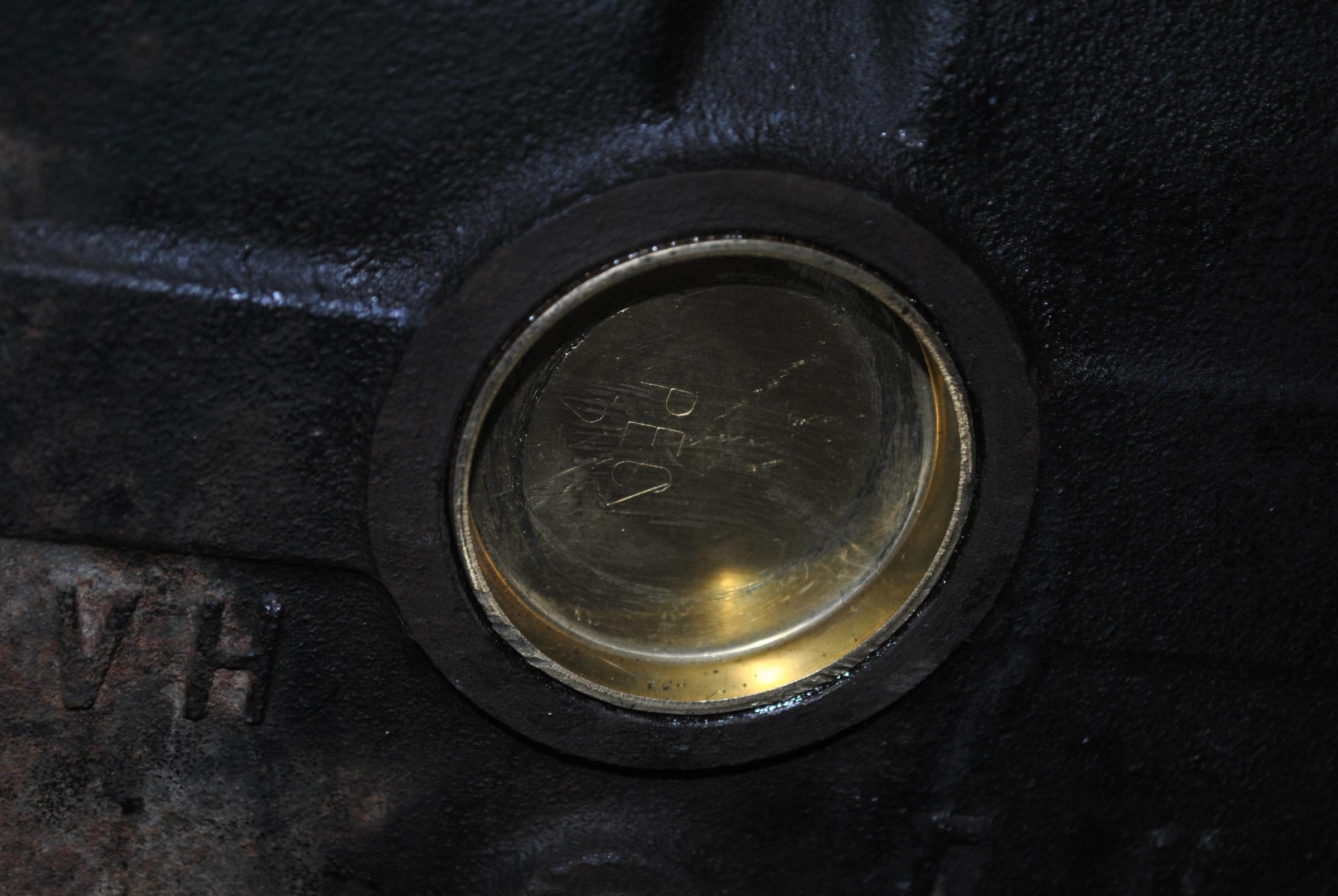

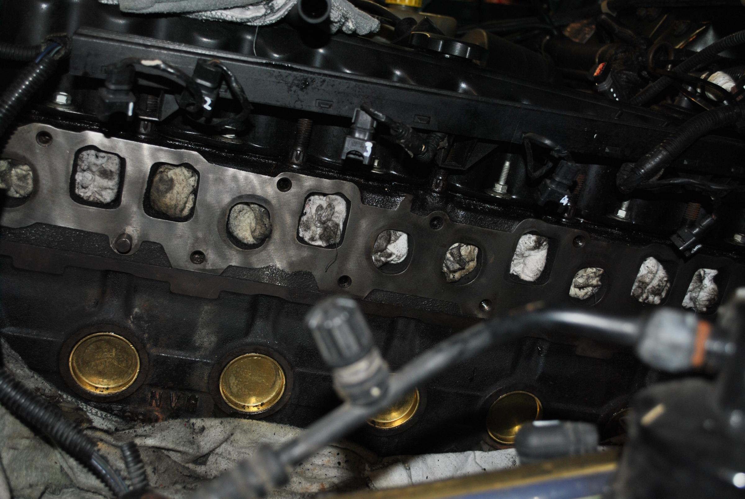

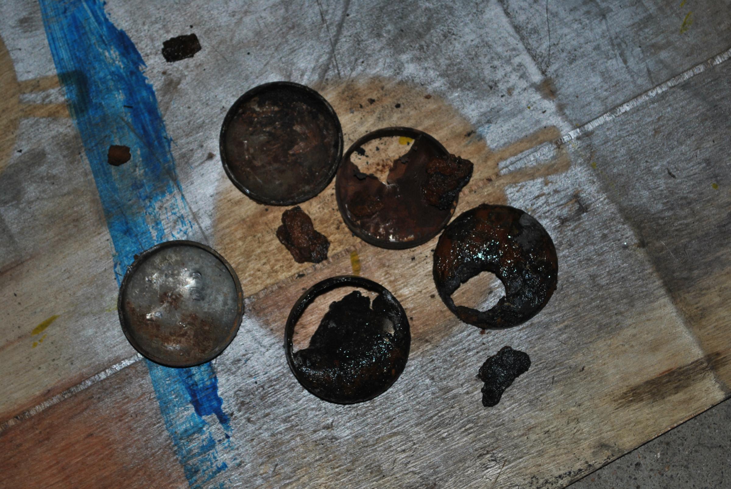

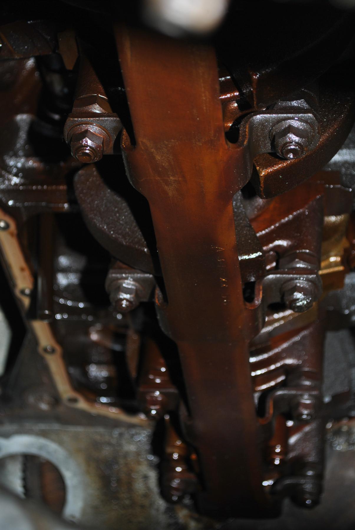

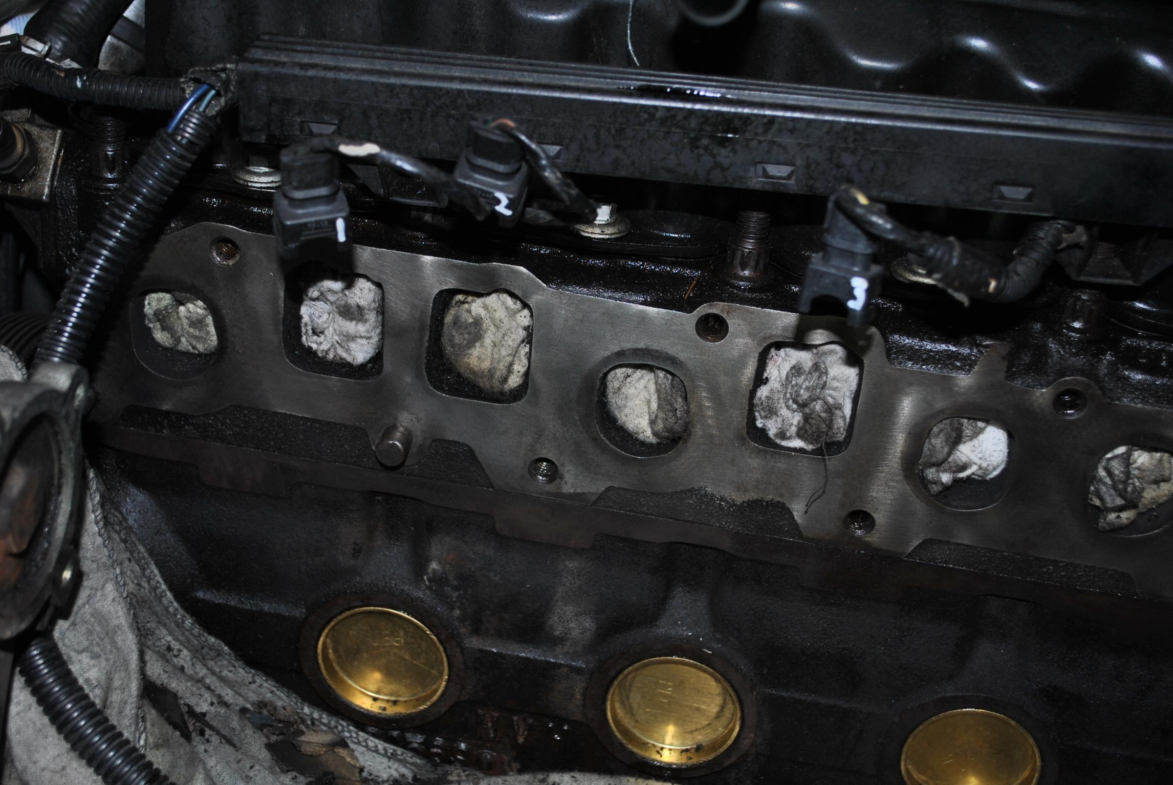

Default No wonder it was losing water
1995 XJ Cherokee LTD-dsc_9479.jpg1995 XJ Cherokee LTD-dsc_9481.jpg1995 XJ Cherokee LTD-dsc_9487.jpg1995 XJ Cherokee LTD-dsc_9491.jpg1995 XJ Cherokee LTD-dsc_2445.jpg1995 XJ Cherokee LTD-dsc_9493.jpg
Old Jun 26, 2014 | 02:06 PM
Cadillac's Avatar
Posts: 11,393
Likes: 649
From: Planetarium
It's a good thing , how on earth would I dare to say anything bad for a triumphant vehicle.Top Gear's James May also uses that term to appreciate a stuff
Pukka or pucka rugby opppps not rugby it's roughly all properly constructed
Old Jun 30, 2014 | 03:37 AM
o1xjr's Avatar
Posts: 28,386
Likes: 6,340

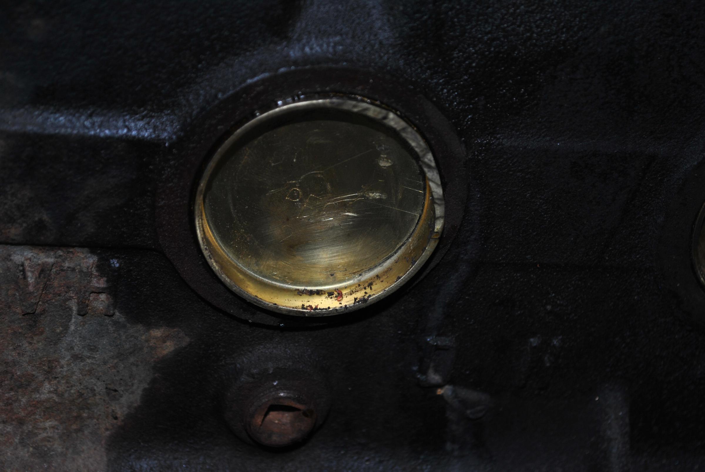

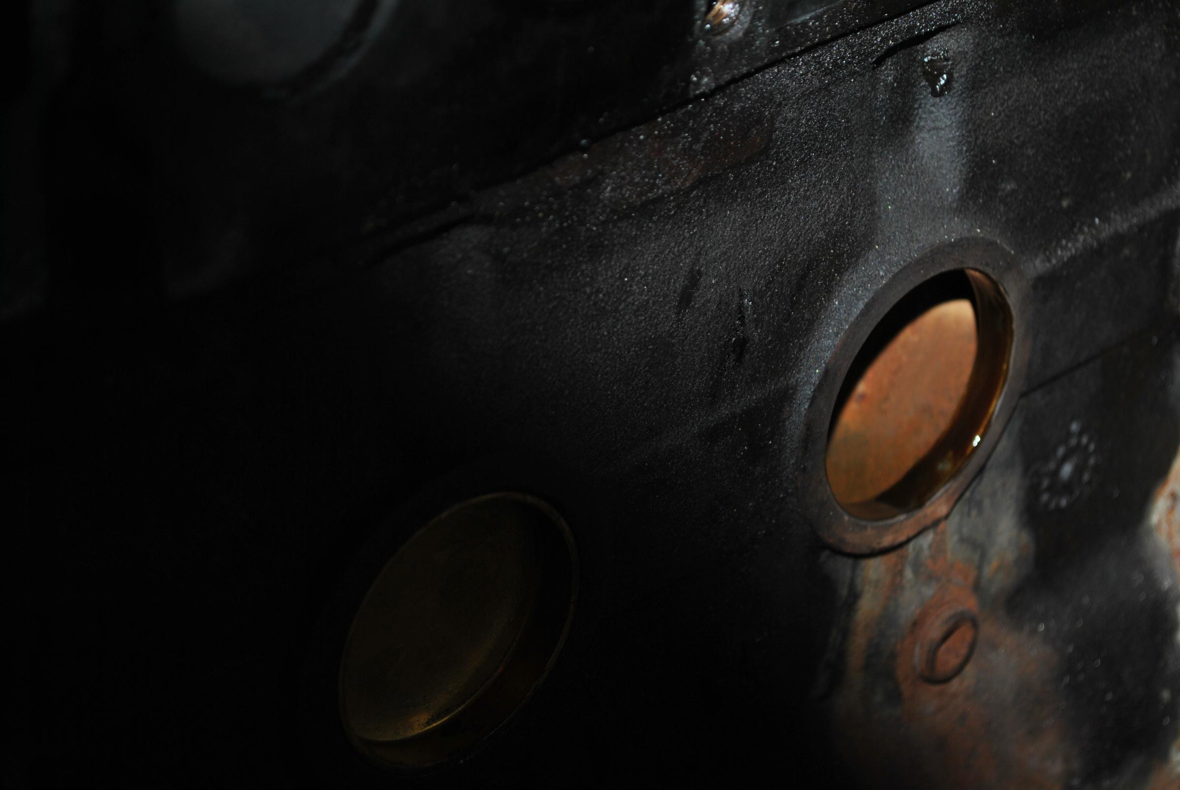

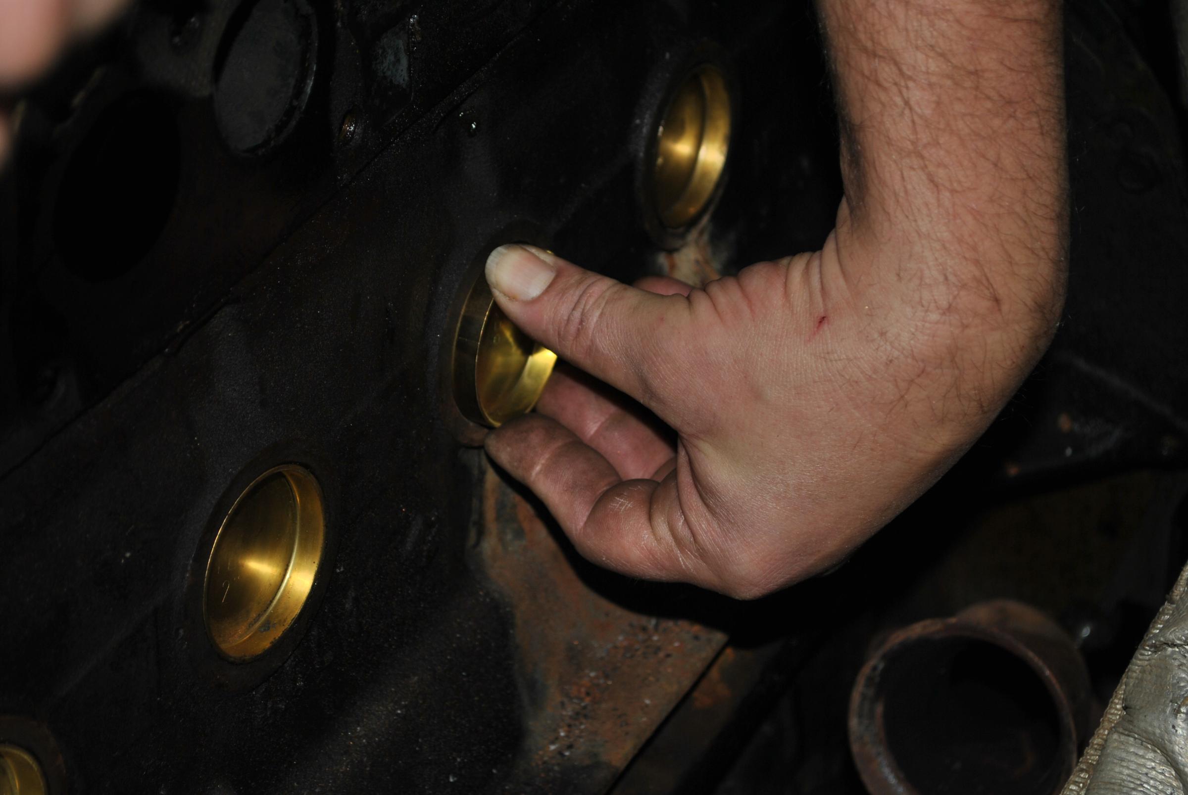

Default Attempt 1,FAIL
Well, I now know how not to fit welsh plugs. First 3 I installed I damaged. They probably would not have leaked if I knocked them in flush, but for the sake 3 bucks each I started again after a bit of google and youtube research.(lucky I bought 4 spares when I got my parts)
Preparation is the most important part of the job,and I failed to get that right.

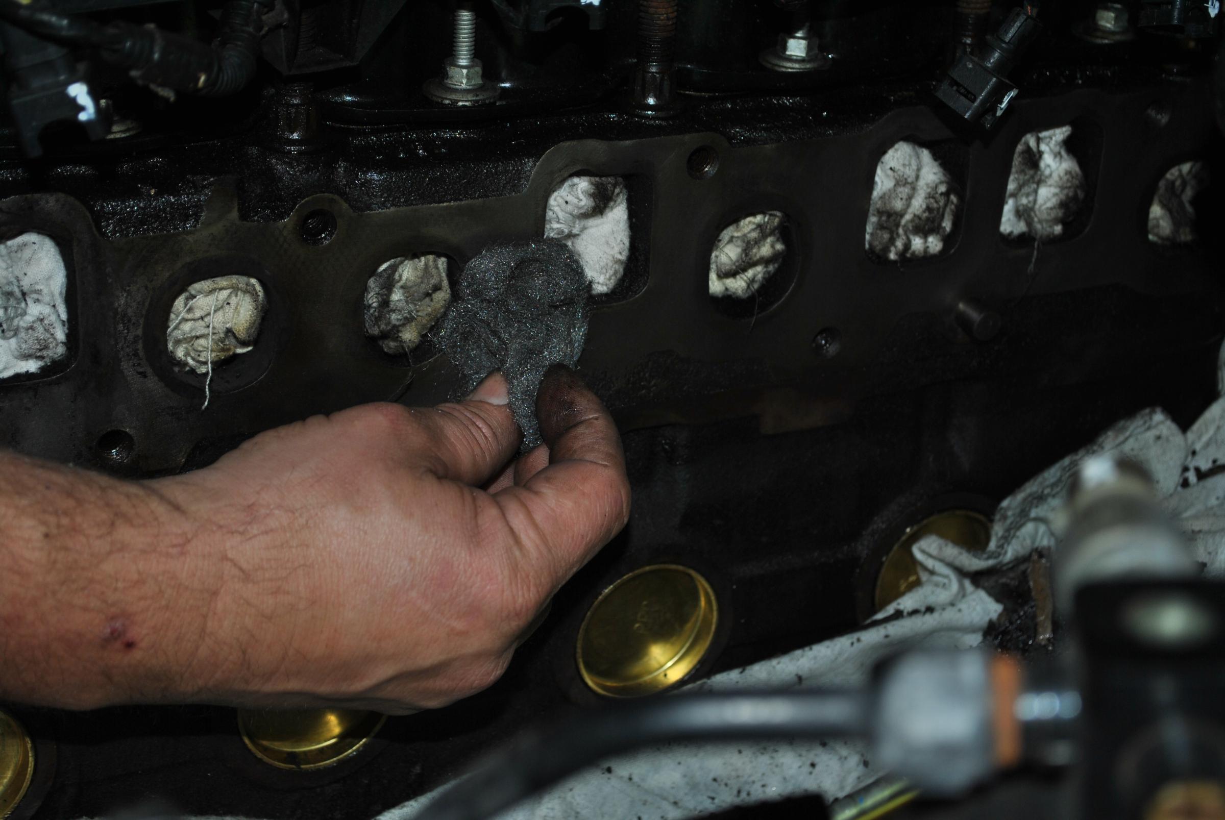

So got some emery paper and fixed the bock first ,then put the non hardening sealer on the block and not the plug(makes them so much easier to hold in place)
1995 XJ Cherokee LTD-dsc_9569.jpg1995 XJ Cherokee LTD-dsc_9570.jpg1995 XJ Cherokee LTD-dsc_9571.jpg
Make yourself comfortable on top of you engine,and have a helper available, because when your 4x4 is up on 18" stands it is not that easy to get to the tools you forgot to bring with you.
Old Jun 30, 2014 | 05:49 AM
o1xjr's Avatar
Posts: 28,386
Likes: 6,340

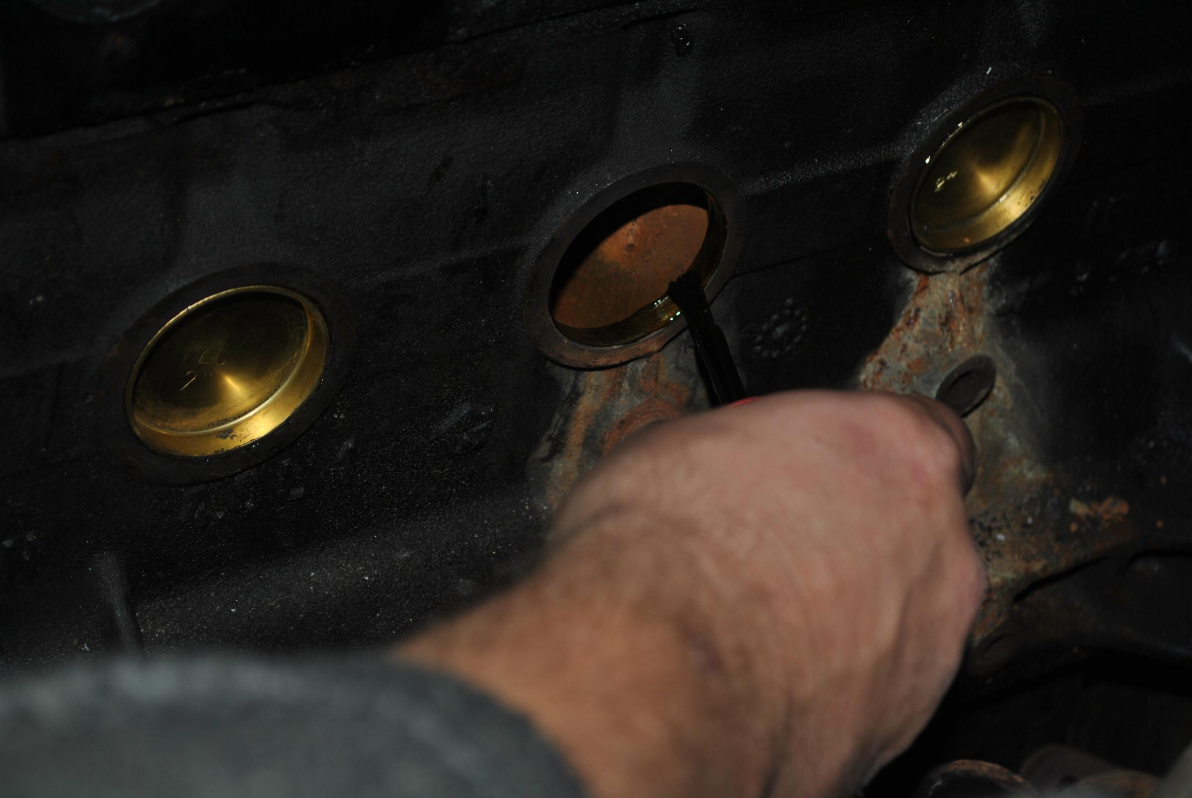

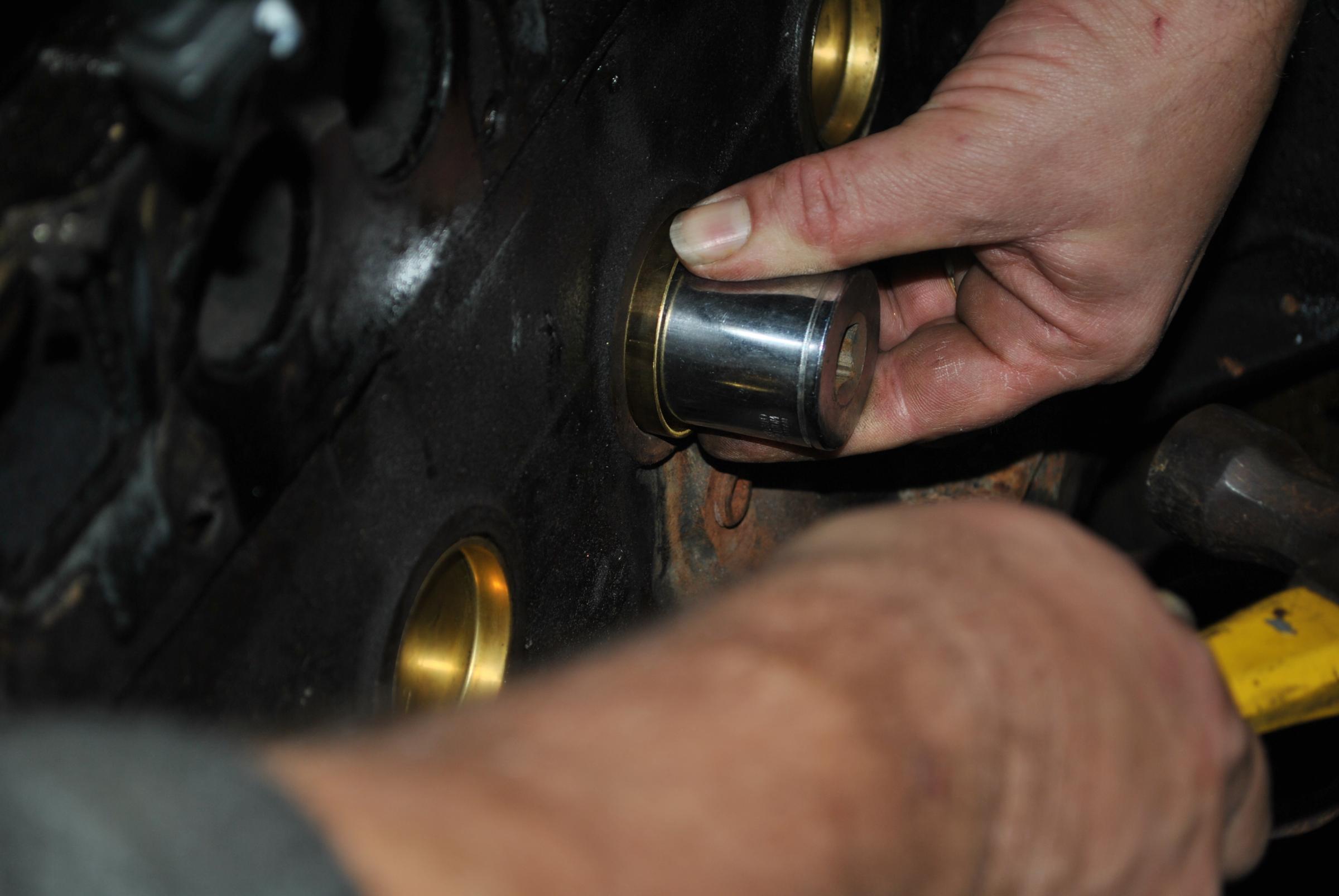

Default Attempt 2
This time backed up with fresh youtube knowledge I had a second go.
Place the plugs square in the hole in the block then insert the biggest socket you can fit inside the plug and tap it gently until it has started to go in straight,then give it a few decent whacks with the hammer.
The next step is my own idea,
Once it is about half way in,cut yourself(or find) a small piece of 1/2" steel plate to place over the plug then drive it in with the hammer.(using the plate you are gauranteed to get the plug seated flush to the block)
1995 XJ Cherokee LTD-dsc_9574.jpg1995 XJ Cherokee LTD-dsc_9575.jpg1995 XJ Cherokee LTD-dsc_9576.jpg1995 XJ Cherokee LTD-dsc_9579.jpg1995 XJ Cherokee LTD-dsc_9580.jpg1995 XJ Cherokee LTD-dsc_9581.jpg1995 XJ Cherokee LTD-dsc_9582.jpg

I'm prepping intake/exhaust ports on head for refitting manifolds between posts tonight....playing with my truck.
1995 XJ Cherokee LTD-dsc_9584.jpg1995 XJ Cherokee LTD-dsc_9585.jpg1995 XJ Cherokee LTD-dsc_9588.jpg1995 XJ Cherokee LTD-dsc_9592.jpg1995 XJ Cherokee LTD-dsc_9597.jpg1995 XJ Cherokee LTD-dsc_9600.jpg

Clarke, it's no wonder it was leaking coolant! They must have failed almost simultaneously! Which makes perfect sense, as they were installed simultaneously. duh!
Good job getting the plugs all back in place. Isn't YouTube wonderful? Between them and Google there's nothing that can't be fixed. Well, nothing automotive anyway.
I knew about the biggest-socket-that-will-fit trick, but I didn't know about the steel-bar-to-get-it-flush trick. Thanks for that one.
Well documented; good pictures and good commentary. A very clear explanation of what you're doing and why.
that was just something that crossed my mind while having the second attempt after destroying 3 plugs the first time. It's something we do when installing new bearings into sideframes of printing machinery to get them flush.

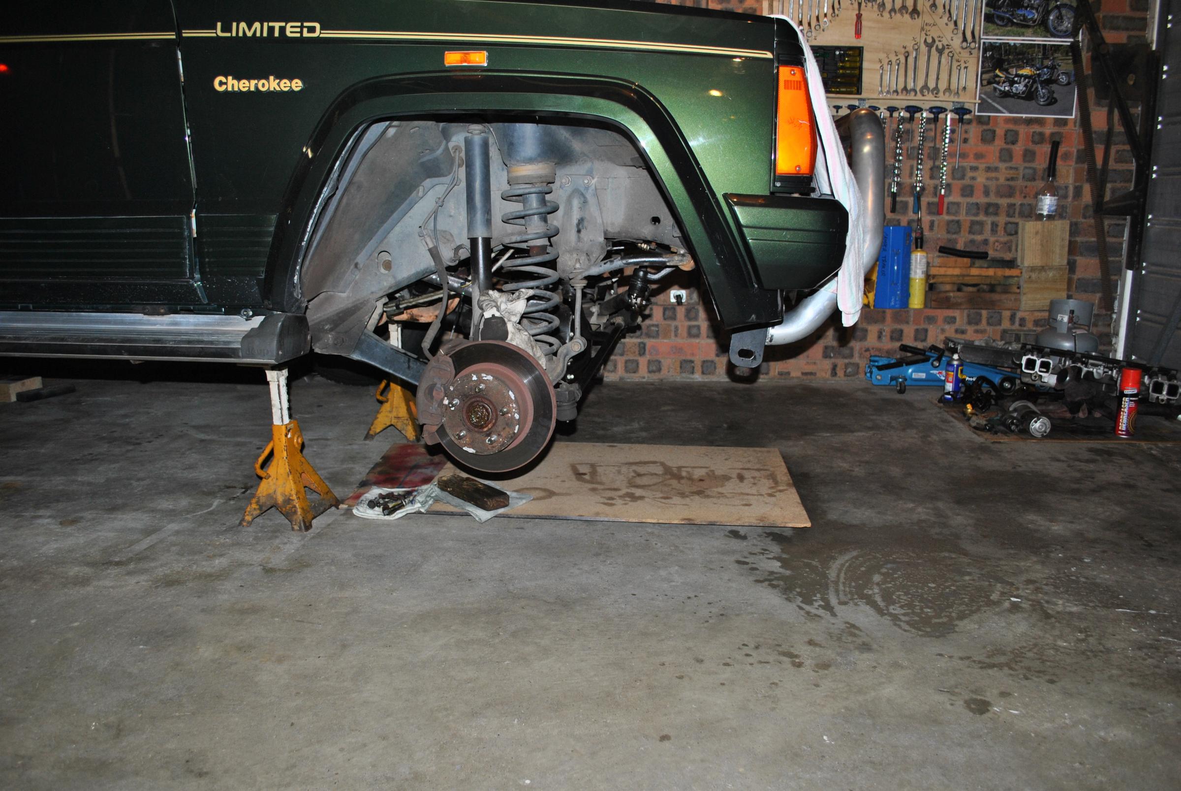

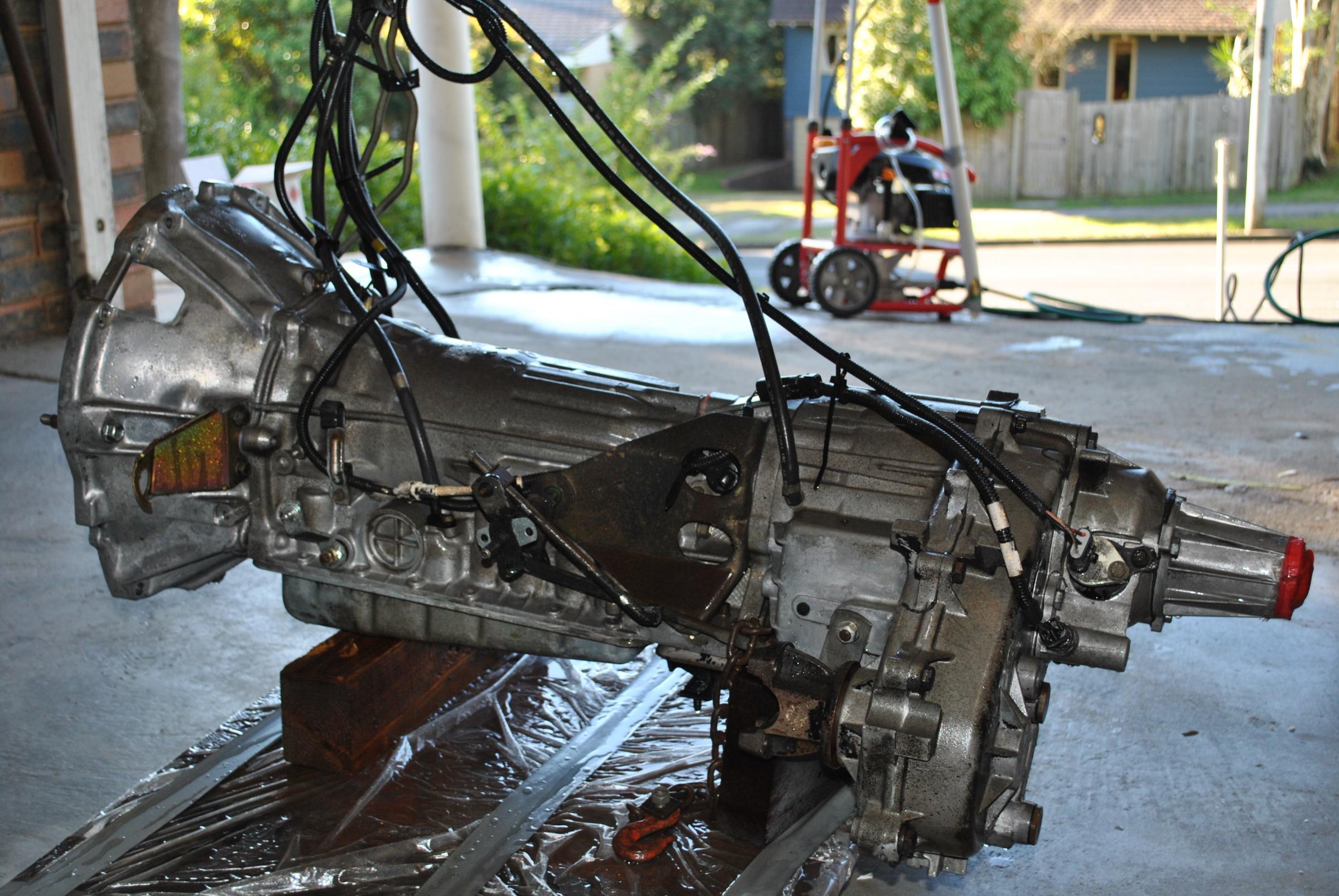

Replaced the trans less than 10'000 k's ago.With one that came from a one owner wreck that had been a grandads car all its life(never off road and 126000 km on it),and replaced chain and bearings in the transfer case while it was out.
Trans went back in today(another job I should get help with),should have done rear main first but still waiting for the seal to arrive,I can easily do seal with trans in place. Couldn't waste a day waiting for a seal,I miss driving it. Even though its only done 9000 km In the last 2 years.
Pulling sump pan off tomorrow to do oil pump and have to drop front suspension so will see what needs doing there too.
Trans doesn't even need a clean, I pressure wash under the car all the time.
1995 XJ Cherokee LTD-dsc_2445.jpg1995 XJ Cherokee LTD-dsc_8009.jpg1995 XJ Cherokee LTD-dsc_8010.jpg1995 XJ Cherokee LTD-dsc_8020.jpg

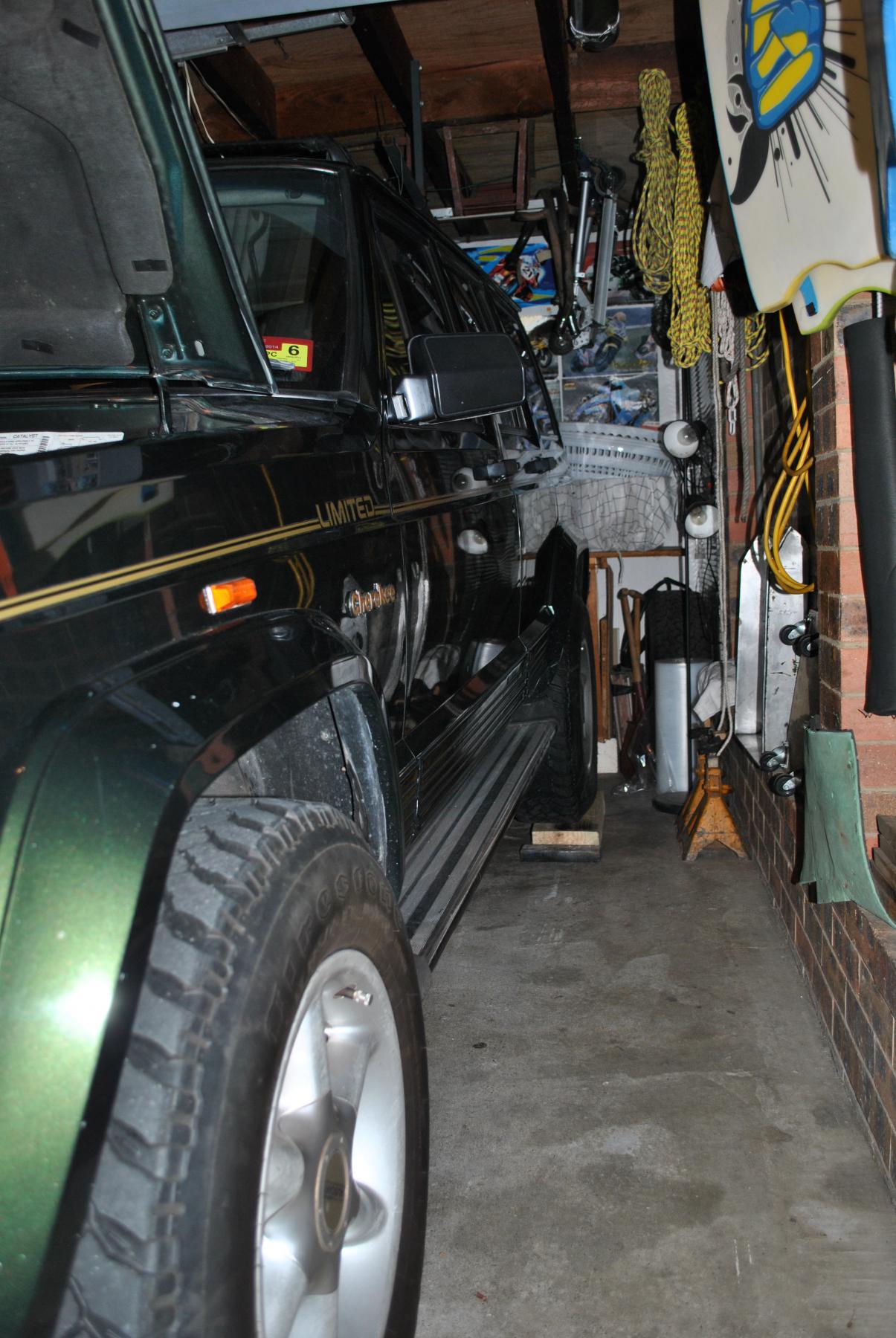

I don't know Anyone else who does that!

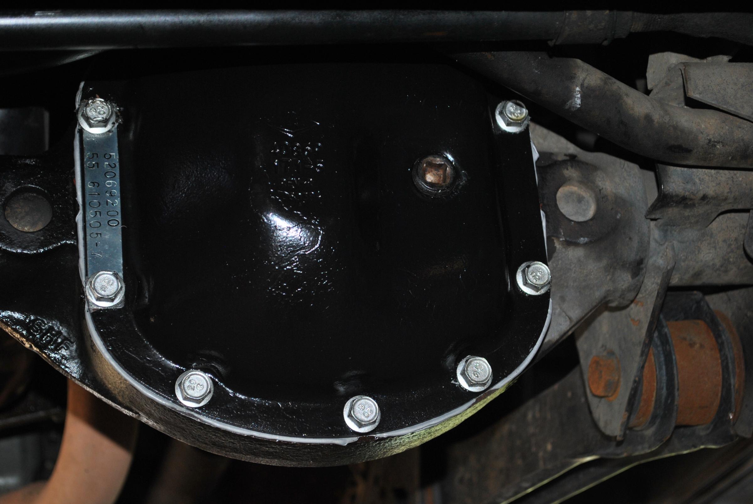

Call it ****,but you have seen pictures of it dirty. There is no mercy when I take it off road,but before and straight after the beach I take through the oil wash to get the salt off and most of the sand,then when we get home I go under with the pressure washer for an half hour or so until no more sand or mud is coming out. Then spray with Inox to get the moisture out.
I like to have a clean car to work on instead of all the crap falling in your eyes and being black up to the armpits. My wife's Mazda3 still looks like brand new underneath(2006 my) with 117000 km. It gets the same treatment before every 5000km oil change and service.

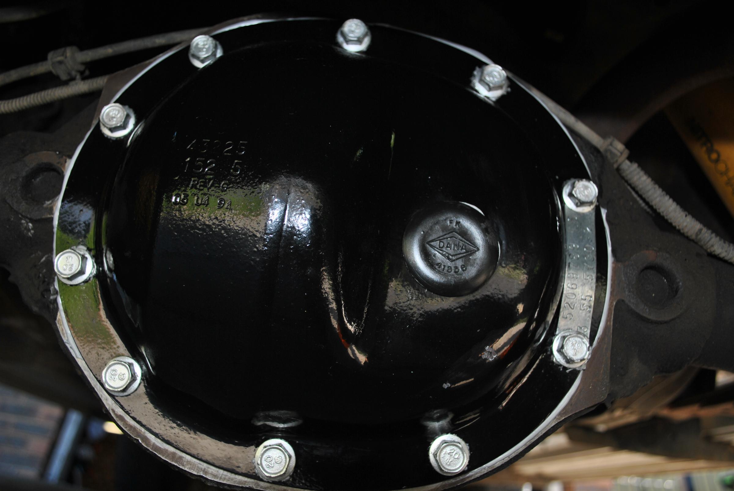

These pics were taken at the 115000 service. And this cat has never been garaged,always on the street.
1995 XJ Cherokee LTD-dsc_8795.jpg1995 XJ Cherokee LTD-dsc_8791.jpg1995 XJ Cherokee LTD-dsc_8793.jpg
Jeep is all set for rear main seal,oil pump rebuild,front main seal,oil filter adapter orings. Took 4 hours to get sump off and out over axel. Really should have left trans out to do this,I could have just slid sump straight back. Got to wait for next day off to do more.
