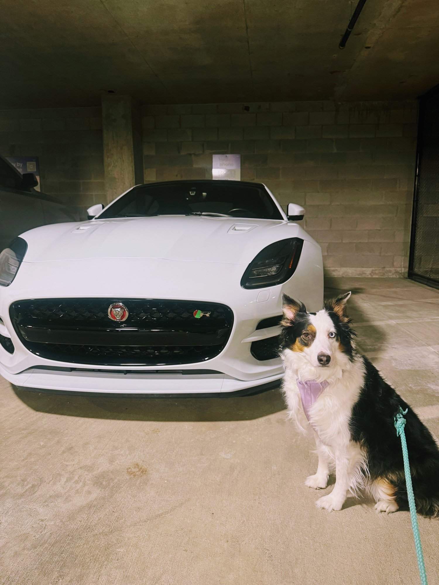

Started noticing vertical scratches on both windows today 🥲 I did some research and saw that this was a common problem years ago. Apart from getting the window seal replaced, which if you’ve had it done out of warranty let me know how much it was, does anyone have any tips in preventing/cleaning rocks and debris being stuck in the windows? Thanks! Obligatory pic of the JAAAAAAG

And I think your dog is asking if it’s his turn to drive yet.
