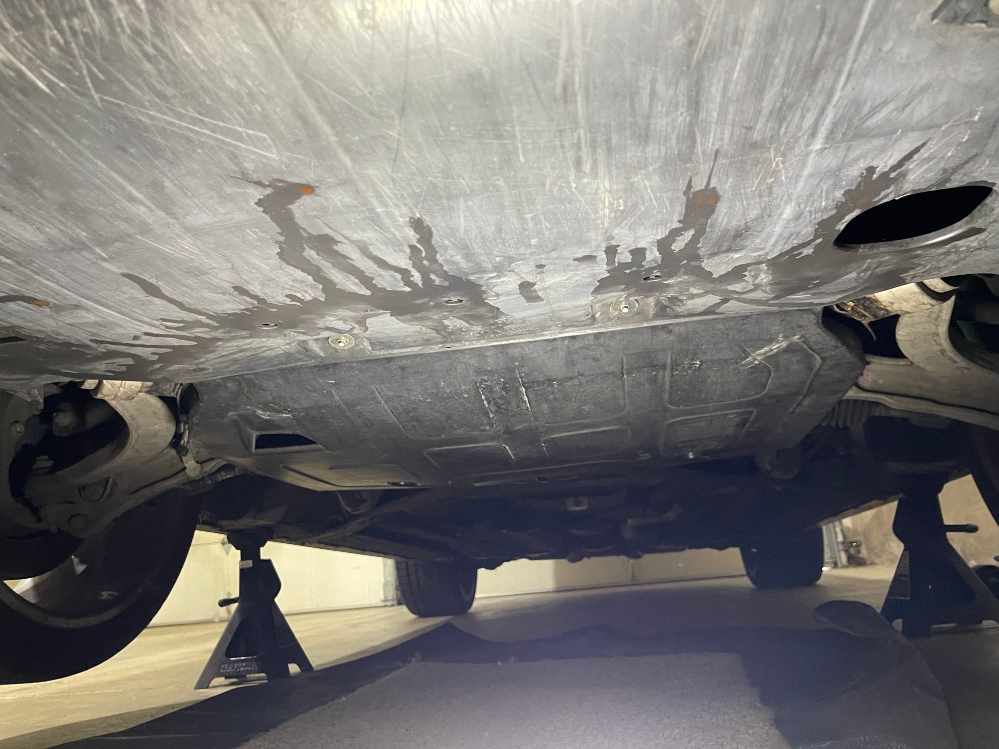

So as you know, had a cracked nipple in the overflow reservoir.
Just had that replaced and the coolant drained/refilled and they "flushed" the radiator.
Drove her home, popped the bonnet and let her sit.
After things cooled, I removed the cap and the coolant is below the internal "max" line. So I top it off.
Leave the cap off the reservoir overnight. Next morning, it is a cm below the max line again.
No signs from above of leaking. No drips anywhere.
Top her off once more. Leave it sitting overnight with cap off.
Today, down a cm again.
Grab a flashlight and lay on the garage floor.

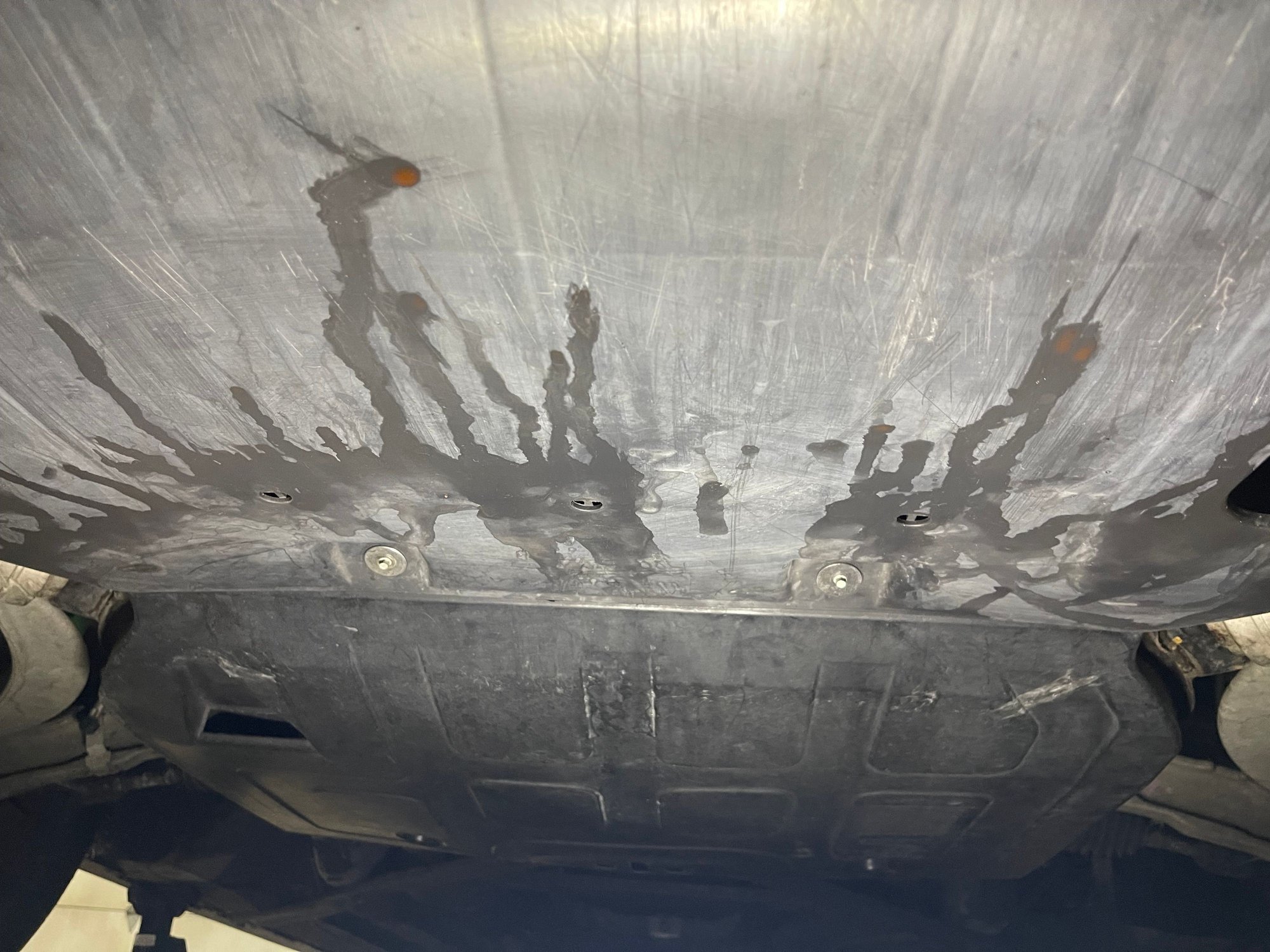

The front engine cover is wet. Ugh.

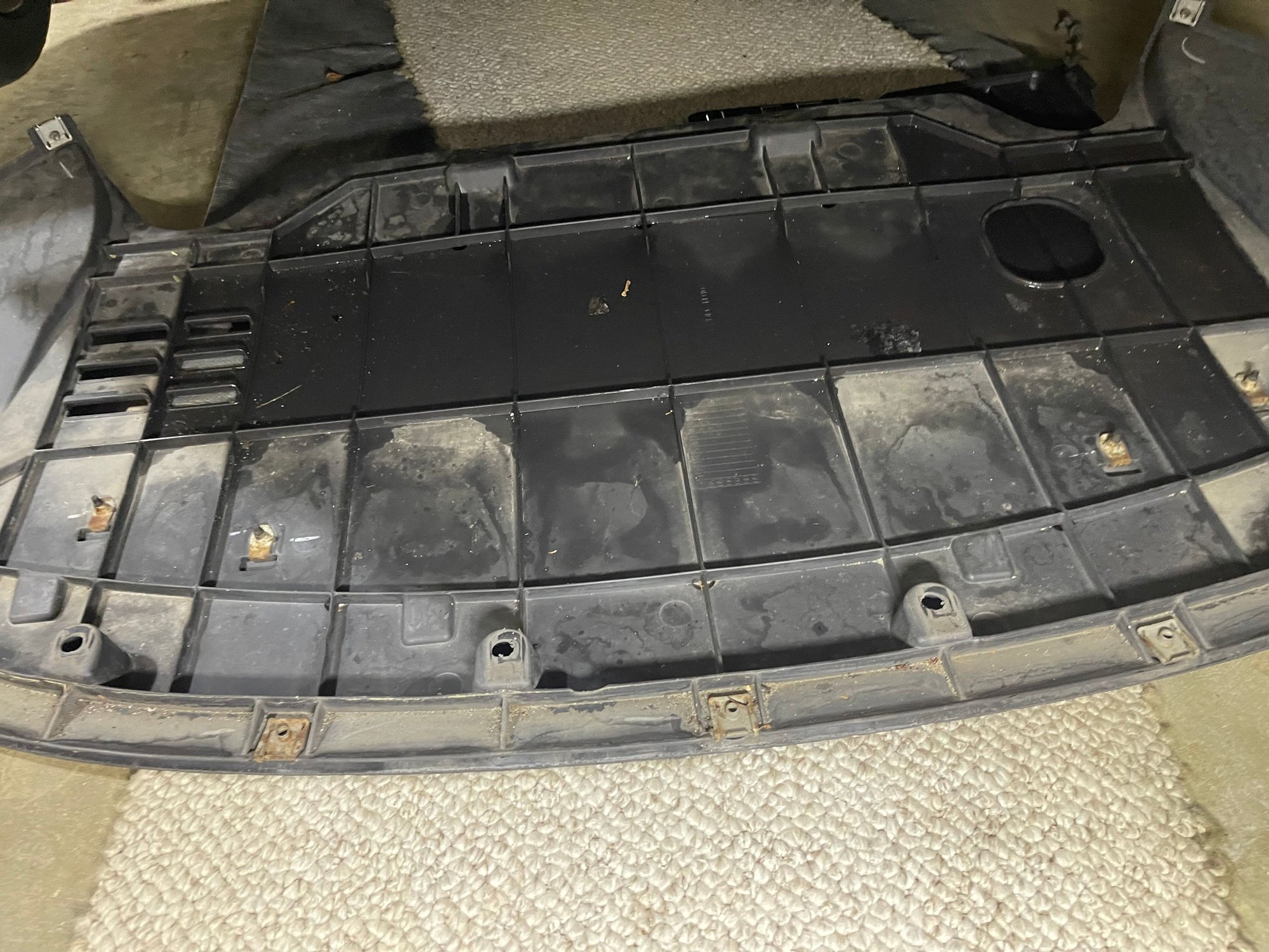

So I remove the 5,496 screws (why???) and get the cover off.
No puddle, but def wet underneath.
There is a small additional cover under the radiator.
Two screws in the front, but can't tell how it is attached along the longer rear line. So I leave it.
There is a grey spongy thing on top (where I can't see) that is poking out the sides and one side is wet.
Engine top and under cover are off. Searched every inch from top and bottom view.
No trail of tears. No drippings. couple of small droplets on the underside fan housing, but nowhere near enough to get the under pan as wet as it was.
So have two trains of thought going on.
1) Could the mess on the engine under cover be from the "flush" and they just didn't clean it?
2) Could flushing a radiator old enough to vote cause problems which would result in my reservoir level dropping a cm overnight?
I called them and they said best thing to do is bring it in for a smoke test.
But while I have that annoying to remove cover off, I'd like to see what you guys think before I put it back. (I cleaned it)
Adding pics:

If the level in the expansion tank keeps dropping that quickly, I'm sure that there must be a leak somewhere. If you use a torch to look down into the V and at the top of the bellhousing. If there is any pink, I would suspect the valley hose. However, it looks as if the leak is further towards the front of the car so the water pump is a likely candidate.

You can buy a cheap pressure testing kit which will pressurise the cooling system and then, with all the undertrays off, you will surely see where the coolant is running down once it is under pressure if it's not obvious when it's not pressurised.

For now I cleaned up the under engine cover (rear smaller one was clean).

As I have mentioned before, "a flush" is not a standard jaguar methodology unless the coolant change interval was not followed. Just drain and fill. Of course, in days gone by, there would have been deposits that were flushed out. Highly irregular now.
Also, that is a wet mess. And as you are losing a cm a day, That is concerning as the you let the engine come to room temperature.
I'd be hopeful the shop wouldn't leave a mess like that. Actually, I would have cleaned the whole engine bay.
My apologies @Circumnavigator , I don't recall if your car is supercharged. If so, the supercharger coolant path is higher than the reservoir. If you have an air pocket in there...
Button it all up tight and go for a drive. When the engine is hot, raise the bonnet and give it a whiff??

Seems like there were small black bits in the coolant on top of the under engine cover when I cleaned it.
Not a ton. Few bits. Very small. Could be from anything.
