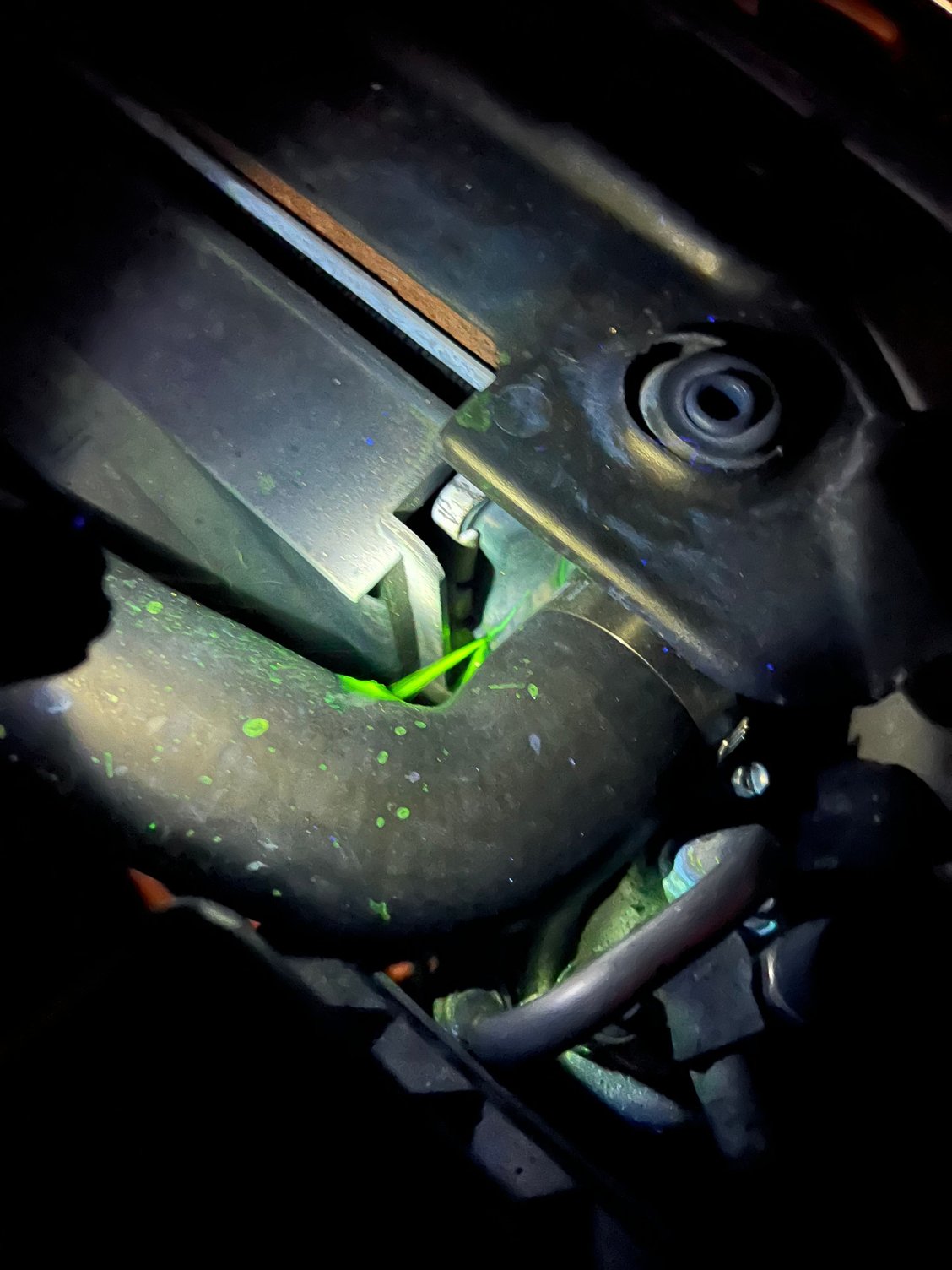

Replaced all heater hoses because of leak in valley. Drove for past ten days. Low coolant warning today and found cracked radiator. Seems too much coincidence so thinking faulty cap and ordering new one along with new radiator.

Those plastic side tanks can crack if you look at them too hard.
And the Nissen replacement radiators won’t keep your engine as cool as the original radiator did. Mine runs 10-15 degrees hotter with the Nissen radiator.
Not surprised by that, as a forum search I did before my Nissen purchase revealed posts that said to expect that. The fin count on the Nissen radiator is not up to the OEM standards.
The jury is out as too whether I’ll keep the Nissen or go with a used original radiator when summer is in full swing and I can see how hot is my new “normal”.

The problem is a leaking rad - nothing to do with the cap, but no actual harm in replacing it.

Old Apr 4, 2025 | 07:10 AM
pcolapacker's Avatar
Joined: Apr 2021
Posts: 1,210
Likes: 479
From: Pensacola, FL
Point was possibility of bad cap not releasing to atmospheric tank causing valley hose and then radiator.
Just a theory but cap $9.

Old Apr 4, 2025 | 09:07 AM
zray's Avatar
Joined: Jan 2018
Posts: 3,751
Likes: 2,343
Yes, that’s possible, but unlikely.
You were losing pressure at the valley hose. Replacing those revealed the next weakest link under full normal pressure ; ie the plastic radiator side tank. Leaking plastic side tanks are evidence of the weak design. Jaguar is not alone in using them and suffering the consequences.
Z
