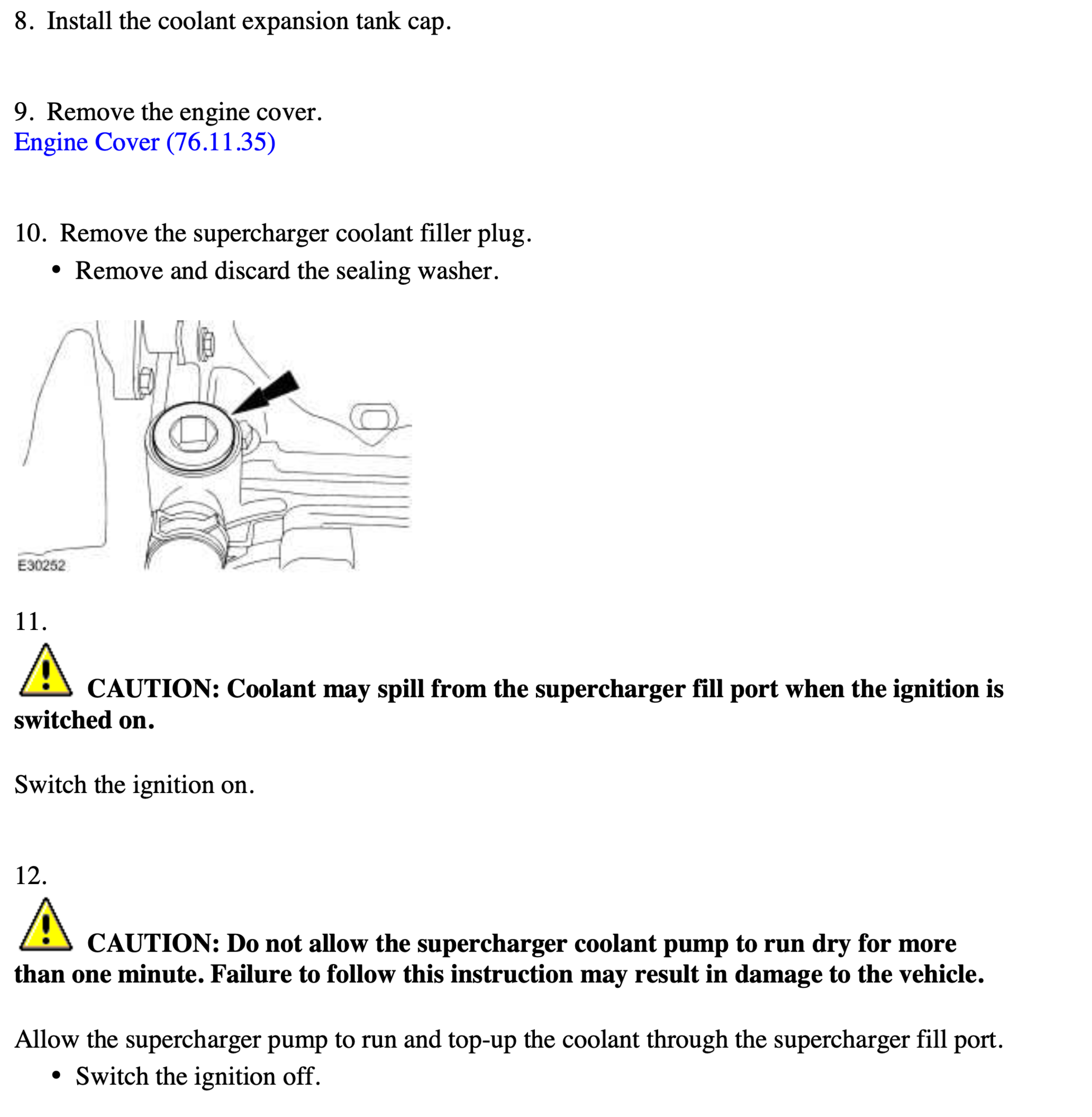

As I have mentioned before, "a flush" is not a standard jaguar methodology unless the coolant change interval was not followed. Just drain and fill. Of course, in days gone by, there would have been deposits that were flushed out. Highly irregular now.
Also, that is a wet mess. And as you are losing a cm a day, That is concerning as the you let the engine come to room temperature.
I'd be hopeful the shop wouldn't leave a mess like that. Actually, I would have cleaned the whole engine bay.
My apologies @Circumnavigator , I don't recall if your car is supercharged. If so, the supercharger coolant path is higher than the reservoir. If you have an air pocket in there...
Button it all up tight and go for a drive. When the engine is hot, raise the bonnet and give it a whiff??

The reason I provided the docs... you MUST confirm no air lock in the supercharger.
The pressure method of filling is through the supercharger. The pour method, explains the need to vent at the supercharger, then top up at the supercharger.

Just to avoid misinterpretation from them to me to the forums, here is what they said in an email prior to the work:
”Coolant is drained and refilled, and fluid is flushed through the radiator & heater core. They are referring to a "power flush" which can damage plastic components.
The supercharger is lubricated with oil, not coolant. There is an auxiliary water pump that uses antifreeze to cool, but not lubricate. The cooling system will be properly filled and bled.”
