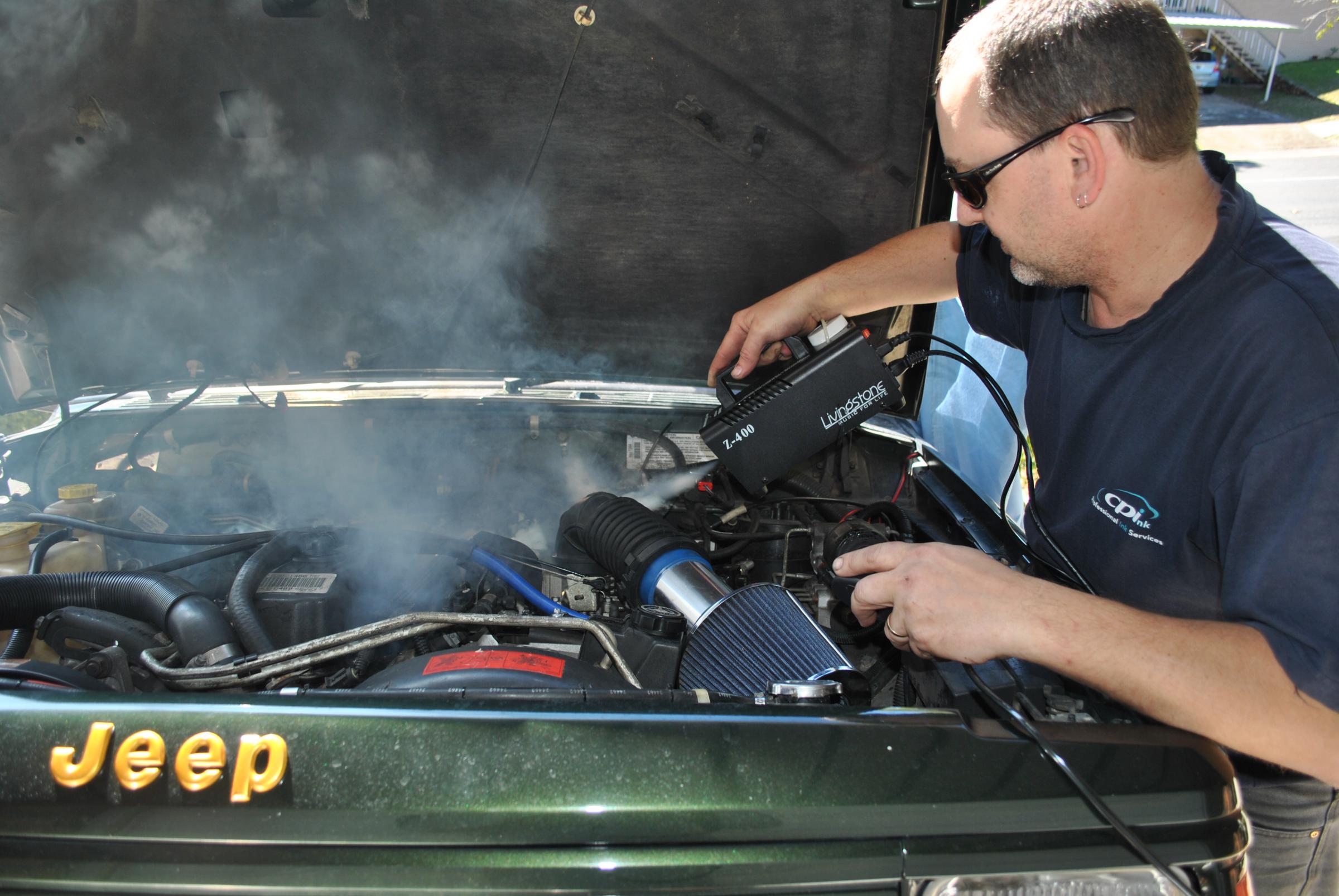

Just this week I have developed an idle issue. A bit suspect it is only 2 weeks after removing fuel rail and intake manifold.
17 years and 220,000 km,first issue in this dept. On cold start up idle is jumping to 1500 rpm(usually 1000=1200)and dropping to 800 after about 15 seconds,in drive around 800 also. Drives perfect,but if you blip the throttle at the lights it jumps to around 1200 then slowly drops back to the normal 800 and will hold there as long as you want,but touch that peddle and it takes about 10-15 seconds to slowly drop back to 800rpm.
So I thought maybe a bad connection to the TPS sensor or IAC valve from my putting it back together,but after a check all seems good there.
Next step maybe a vacuum leak,could nor hear one with the stethoscope. So had to resort to the old smoking the engine procedure. No sign of vacuum leaks that way either.
End result,.Not a biggie,just annoying.
