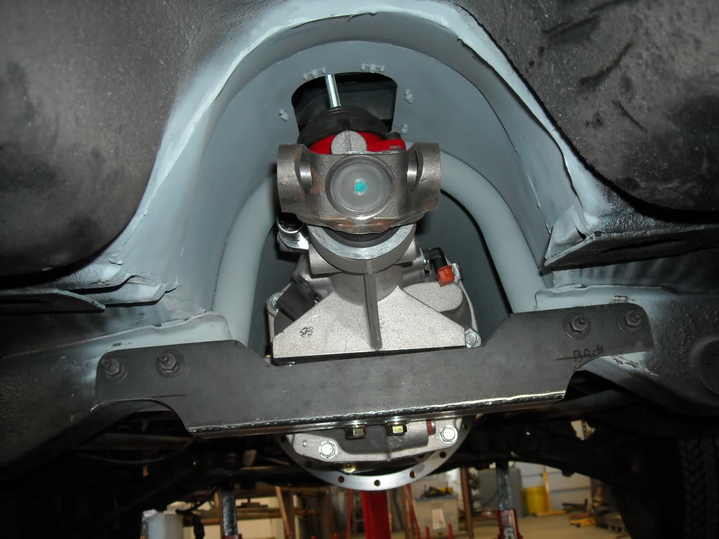

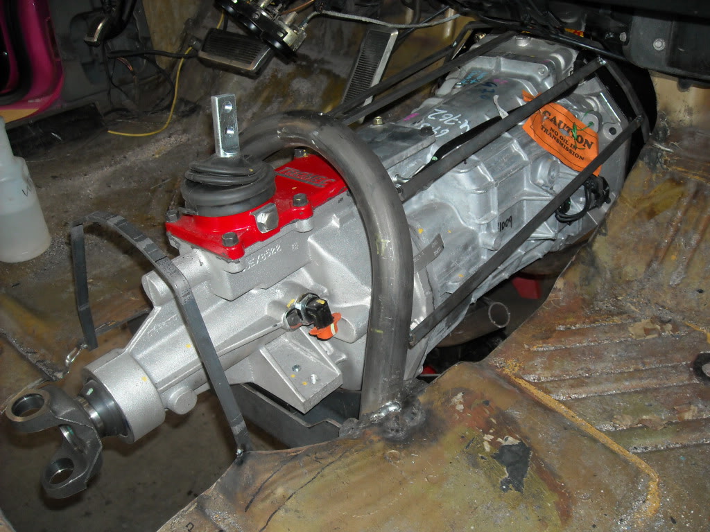

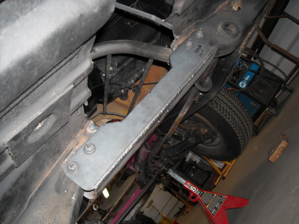

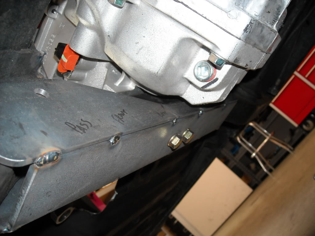

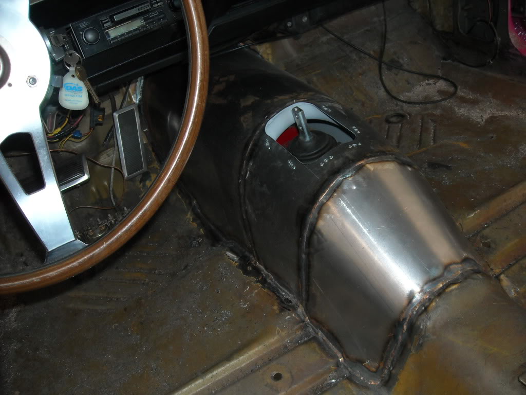

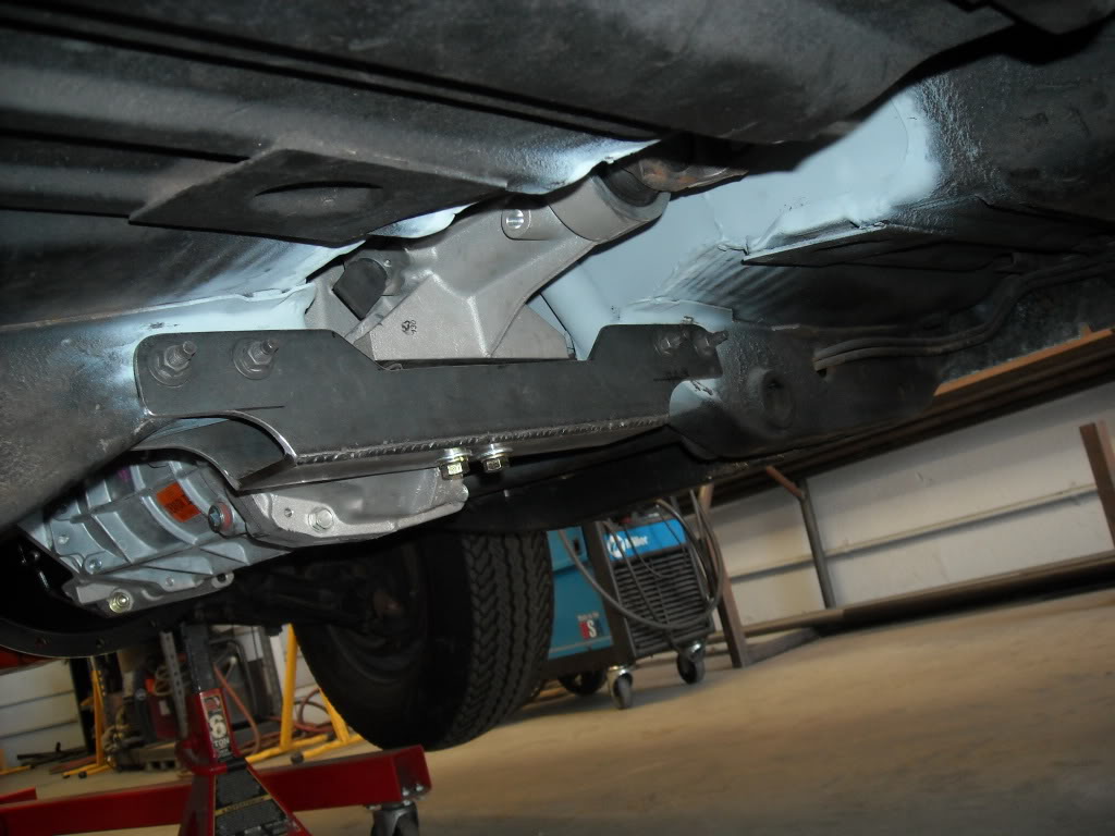

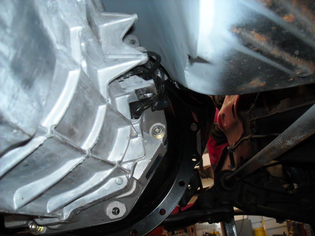

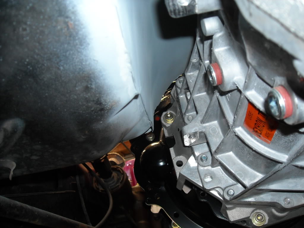

In the middle of installing a Tremec T56 6 speed into my '70 Challenger.
I intend to fully chronicle the transplant along with my low deck stroker-6 pack build at my website (in time)
www.auto-scape.com
For reference I used the Magnum TRG-11009 with tall ratio top (0.63).I'm not a drag racer- the big block Chrysler is a big engine- and the E body isnt really heavy by todays standards so I prefer tall gearing when cruising. There's alot of cutting involved and fabrication work- including cutting and re-fabricating the typical Mopar torsion bar cross member.
In the meantime here are some pictures of the progress:
