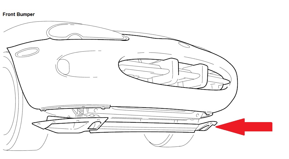

GGG Jul 2, 2013 05:27 PM
2 Attachment(s)
Originally Posted by Rocky125 (Post 763819)
I've been having fun detailing my new (to me) car and, now that I have everything squared away in the back, I have moved on to the front!
Looking up under the nose of the car .............
.......... are you missing most of the black Undertray?
Attachment 46993
It could be the angle the pic is taken, but I can only see the end of the Undertray.
Rocky125 Jul 2, 2013 10:34 PM
Jacsun: Thank you for taking the time to look under your car for me – I really appreciate it!
Paul Pavlik: Thanks for identifying the relay for me! When you say it is vertically mounted on your car, how is it mounted? That is, is it attached with a clip, some sort of bracket or rubber sleeve or bellows?
I know I’m being silly in not just zip tying it securely to something but I kind of want to have it mounted as it originally was.
GGG: Wow, good eye - I didn’t even know I was supposed to have a black undertray! I’ll look at my car more closely later tonight and compare it to the picture you sent. It could well be broken or missing as there are a few scrapes on the bottom of the bumper cover (but fortunately nothing else looks scraped up on the bottom of the car).

As far as the black undertray, I do have one. It is just kind of small and I did not recall seeing it but after looking at the diagram supplied by GGG and climbing under the car, it is there after all!
