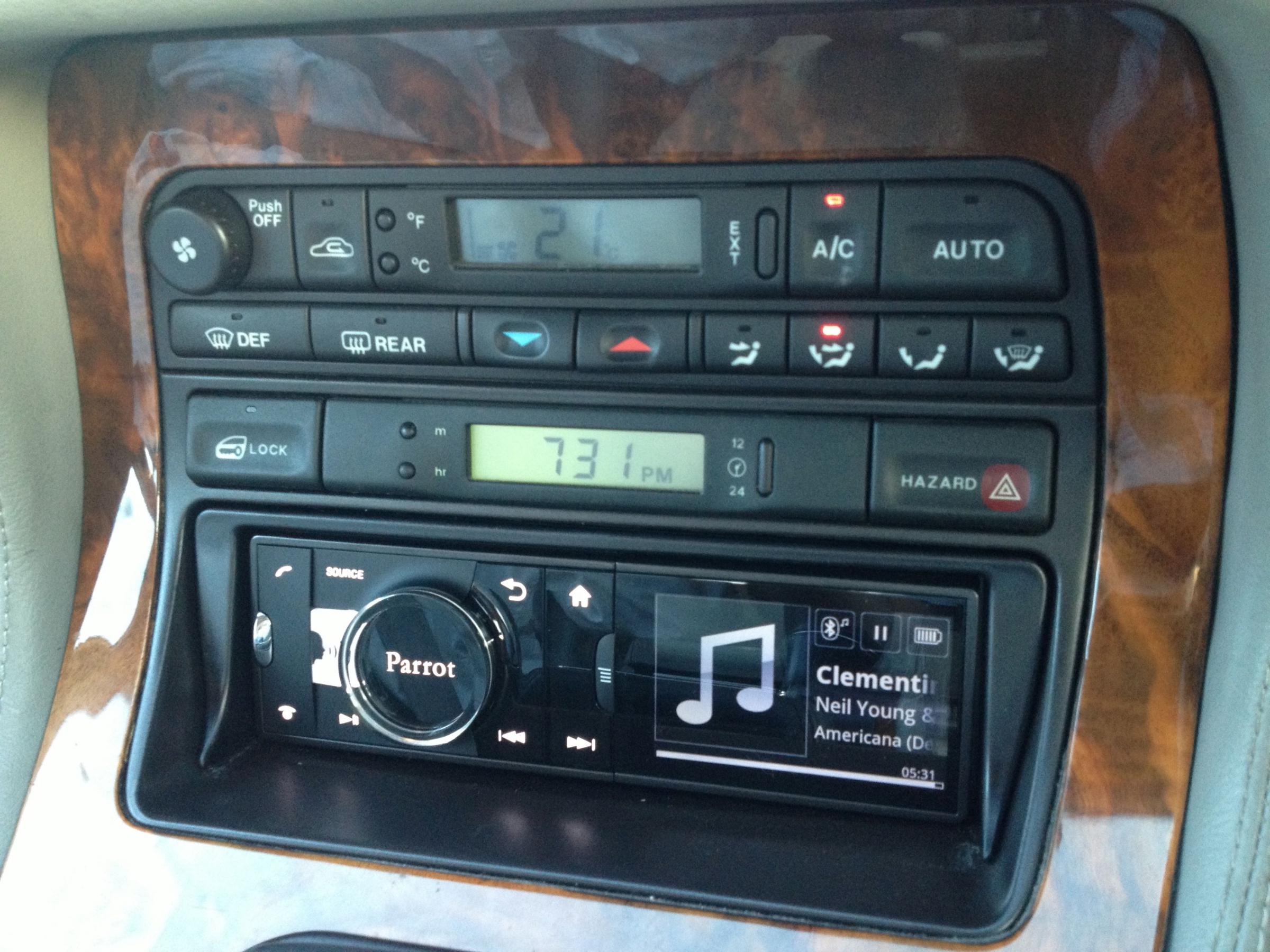

I bought an X300 Daimler 6 with non-premium sound - a tape deck/radio, CD changer, and 4 worn-out door speakers
I bought a Parrot Asteroid Classic and I am very happy with it - it does handsfree phone calls and dialling, plus you can tell it what music artist you want and it finds it (if the iphone is plugged in). So works for me.
There is an adapter fascia surround to make it look the part - this is cheap.
