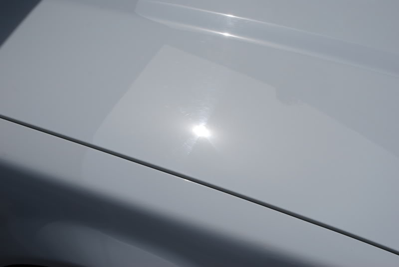

Hood 50/50 photo after 1 pass with my rotary and a Megs W8006 w/M105, what a difference!

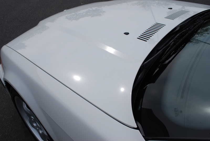

Hood completely corrected with M205 and ready for LSP w/M21

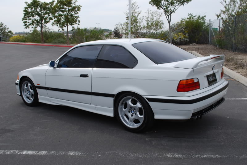

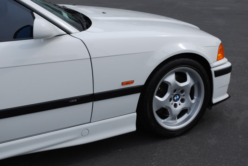

Completed photos after thorough paint correction, she looked flawless for her age of 11 years!
