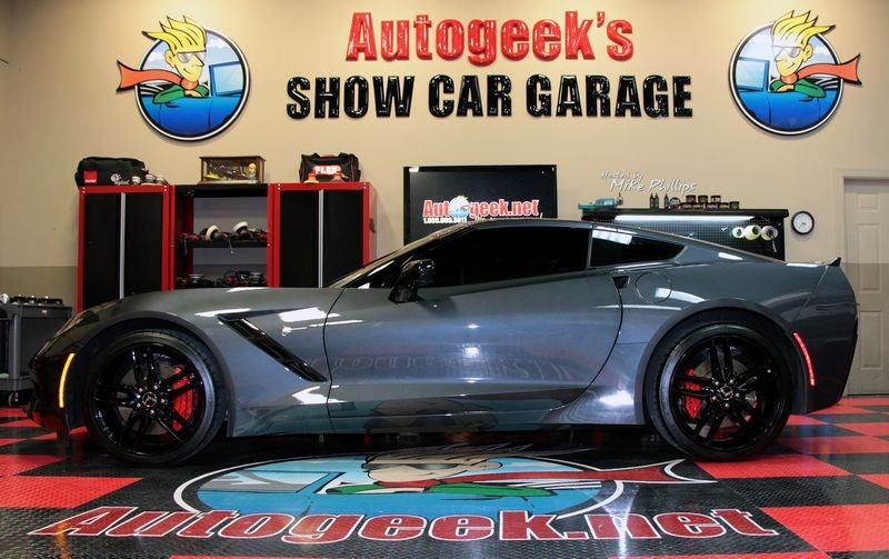

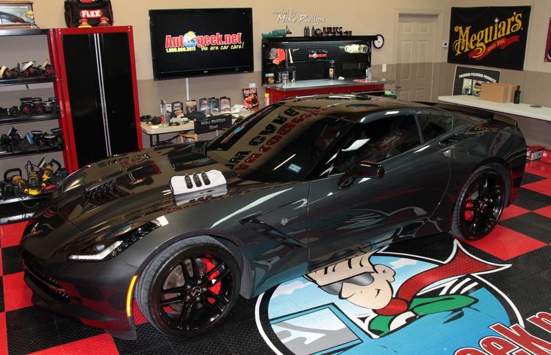

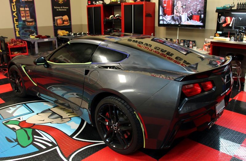

Here's a few pictures from this project...
Taping off Trim
There's some coarse or rough textured plastic trim pieces on the car as well as a few rubber gaskets that I would recommend covering with painter's tape to prevent staining them with any type of compound or polish.
Prep paint for coating
Here you can see the residue covering the car everywhere the Surface Cleansing Lotion was applied by machine. For a few of the tight ares like the fresh air intake louvers on the hood, around the tail lights in the back and the vent areas on the sides of the car.
After pictures...
Wheels & Tires
Wheels are coated with Black Label Diamond Wheel Coating. Tires have three applications of TUF Shine Tire Clearcoat.
