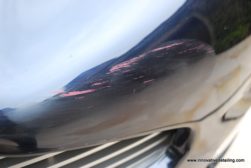

So I received a 911 emergency call last month Dec 2010 from a repeat customer that recently had a nice scrape tattooed on his Aston Martin Vanquish front bumper. The guy that backed his beat up red pick up truck from what I was told from my customer, was nobody the he wanted to ever cross paths with again. So when the driver of the truck offered to exchange info, my client got out of his vehicle, looked at the damage and replied......Have a Happy Thanksgiving, proceeded to get in his Aston and split.

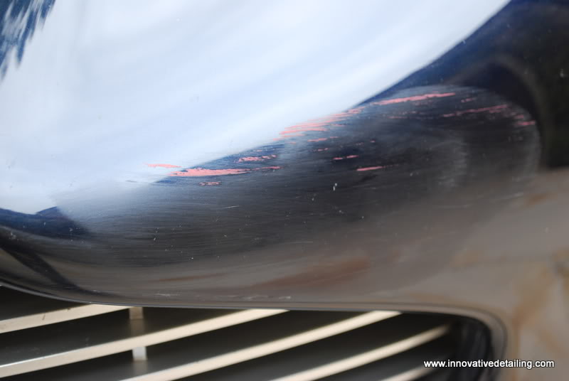

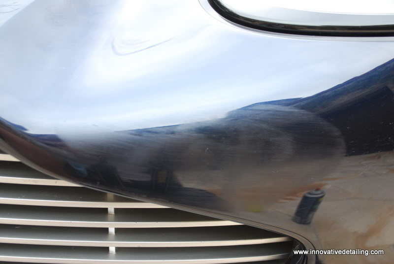

So when I arrived on Saturday morning, this is what I had to repair......

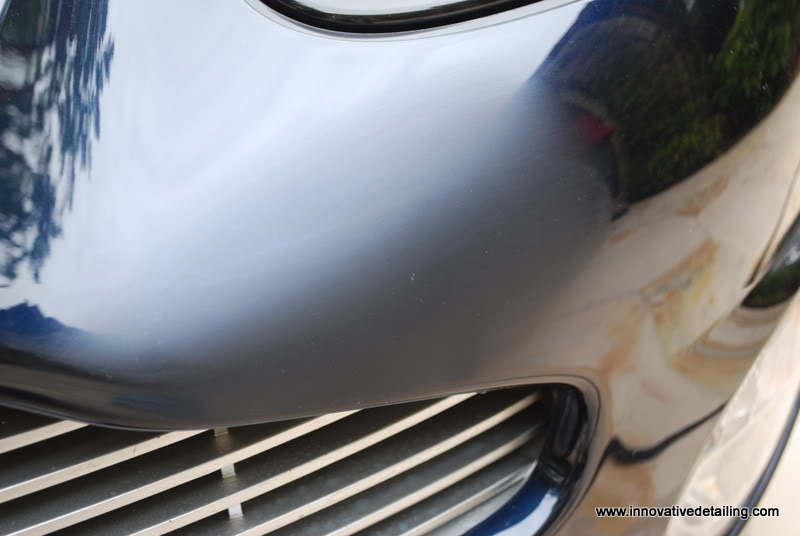

Definitely a nice scrape....

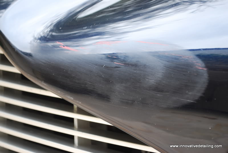

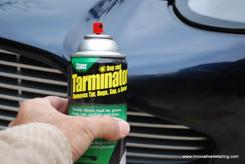

In my first step, I clean all the paint transfer thoroughly with Stoner "Tarminator"
Before chemically removing transfer
After removing paint chemically

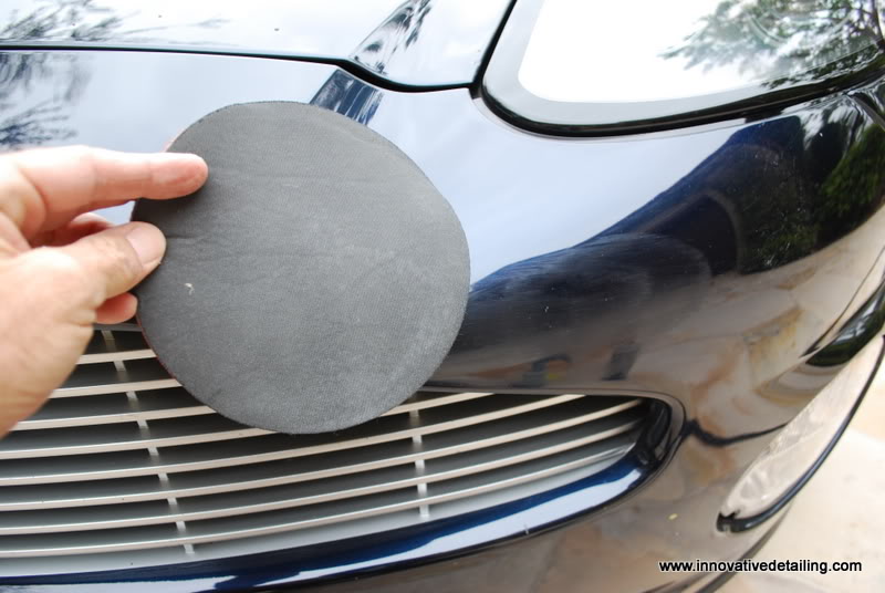

Next step was to level out all scuff marks and gauges with some wet 2000 grit Abralon
Using Mirka Abralon 2000grit by hand, I wet sanded to area smooth in preparation for the repair

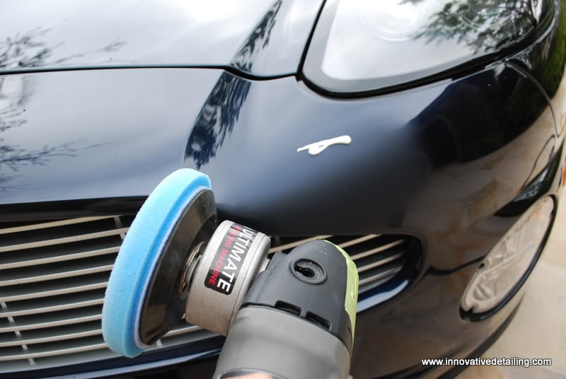

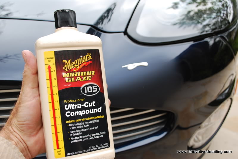

What else for the next step than Meguiar's M105

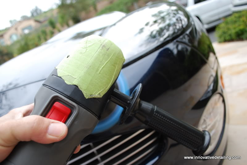

My PC 7424XP, Cyan 7/8 inch cutting pad and M105 on the repair area ready to go....

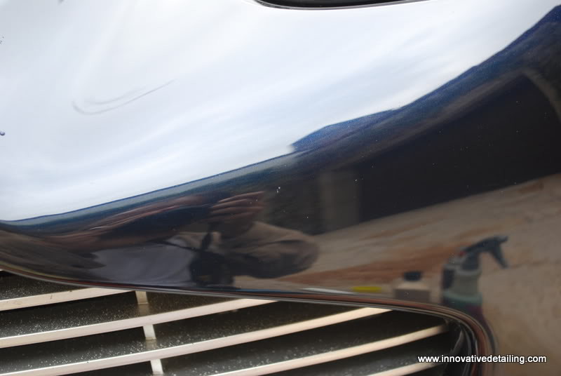

After my first pass, the damage and color sanding traces are 99% gone...No rotary polisher required for this repair

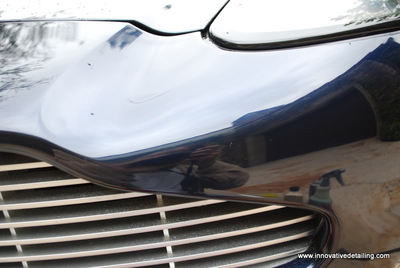

20 minutes later, this is the results.......no insurance claim, no crossing paths with some shady stranger ever again (person who hit the bumper) my customer was thrilled!

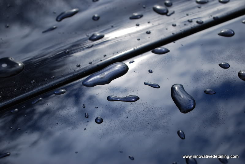

Along with the paint repair I provided my client with my "Mini Detail" service since I had detailed the vehicle about 3 months ago.
some cool water beading shots after my prep wash.......definitely well protected as you can see thanks to Poly's and my R/O water.

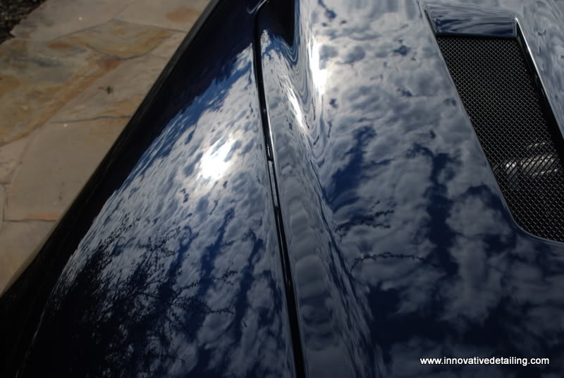

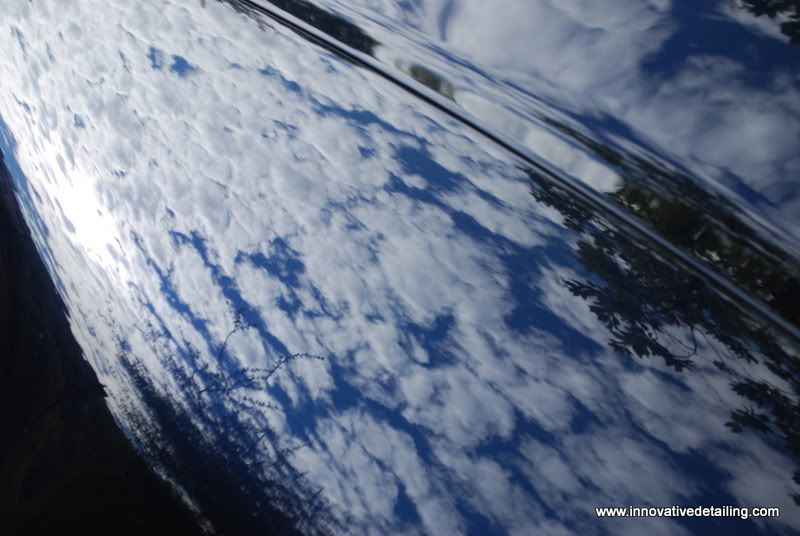

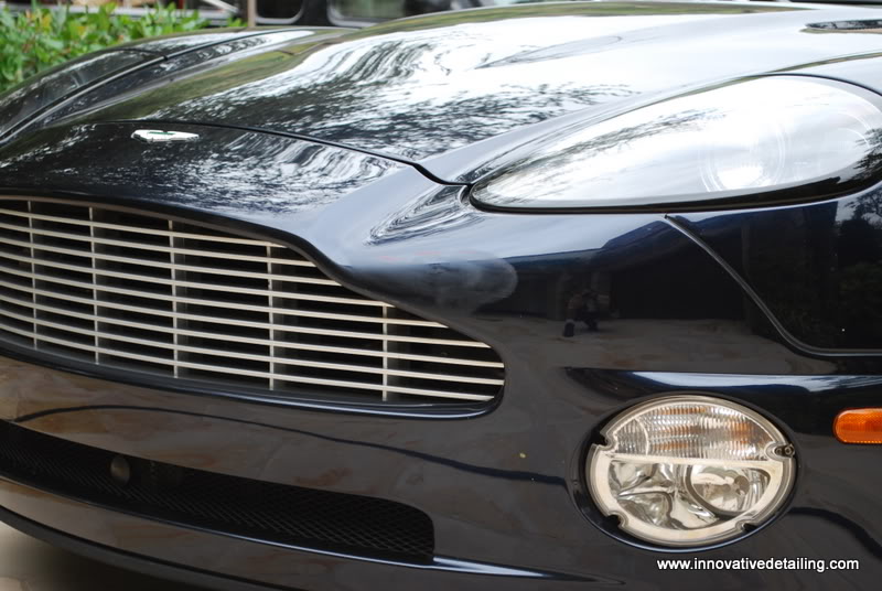

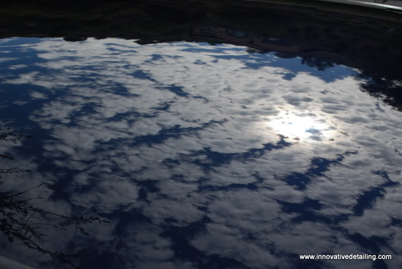

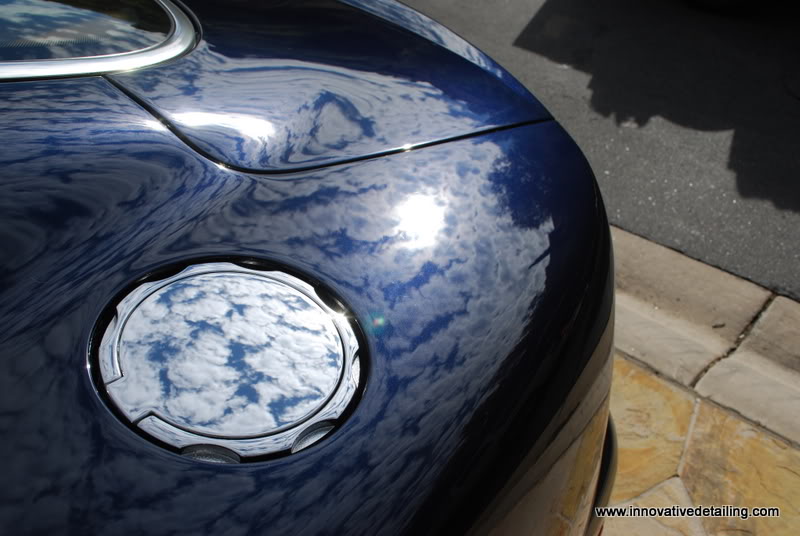

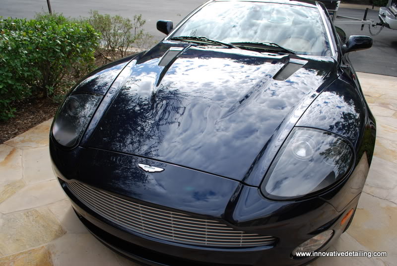

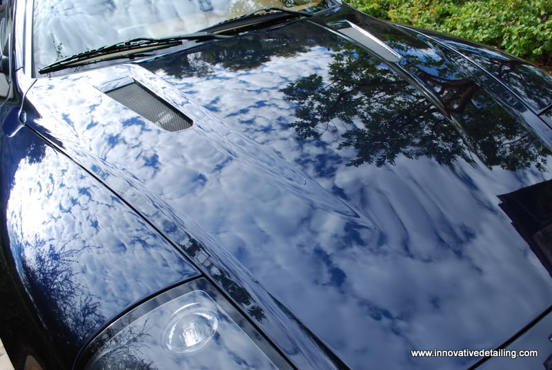

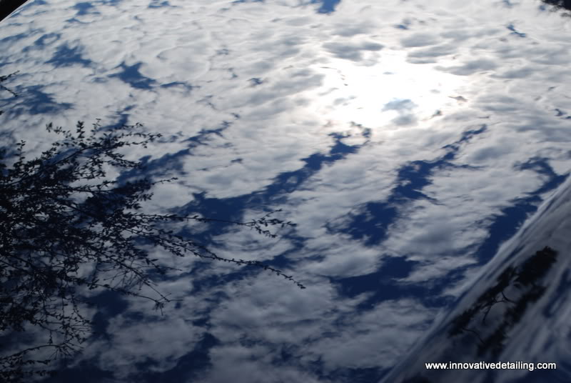

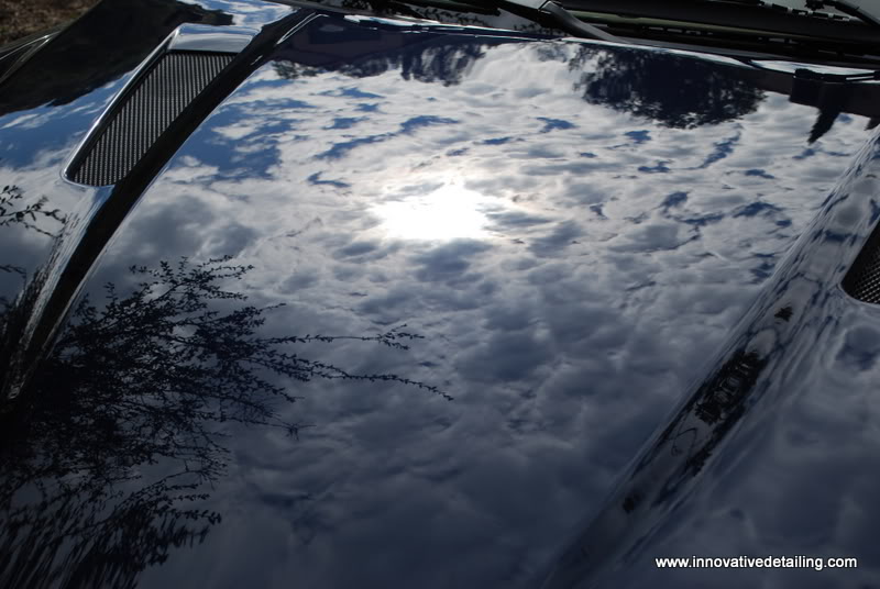

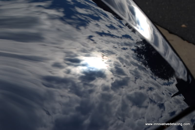

Here are some of the after shots, which hosted some awesome images of the sun and the clouds....
