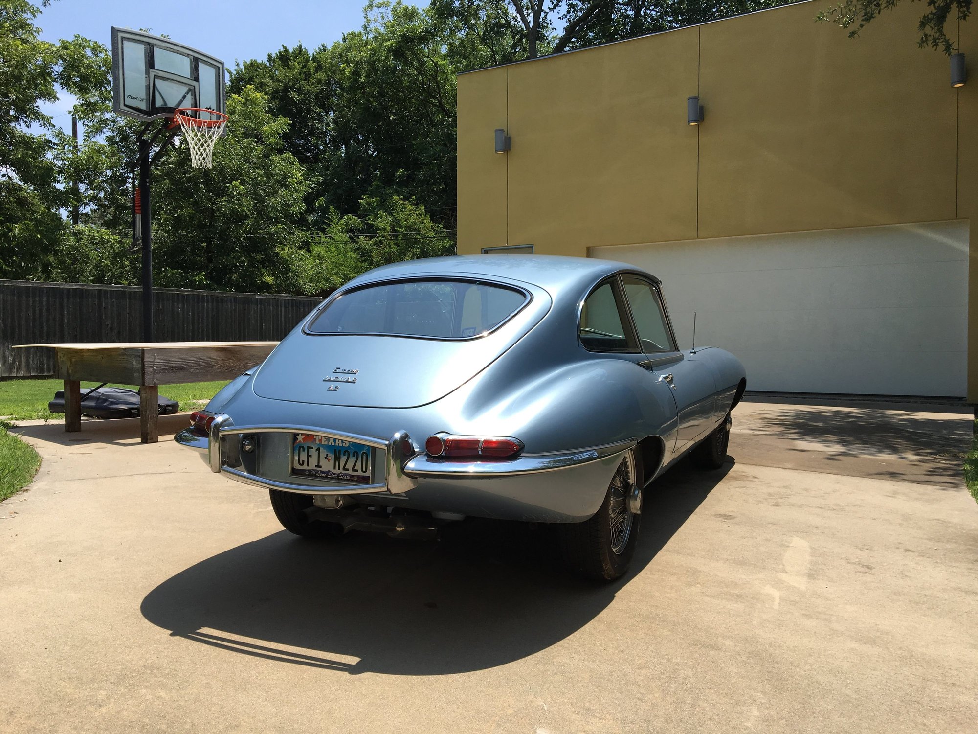

I inherited a 1967 E-Type from my dad about 7 years ago (90,000 miles on it). Sadly, most of the miles I have put on are between my house and the nearest mechanic (that I like) 30 miles away. Over the years I have spent about $12k on brakes, rear seal and new clutch, steering column, new tach, etc.
After the last trip to the mechanic (to replace a blown fuse and check into some oil leaks) resulted in a $2,100 bill, I was thinking this might be the last straw (it certainly has been for my wife!).
Then the mechanic tells me he is hearing some disturbing noises from the transmission (could be one of several worn parts). Honestly, I have been hearing some whining at red lights and I can hear the "rumbling" that he describes (but is whining a transmission issue if the transmission is in neutral?). It's a 4 speed standard.

Thanks bkeats and gtjoey. I knew he'd have to take the engine/transmission out of the car and I like this guy and it takes a month to even get your car an appointment so he's obviously not charging as much as he could.
If it wasn't costing $10/mile to operate, I am actually the type of guy who'd keep the car and enjoy it. Here in Dallas, its hard to drive it for 5 months of the year because it doesn't really like 90+ deg temps.

Pretty 2+2 and there lies the problem. Great looking condition, a dry mid west cat but a 2+2 which I LIKE but value has been going south.

Hey there Dallas. nice looking car, I have a 68 2+2 so very similar vehicles. These are cars that need constant attention to be reliable drivers. If you do not like wrenching/tinkering/fixing things on your own then they can become expensive toys. Lucky for you yours aged in a dry part of the world and avoided road salt and humidity. That would have led to a full replacement of tinwormed metal. Check Hagerty classic car values before you bail out, solid 2+2s are actually increasing in value again. (mostly from demand in Europe)
Thanks GTJOEY and alfred. My mechanic (who has a 1967 two seater) was telling me values were increasing. It'll be hard to sell as it's the closest thing I have found to a time machine. Interestingly, it isn't the lovely long hood or sweet sound of the engine that I appreciate the most but the smell in the cockpit.... I cannot describe it, but it immediately takes me back to my Uncle's 1967 Eldorado and best high school friend's 1974 Ford Maverick.
