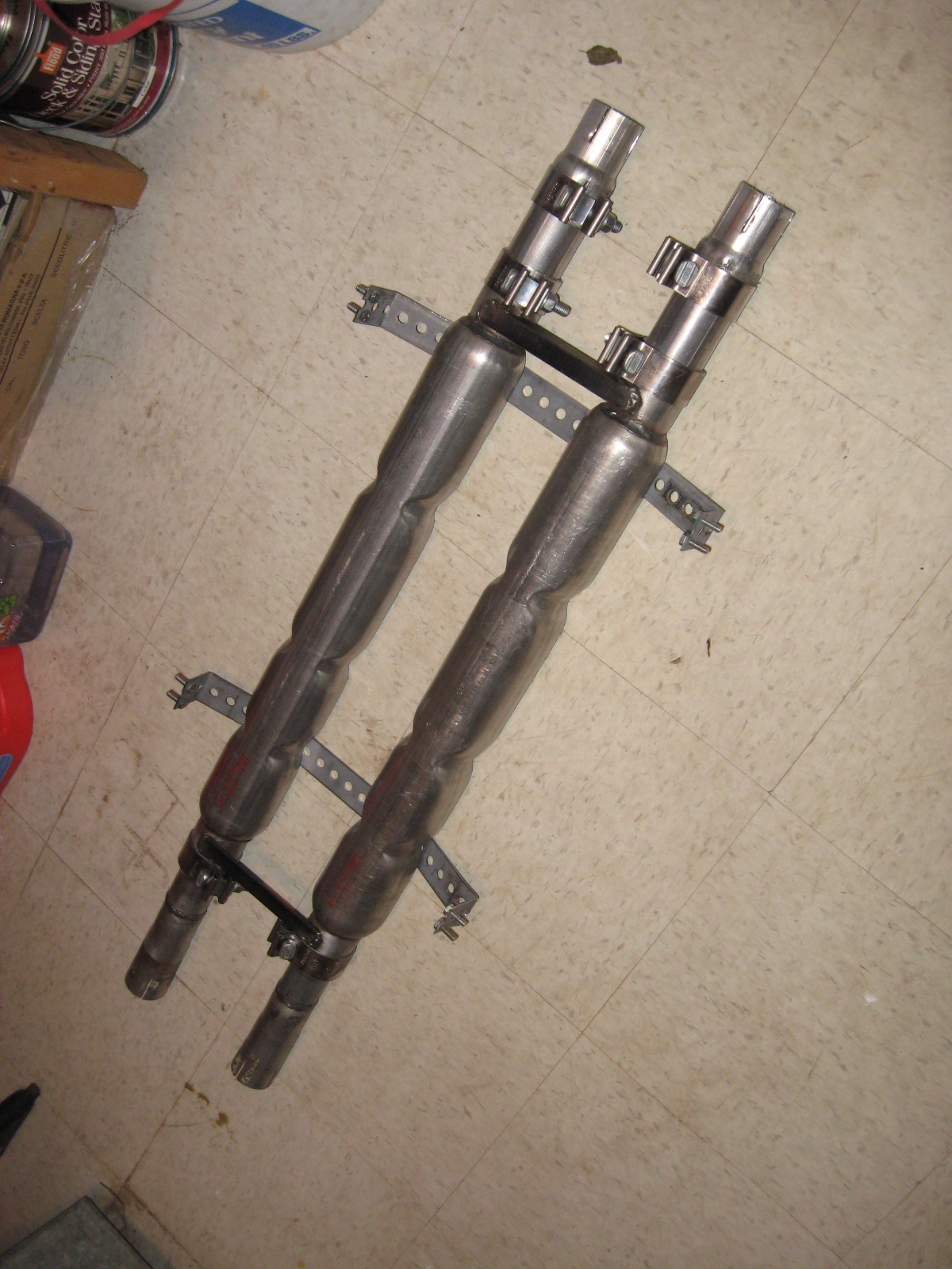

Hi,
I'll offer, I run a Pertronix sparkie in my rebuilt re-curved otherwise stock LUCAS distributor. I run a set of ceramic coated headers, custom muffs (pic) and K&N cleaners. Also added, a Mallory CD box. But, one of the best changes was swapping out the UM (stock) needles for EOs(?, I think that's the correct nomenclature). However, I am running SUs as you can see. All of these mods work together nicely for a good running engine.
Attached Thumbnails 1969 E-Type - Update to Drivers Car-jag-muffs.jpg   1969 E-Type - Update to Drivers Car-evac-setup.jpg

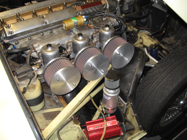

Ken,
Where did you get the air filter setup? Very nice pipes btw...

They were purchased from Classic Jaguar of Texas. I fab'd the evac system to replace the factory version lost in the change.

Hi,
The Pertronix sparkie is an "easy-peasy" drop in. Just remove the rotor, add the magnetic insert, adjust gap, connect a few wires and off you go. This replaces the points and smooths out the idle. To increase the HT (high tension) spark, I added a hotter coil and the CD box, These two items insure a full-proof ignition that will not breakdown during WOT. All else being in good working order, the engine will darn near fire under water. I gap my plugs at .040-.045. LOL!
As mentioned previously, I run a LUCAS sports gold coil with a Mallory CD box. Once fuel reaches the carbs the engine will fire with a vengeance.
In this pic, you'll see the LUCAS coil and the red Mallory CD box. This was taken before I added the evac kit.
