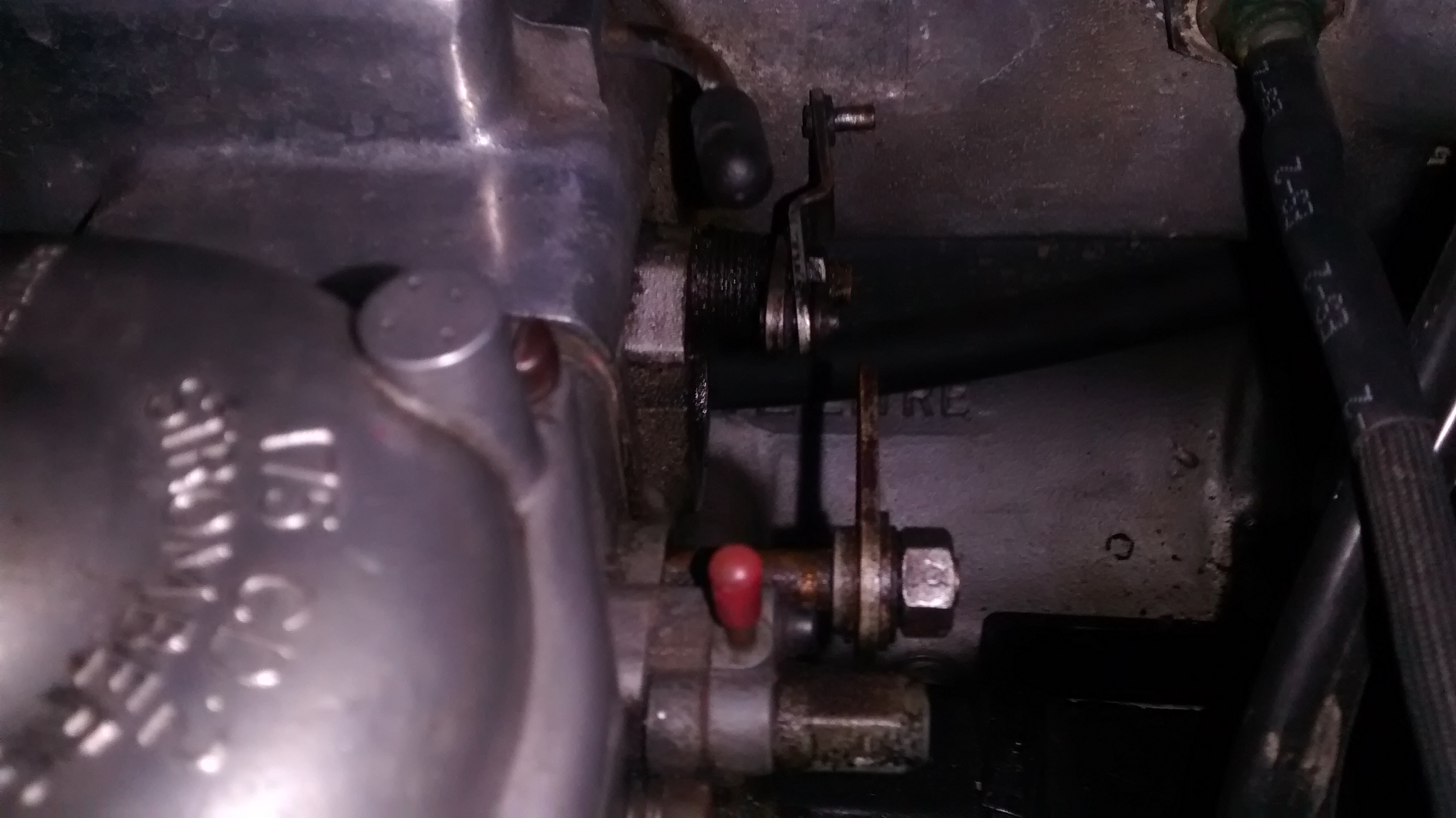

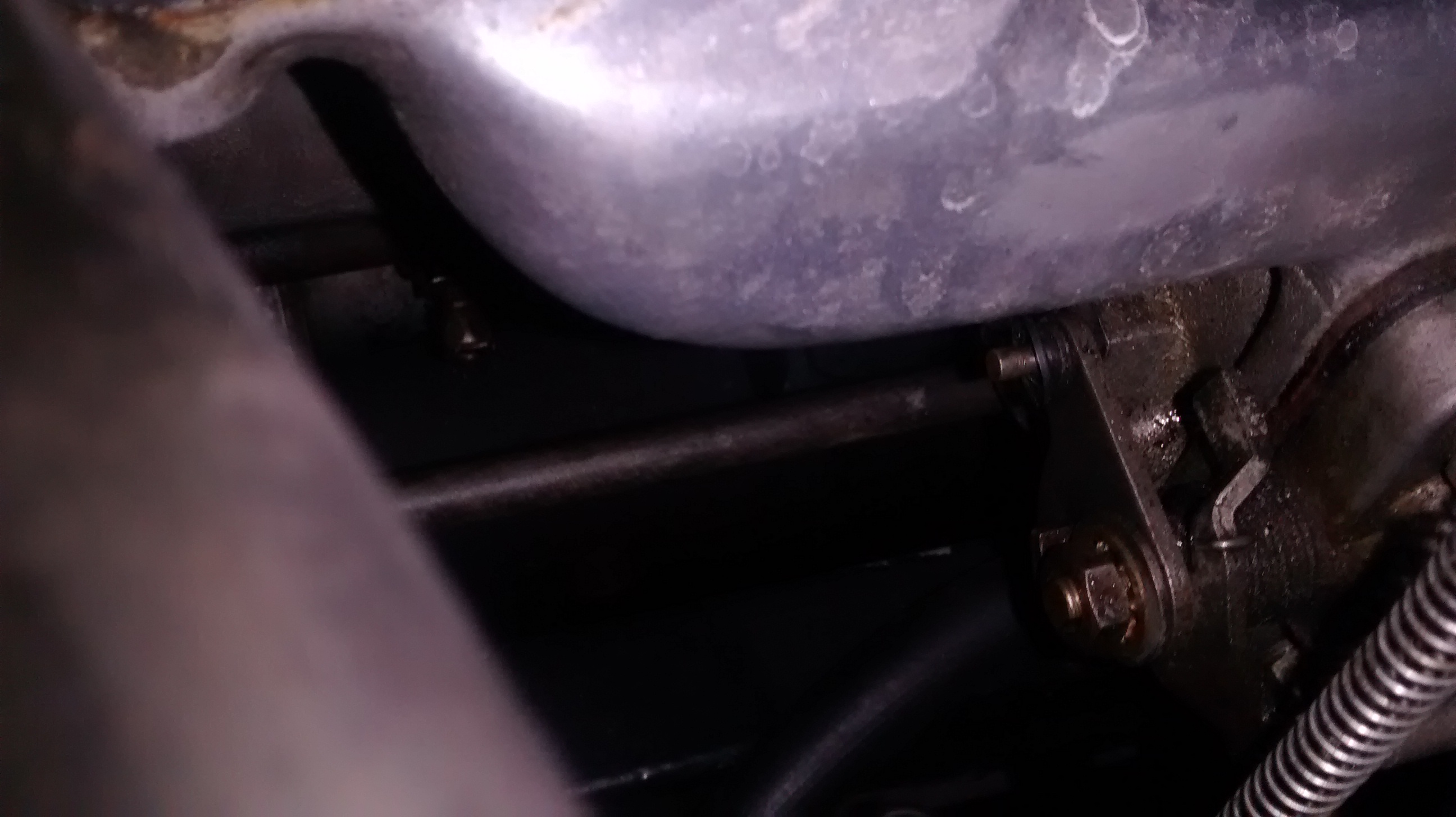

I went into my shop and took a couple pics of the mod. The first pic is from the back of the rear carb linkage, the second is at the front of the forward carb. You want to remove the link and jam it (it is under spring pressure) below the aluminum water jacket.

Thank you all for the advice. The Crespin mod worked great.

Just one last thing - If you have removed the round valve plates in the manifold themselves be careful when "jamming" the 2ndairy spindles. I have seen them coming undone allowing horizontal movement of the shafts. This allows air to be sucked in through the gaps. Or worse - they vibrate out and you loose them on the road! Best solution is as Edward suggest (remove spindles & seal the gaps), but at a minimum use something (tie wrap will do) so movement is restricted.

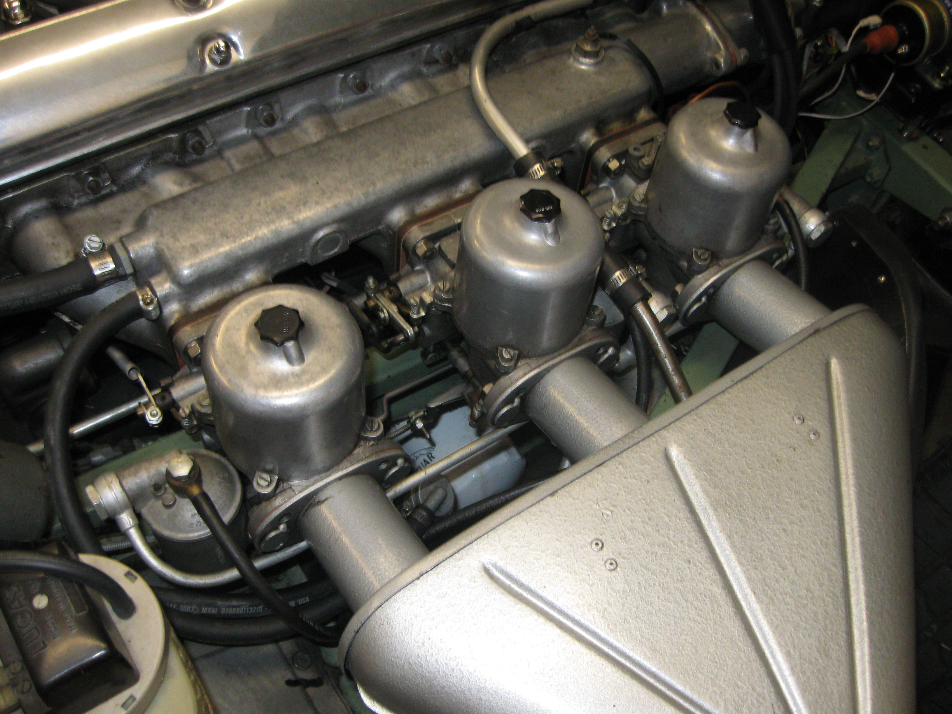

Well first off , congrats to making the decision to triples, you have now added testosterone to your ETYPE!
I might be biased and would be hard pressed to see anyone else on the site that has driven more than me in the last 20 years in their etype....
A 1970 etype coupe ,please look below, do I have to say anything else!
GTJOEY1314
Drive on my friend, drive on!
Attached Thumbnails carb conversion-img_1067.jpg   carb conversion-img_1070.jpg   carb conversion-img_1071.jpg
