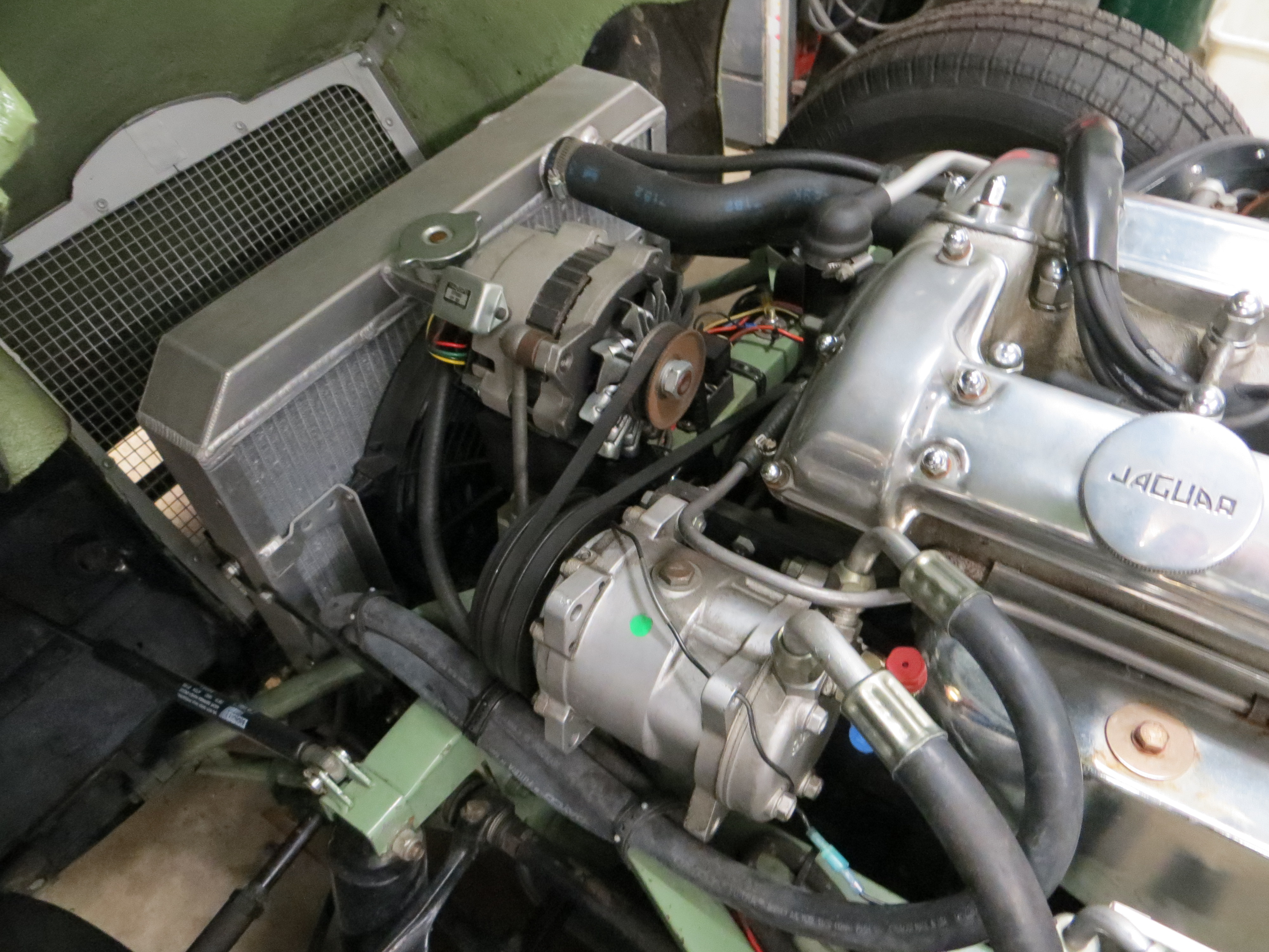

Yeah I did the one wire in '96. Got tired of rebuilding the Lucas crap alternator.
Have made a few other mods, as well......

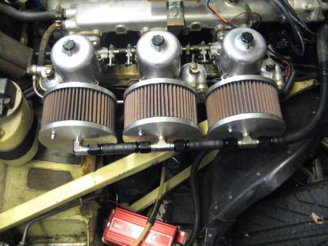

Attached Thumbnails Dumbest block leak ever-img_2439.jpg   Dumbest block leak ever-img_0718.jpg   Dumbest block leak ever-jag-muffs-1.jpg

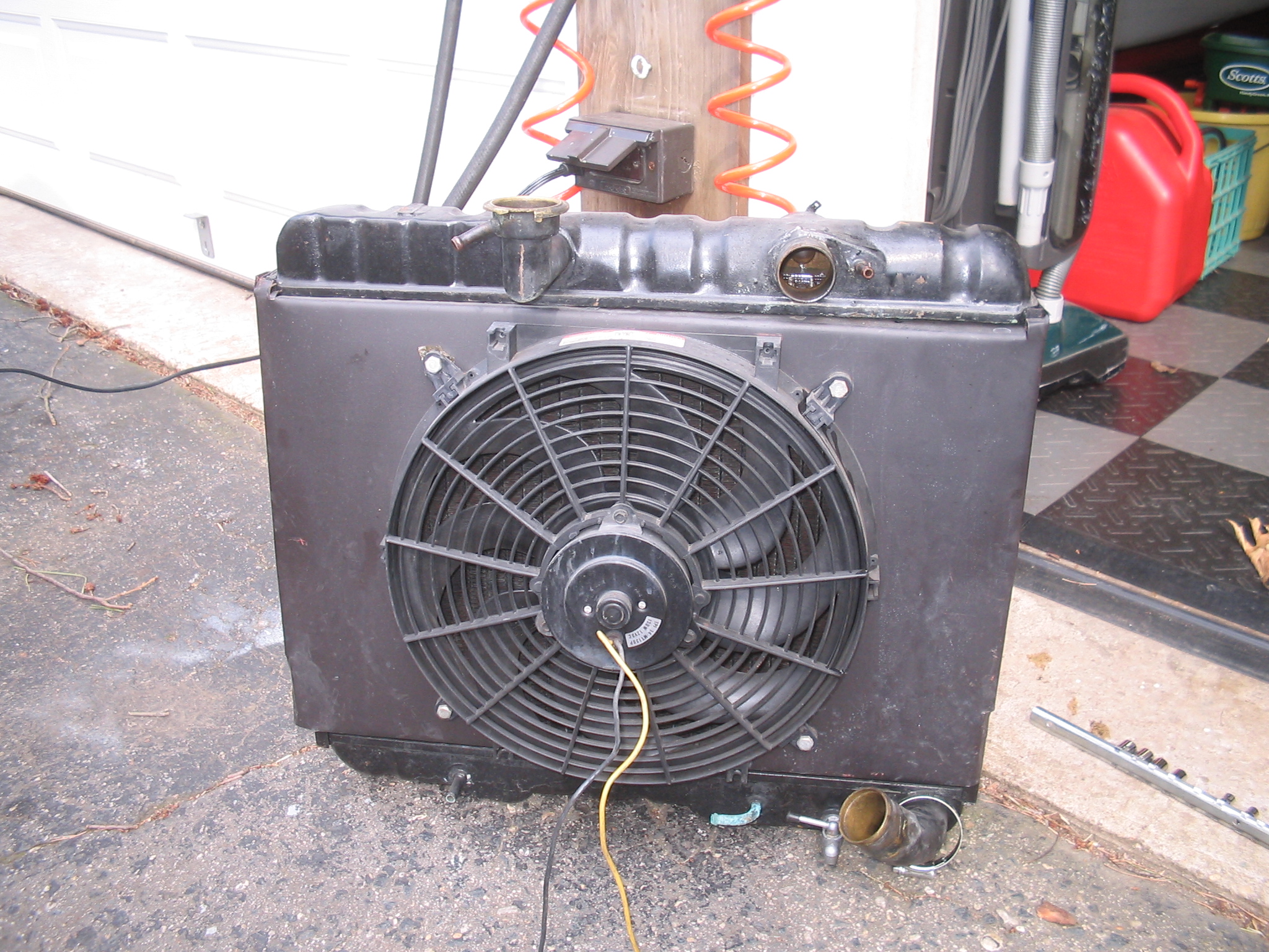

Red, YOU GET IT!, Nice usable mods. The radiator I went full out aluminum . Love your air cleaner set up as well. I went early stock look but put a larger return pipe for better breathing like you did!
Sorry gents anyone with the twin strombergs is not a real Etype.
God bless you for keeping them but a 1982 YUGO has more pull......
Lets see if I could post some pics...

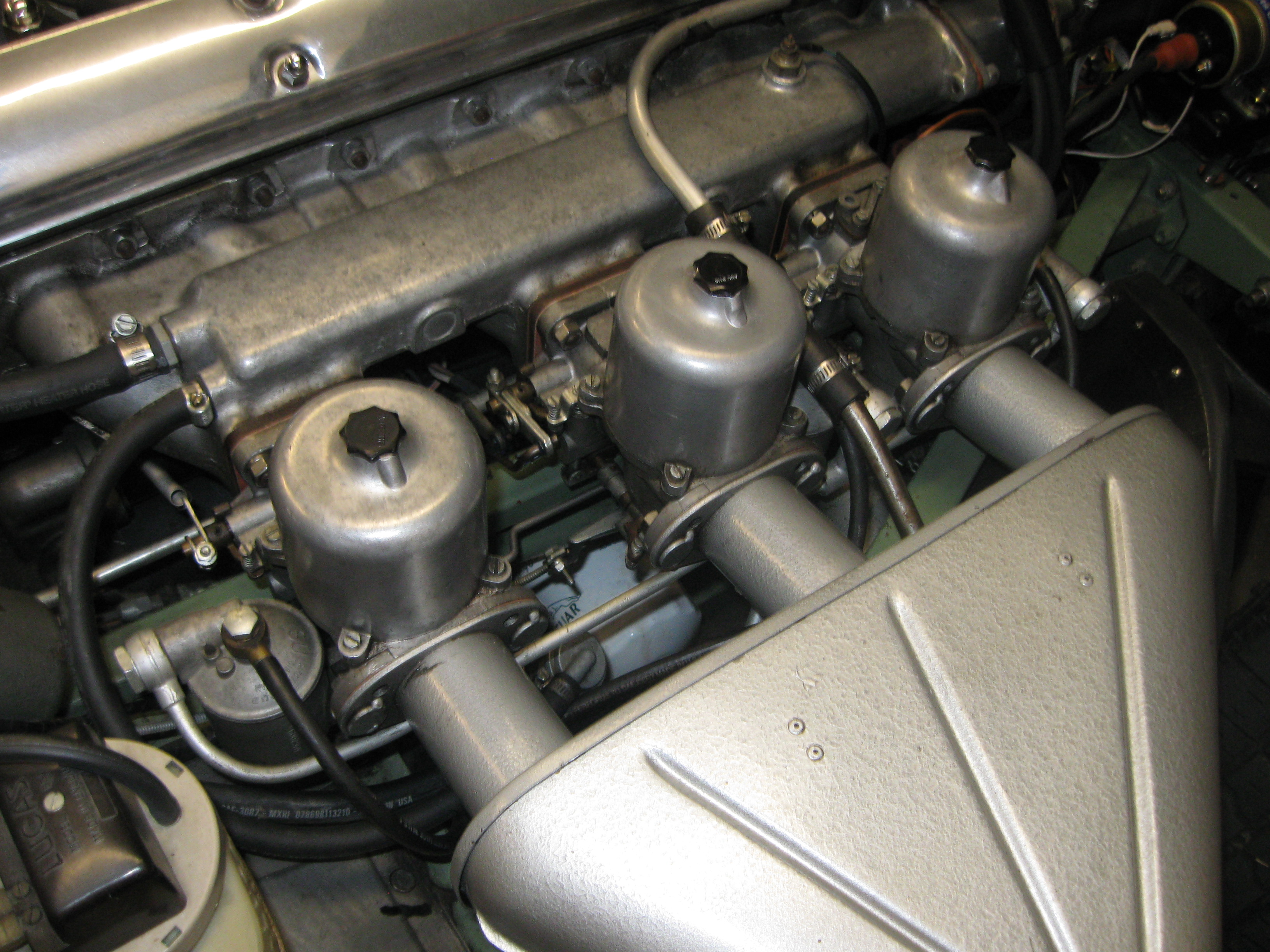

Remember mine was a 1970 coupe, now triple su's, polished covers, xj6 series 3 ignition, covered german headlights , and sooooo much more .

Yes, I too went with an all aluminum RON Davis rad. Works like a champ!
