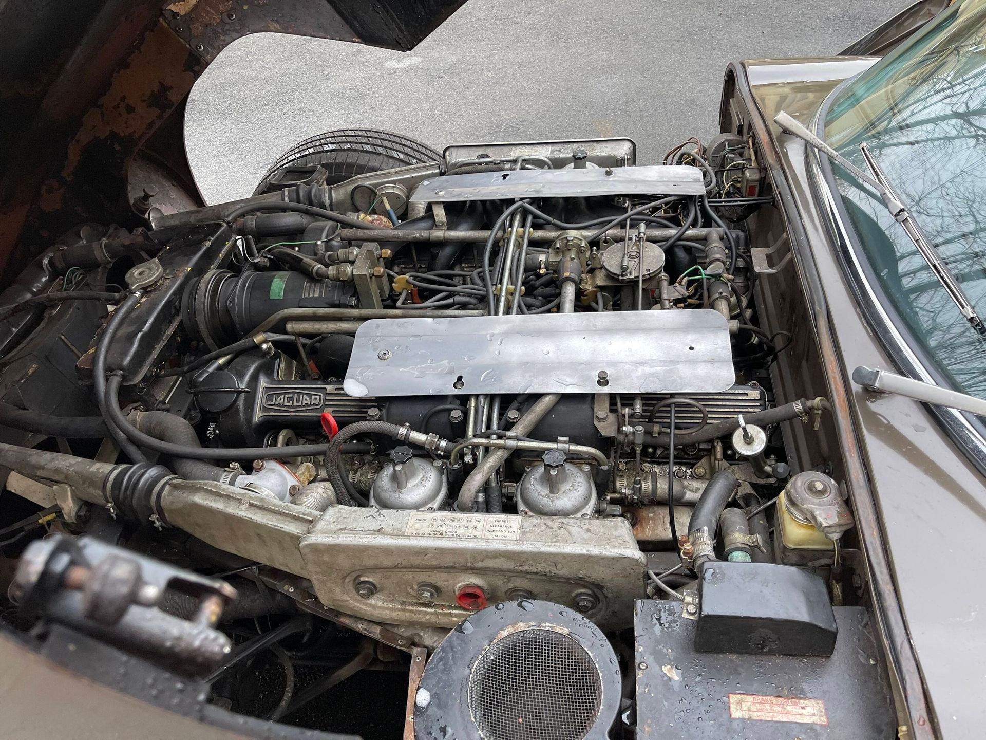

I recently purchased at an online auction a 1973 Jaguar XKE Series 3, 2+2. I got a very good price for it however the car had sat in a climate-controlled warehouse for 32 years. It's in a shop right now undergoing a mechanical makeover. I have been told and read on a couple of forums that I need to go with electronic ignition unless I want to walk. What is a good brand? The car has a little over 23,000 miles.

After looking at your pictures again, I see you have the V-12 engine..... My recommendation were for for 4.2 6-cylinder... I used this setup on my 1968 XKE and was very satisfied...
The V-12 experts will have to step-in on what Distributor Upgrades are available and reliable.

The original V12 Lucas OPUS ignition is electronic but unfortunately they aren't very heat resistant and the middle of the engine "V" mounting location is probably the worst place Jaguar could have picked for the electronic amplifier (which is the part that tends to fail). They'll usually give you some warning when they're about to die so you shouldn't get stranded. If the engine won't fire at all (as opposed to being hard to start or stumbling) on hot restarts that's a clear sign the amplifier is on it's way out. Usually if you let the engine cool down you can get going again but you'll need to address the problem right away as it doesn't take long after for the amplifier to completely fail.
One fix is to install a later version of the V12 distributor, coil and amplifier that is more heat resistant. I believe Terry's Jaguar and SNG Barratt, amongst others, sell those kits. They're not cheap but it works and looks stock, if you care about that (I do). There may be other options out there as well. In the meantime don't be afraid to drive your new toy. While they do fail, the stock ignition is not as horribly unreliable as some might have you believe.
