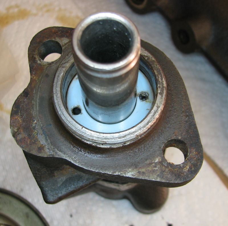

to removing the internals of the brake master cylinder? I've removed the snap ring but cannot get the piston and bearing/seal carrier to come out (10878 in the diagram). I've tried gripping the piston in soft jaws and yanking on the cylinder body to no avail. I don't see any other impediment to removal when I study the exploded views and cross-section in the shop manual.
The light blue bearing has two holes in it, and I can rotate it (although not easily) but it won't budge axially. I've searched in vain for some non-obvious pin I need to remove.
Suggestions?

Hello Ken ... from Ken ... and with greetings from down under;
I too, am ready to give up ... nothing I do allows me to zoom on your attached thumbnails. So, despite trying to recall the many times I have dismantled these in years long past ... the following is strictly from memory. Like you, my initial focus on those two annular holes had me fabricating ways of "unscrewing it" out of the bore ... in the end, I made up a special tool and invested hours before giving up in disgust.
Firstly, you have removed the internal snap ring from its internal groove. Then, that leaves the blue part you call a bearing ... which is actually the part to the extreme left of your parts diagram (and which I cannot read ... grrr). Theoretically, once freed from the restraint of the snap ring, this should now pop out ... but never does as bore wear and corrosion impedes it. Your efforts to rotate and gain a millimetre or two in fore-and-aft travel do help break the corrosion seal.
Hardly a secret, but cap and seal the spare pressure outlet and use compressed air on a rubber tipped nozzle (good seal) in the other outlet to pop it out. Take care as, once freed up and over the wear "ridge", all the internals will follow ... difficult to work out how to re-assemble if you just cannon-shot them across the workshop (ask me how I know ... but you only do it once). You may find that wiggling that central piston rod will help.
By way of answering the question you have not yet had the chance to ask ... No, don't just renew seals and ignore the cylinder bore and that "wear ridge". Hopefully, there is so little wear and corrosion that a simple hone will smooth and restore everything to pristine condition. (Yeah, and that jolly red man at Xmas really does live at the North Pole). Let's cross that bridge when you get to it.
Hope this helps, and please keep us posted on your progress.

Well, I got it apart by locking the piston in a set of plastic jaws in my big vise, resting a piece of 4x4 on the flange of the body and giving it a good whack with a 3 lb dead-blow hammer. Worked on the second try.

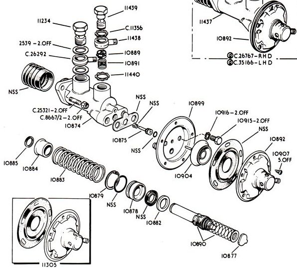

Oddly enough, parts 10878 and 10882 were installed in reverse order compared with the exploded view in the parts manual. The lip seal was installed in the proper direction to seal. The back of the lip seal had a light coat of RTV on it. Something the factory did in 1974, or has someone been into my master cylinder sometime in the last 40 years? The car only has about 10,000 miles on it.
I'll clean and examine the bores tomorrow, but a quick look suggests that they are OK (fingers crossed).

Wow ... Very surprised it took that much effort to extract. Something really amiss there... and you point to reversed order of parts on dis-assembly, so I would suggest that someone has definitely been there before you. The assembly line simply did not make those sort of mistakes.

I found rust in the barrel has a lot to do with the blue nylon thingy being reluctant. Yes, compressed air together with a SS sleeve insert can be your friend.
A third Ken chiming in....
Fortunately the long small bore where the moving parts are was in quite good shape. I honed it and the area where the blue part is. There was a little rust track where the o-ring seal is, but it cleaned up well. When I reassemble the parts in proper order, the o-ring will be in a new position anyway, so I think I'm good.

I've dismantled many that have been stuck by blanking off the appropriate holes and using a grease gun attached via an adapter. Its similar to using compressed air, but I with more feel and control. It works every time.

If I recall correctly the parts manual shows the seals in reverse (not correct) This subject has come up on another forum. I have not had good results in rebuilding these cylinders, even when having them re-sleeved. I prefer new parts for masters, but the new reaction valves are iffy .
