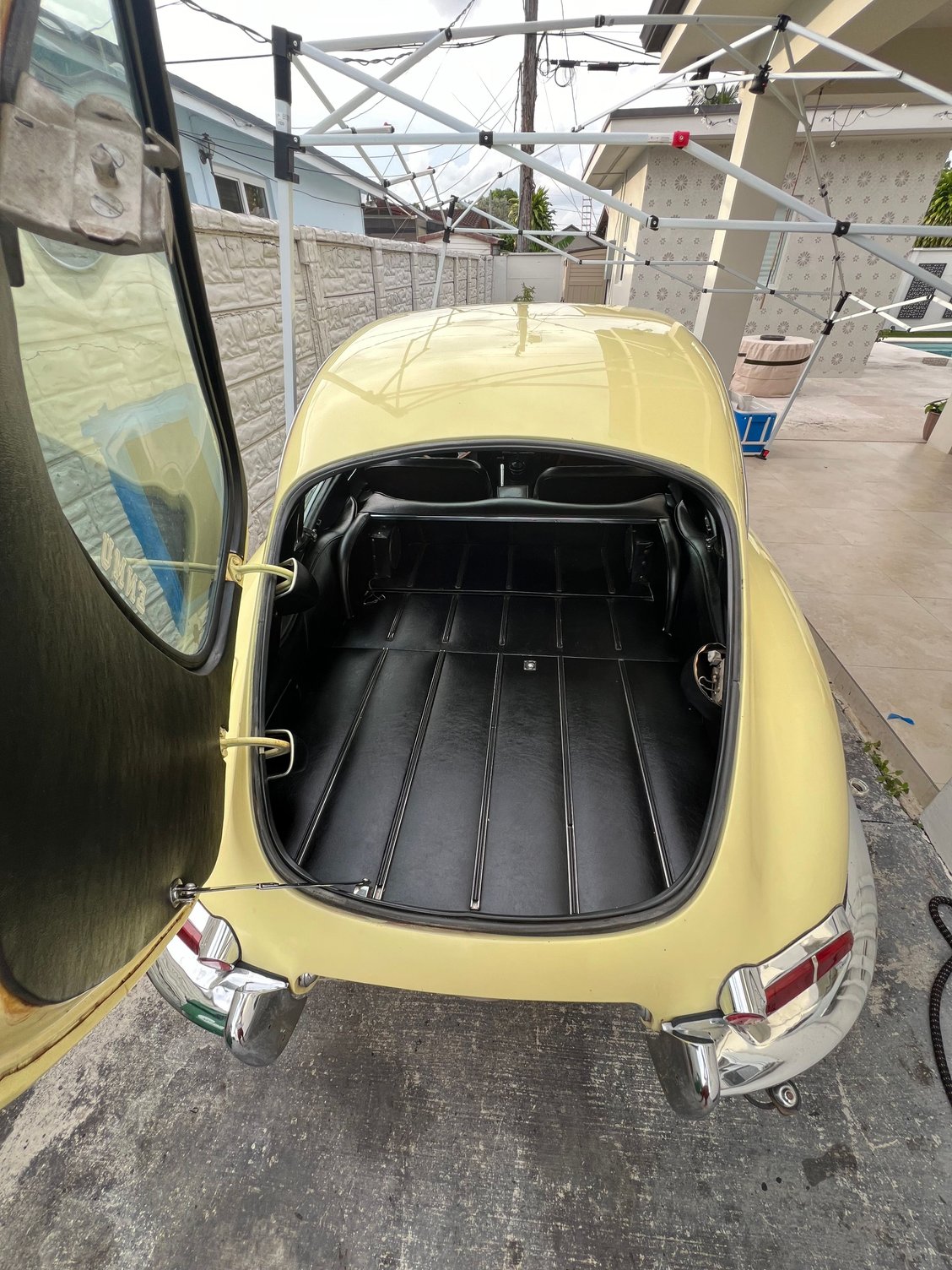

Update
new tires with tubes are installed, new gaskets are getting installed and the radiator and front breaks are scheduled for Sunday. Yet I have a question the car only has 2 carburetor by what I’m reading it’s supposed to have 3 or I am missing something? See photos
2 Zenith carburetors
Is this door supposed to be there?

thank you for the update Jorge and you are moving right along! With a 67, you may have the locking glove compartment.. see this car:
https://www.hemmings.com/listing/196...4#&gid=1&pid=3
this one has the open style:
https://www.hemmings.com/classifieds...#&gid=1&pid=35
Your gas tank has the earlier 'in the tank' fuel pump, while later (I'm referencing mine, a 69) has the fuel pump in the right rear quarter panel.

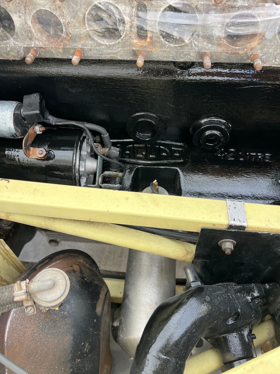

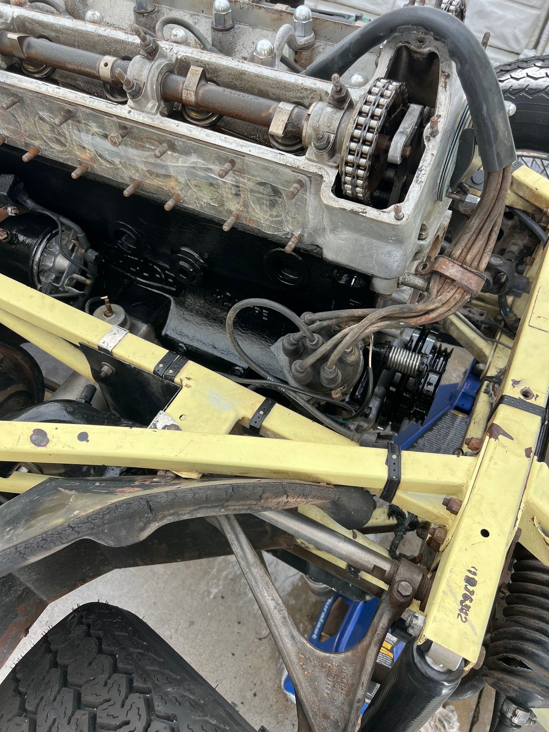

I haven’t been able to ask for the Heritage certificate yet
im confused the nameplate numbers matches with engine and body see photos

Your numbers do match the ID Plate from which I can't tell a year of manufacture, but the engine with twin Stromberg-Zenith carbs, a crossover and finned valve covers indicates Series 1.5 (1968) or Series 2 (1969-1970). There are always exceptions, especially with British cars, but it sure seems to be later than 1967.

The glovebox door says Series 1.5 or 2, but the center gauge and switch panel say series 1. As previously mentioned the carbs, intake, cross over plenum, and finned cam covers point to Series 1.5 or 2.

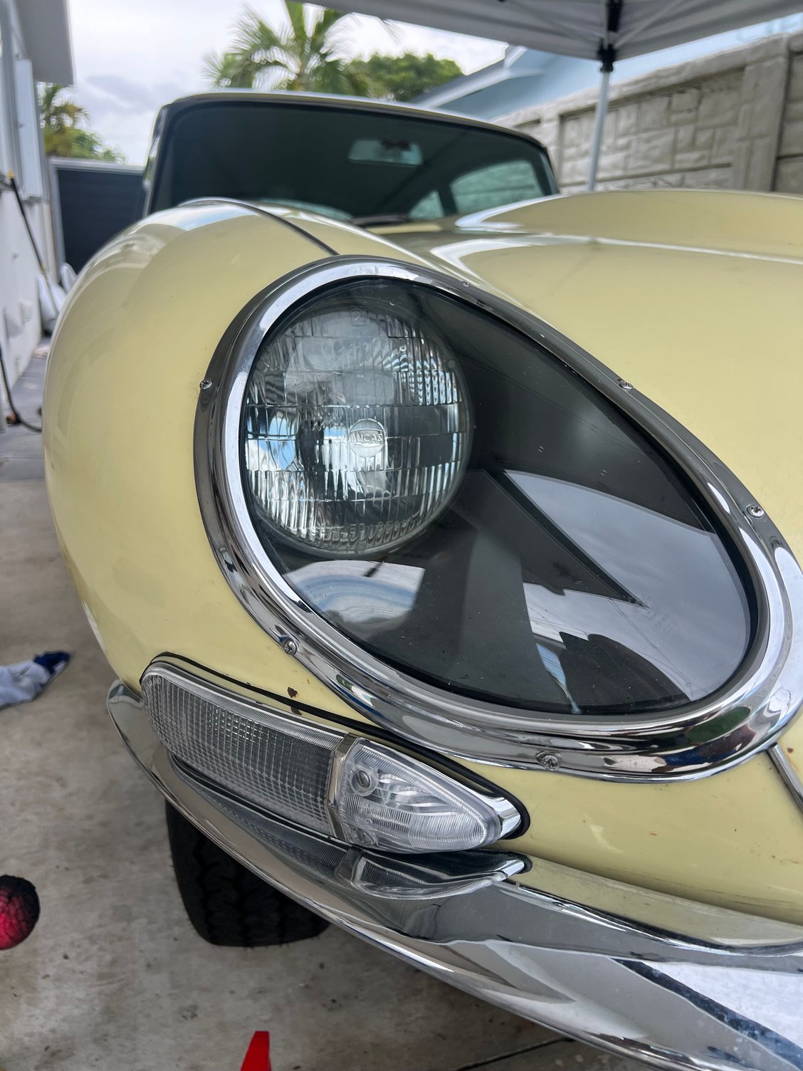

The covered headlights are series 1. If the front seats recline again that points to series 1.5 or 2. If the seats don't recline that points to series 1. I suggest you check the engine block serial number that is stamped on a flat spot just above the oil filter. All the inconsistencies could have been created at the factory, or by a previous owner just trying to keep the car on the road. The heritage certificate will clear up a lot of the questions.

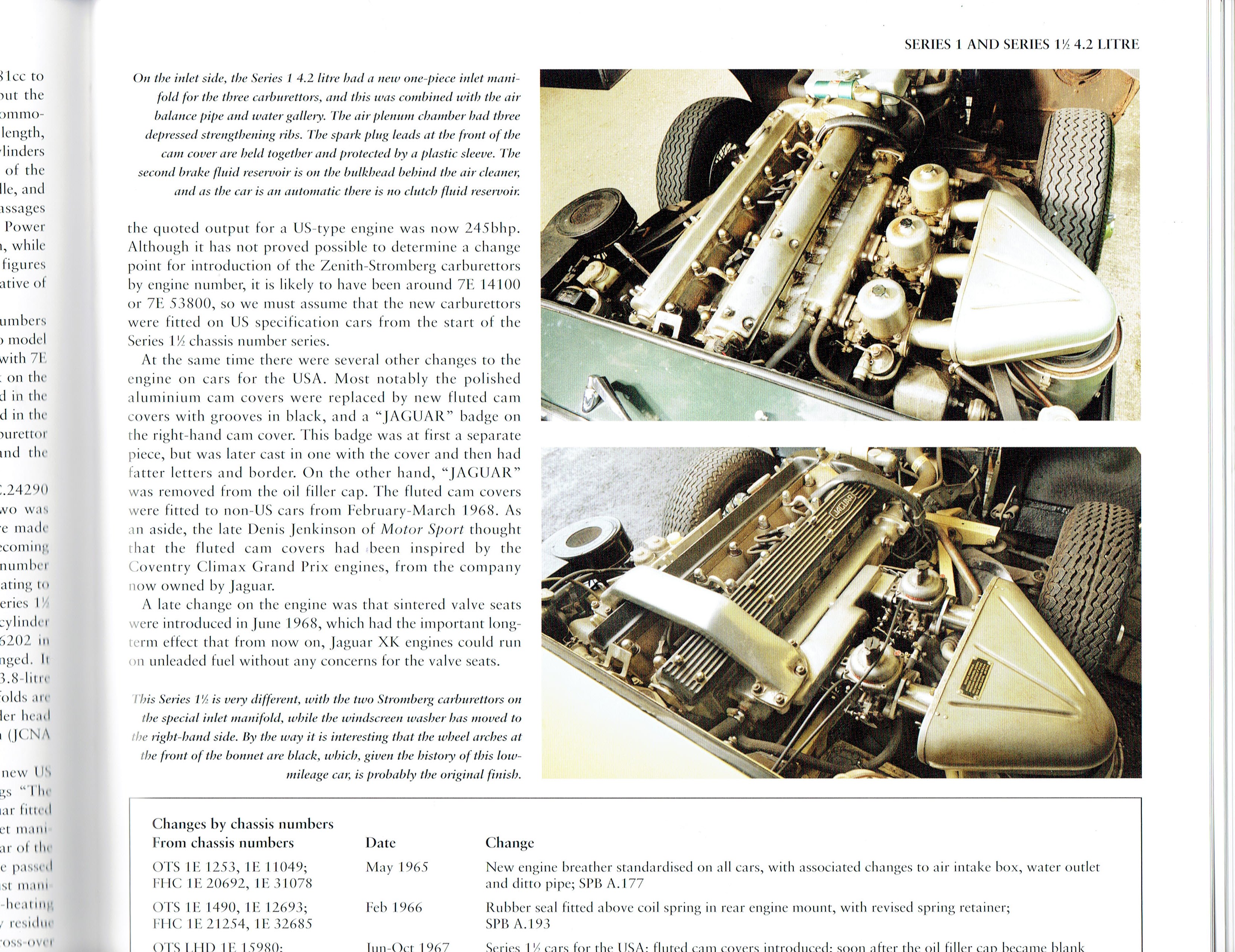

By all appearances, the front of the car, the round Jaguar motif, covered headlights indicate the car is a 1966 or 1967.
On page 57 of "Factory Original Jaguar E type" by Anders Clausager, the former Jaguar archivist, your car number for 2+2 LHD car, falls between 1966 and 1967, meaning it could have been built late 1966, perhaps early 1967 and is likely a series 1.5. This 'series 1.5' is not a formal indication from Jaguar, rather something that owners and E afficionados have 'made up' to indicate a car that has many of the true Series 1 attributes, with some of the Series 2 features. Jaguar was a relatively small company and often when working on a car they pulled parts from whatever bin they needed it. Also, sometimes a car was coming down the production line, only to have something happen, be removed from the line temporarily, then sorted and returned to the production line, but as a result, parts that are generally found on later cars are now put on this car. Perhaps on the day this car was built, they put one of the 'newer' engines in it.
Here is a link to the book, several UK sellers, but a US for about $31.
https://www.abebooks.com/book-search...06133368/used/
on page 59, there are two photos showing what looks to be your engine on the lower photo. This time frame was very transitional for Es, as the factory was moving away from the Series 1s and on to the Series 2s. However, they may have had leftover parts here and there and put them on cars as they saw fit and/or started using parts that were for the Series 2s.
I really like the Clausager book and there are others equally well-done and informative. The Heritage certificate will certainly help you understand your car!

Something doesn't seem right. I don't believe that Jaguar ever produced a closed headlamp car with twin Stromberg carbs.
I am restoring a mid '67 and took the judge's test a couple years ago. I have done a lot of research and have had numerous conversations with the head JCNA judge on the crossover between S1 and S2 cars.
The first major change to the 4.2 Liter S1 car was the opening of the headlamps. They also added flashers and a few other minor things. Everything else stayed pretty much the same. It retained the toggle switches, eared knock offs, triple carbs, round motif, small mouth, etc. Some have dubbed it the S1.25. According to JCNA documentation this is still technically a Series 1. That's the car I have.
The so called Series 1.5 was produced as a 1968 starting in late 1967. It's still judged as a Series 1. It has the small mouth, round motif, indicators above the bumpers, etc. But, it has open headlamps with the small eye brow, rocker switches, twin Stromberg carbs, hexagonal knock offs and a few other "safety" and emissions changes.
The S2 was produced as a 1969, beginning in late 1968. Among other things, it kept the twin Strombergs, the much bigger indicators/tail lights and front indicators went under the bumpers, the eyebrows got bigger, the mouth got bigger and the motif changed to an oval.
That's the progression as I understand it. From what I see, at no time was a closed headlamp car produced with twin carbs. According to your vin tag the engine and body are both correct. Is it possible that your bonnet was replaced with an earlier version?

OCDH... I believe Jorge posted photos of this car on Xkedata... (1E76312) Take a look at the 5th photo under "Engine" and look at the very interesting 'header tank' ! If not done by Jaguar, someone did (IMO) a magnificent job creating this header tank... before true S2s had the former header/now expansion tank mounted on the left firewall. Then, 2+2 Es listed after Jorge's serial number also have the sealed headlights. Serial number 1E76327BW has two Stromberg carburetors.
In past reading, it was noted that sometimes a car would have to be taken off the production line for some reason.. repair/panel damage, etc. then put back on the line. This may explain why this E has an engine that many think it shouldn't have. Looking at 6327BW however, only 15 cars later, it appears to have the Strombergs, but not the ribbed valve covers. In your conversation with judges.. do they see evidence to support this?

Jorge, All your numbers are correct, car was built on 11th July 1966, despatched to dealers (Jaguar Cars New York) on 16th August 1966.
