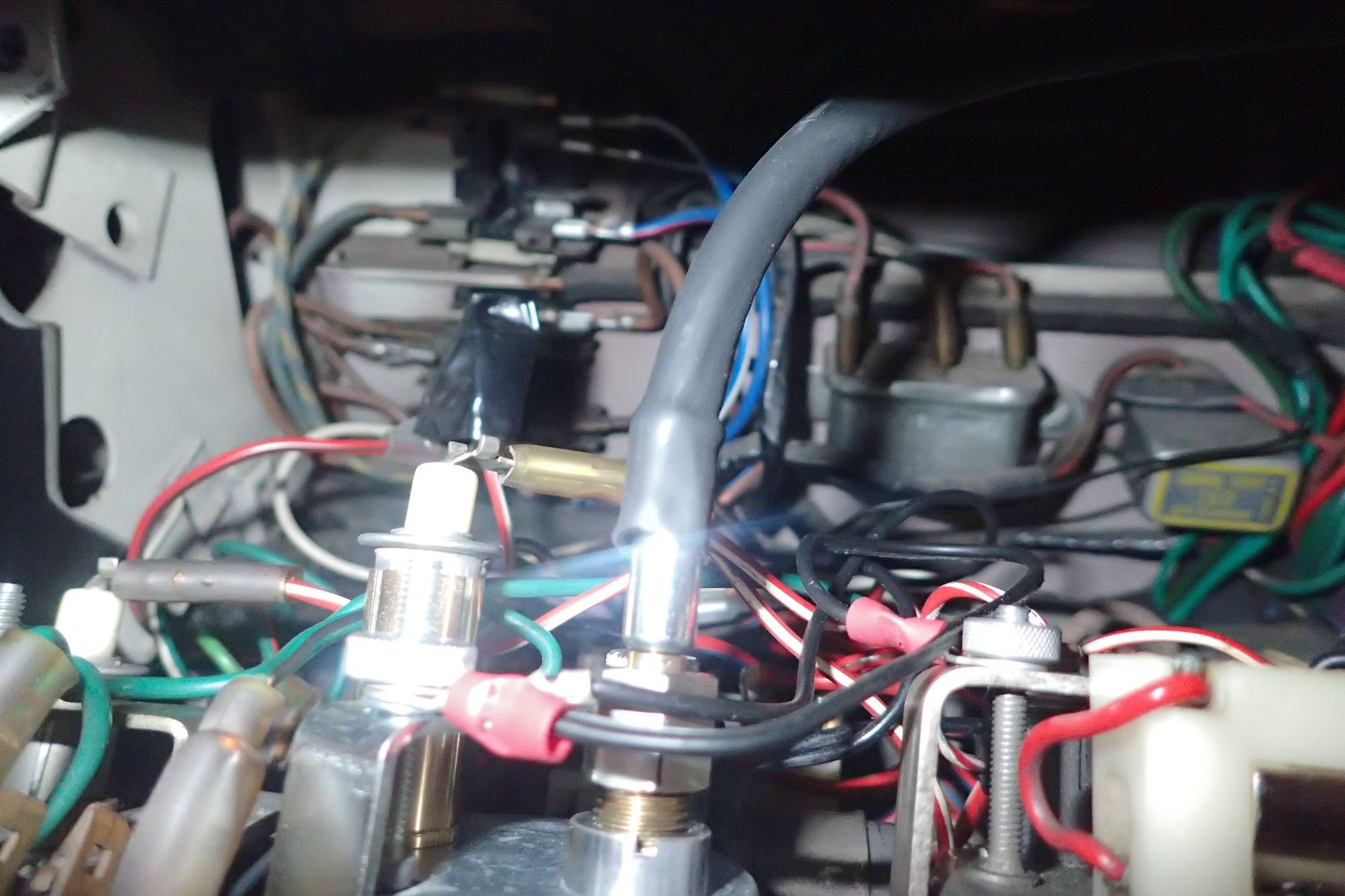

Since I’m relatively new to my E-Type, I’m unsure if my oil gauge always read as it currently does or not and whether it’s “normal.” The gauge slowly raises upon starting the car and at idle (choke at full) registers shy of 60 lb’s. Once warm and driving, the needle maintains close to that position regardless of speed (comes down a tick at a stop light). I did note a day ago that the needle rested at 45 lb’s when I pulled into my garage after an hour drive.
I’m not well versed enough on oil pressure or the E-Type gauge. Thoughts? Normal? Sending unit going bad? Thank you!

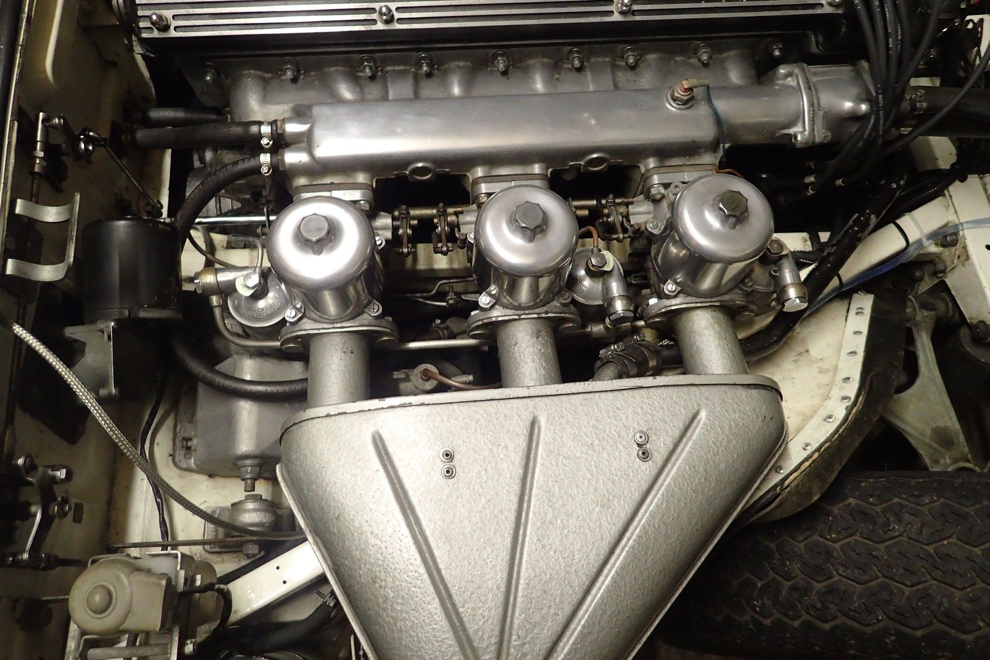

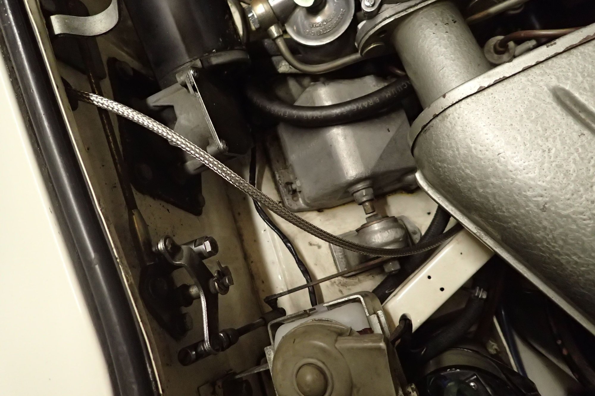

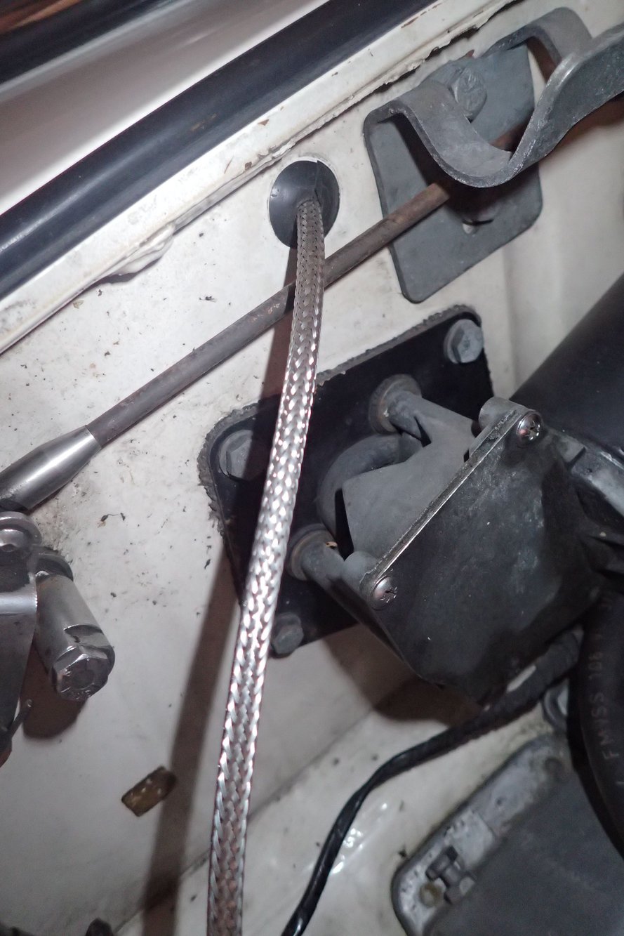

As a follow up, I thought I'd send you a couple of pics of the oil line. The first one shows the metal braided line as it passes through the bulkhead. The nex
t shows the connection to the guage where it is rubber-shrouded. The braided line is unlikely to break I imagine, and the connection to the guage is very sturdy looking

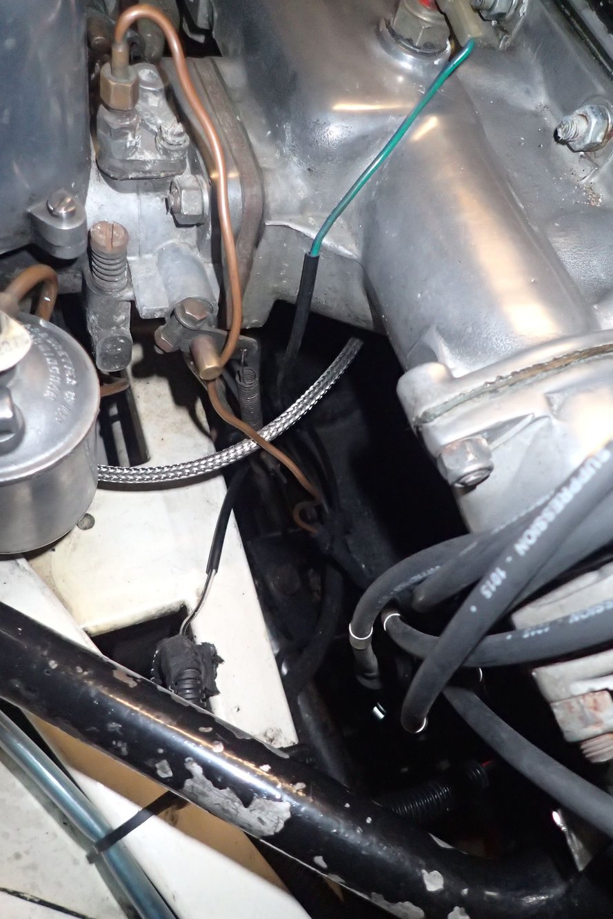

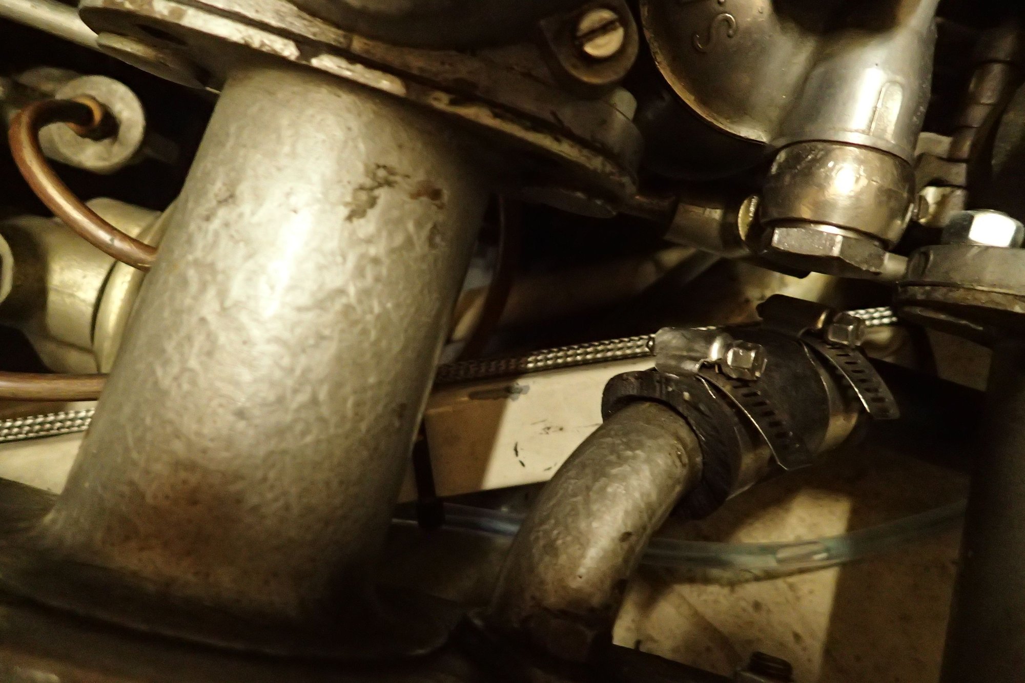

No problem. Pretty straightforward.
From the oil connection, it comes up the block in front of the front carb (photo 1)
It then runs along the frame under the air filter head (couple of cable ties) (photo 2)
It then emerges from under the filter to go through the bulkhead (photo 3)
From above, very little showing apart from the run to the bulkhead (photo 4)
