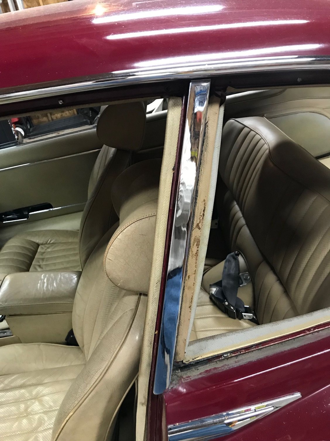

I am getting the car ready for painting. I have most of the chrome out. I removed the back rear swing out windows. There is a chrome piece attached to the B pillar. See Picture. Does anyone know how to remove that?

Maybe look for screws at the side that are normally covered by something else like a door seal or the rear side window hinge. If no joy look at the back of it if you can.

I have a 68 FHC with a similar B pillar. If it is the same (and I really think it is) the chrome piece in the photo is not a chrome cover, it is the B pillar. It has securing screws at the top and bottom that on my car are covered by the rubber seal. The chrome piece should have two tabs that point towards the rear of the car. If I remember correctly there is one screw on the bottom tab and two screws on the top. When I removed the B pillars on my car, there were spacer shims between the top tab and the Unser side of the roof directly under the rain gutter. Make sure you count and mark the shims, and keep them together with the corresponding B pillars.
Hope this helps. Good luck.

Thanks to all that suggested a solution. I was thrown off by the picture in “the usual's” parts list. They show this chrome piece having foots on the top and bottom that screw into something. Now that I have solved the puzzle, I can tell you that the 2+2 is built different and that picture is inaccurate. I am suspecting that is the piece for the FHC.

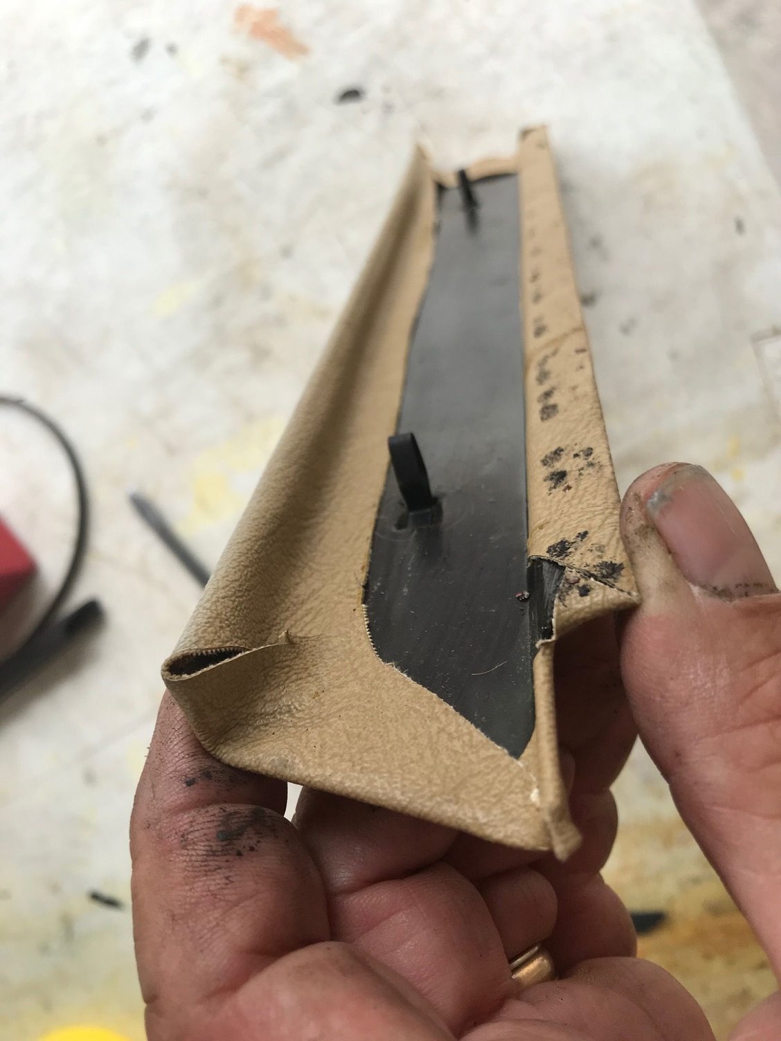

There is a cover on the inside of the B pillar that priors off. It is held on by two metal tabs. Here is what it looks like once removed

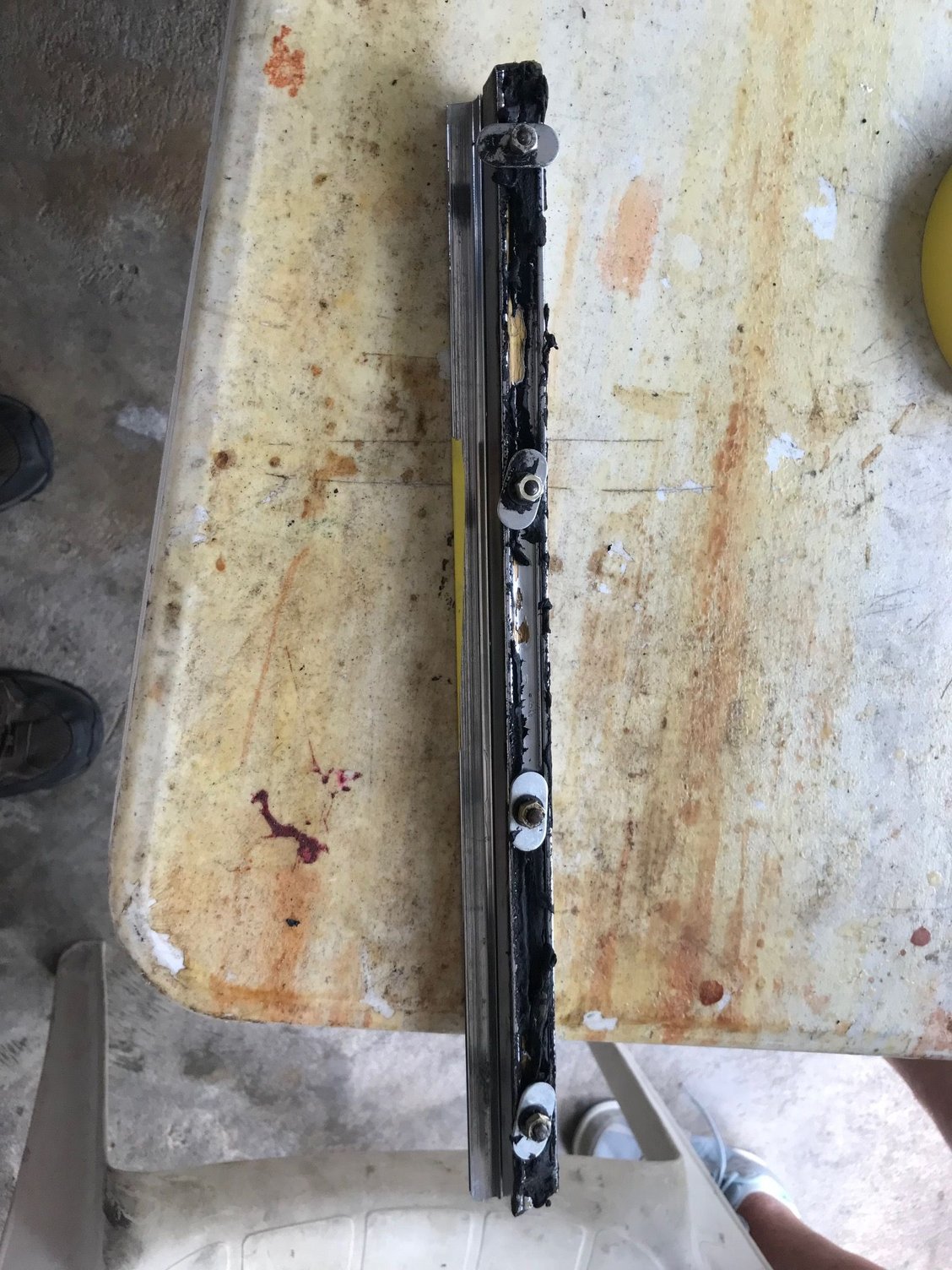

Once that is off you see the structural B pillar that has 4 holes in the back with 5/16” screw holding this piece in place. Some black goop is used for sealing between the chrome piece and the B pillar. This is what the piece looks like once removed. Nothing like the parts picture.
