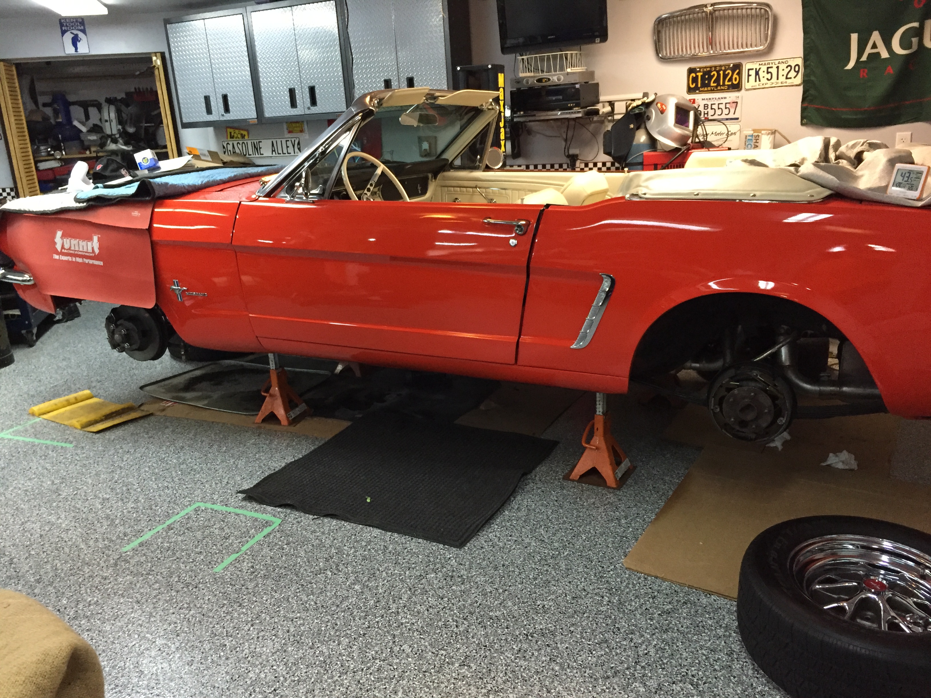

Between '96 and 2003, I did a frame-off resto of a early mustang cvt. I found much the same damage as you found here. Between the MIG, Plasma cutter and weld through primers, and the bare metal primers these days, I'm enjoying the fruits of my labor today. here, I have her in for new shoes and other brake work.
But looming on the side lines is my E-Type 2+2.
keep the work flowing........
