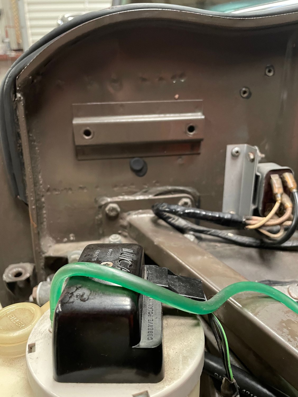

1970 Type II 2+2 Left hand drive. I’ve found this bracket on multiple parts drawings attached to the firewall but no part number and never showing anything attached. Ideas please.

Attachment point for brake gear on RHD cars. Left vacant on LHD cars.

Photos from my Haddock books indicate that brake reservoirs were mounted there. On my 69, the washer reservoir and pump are right next to it. Nothing on the bracket you are asking about, and never was, on this car.

Hmmm, Might be a nice place for me to mount an emergency flash light. 😊
